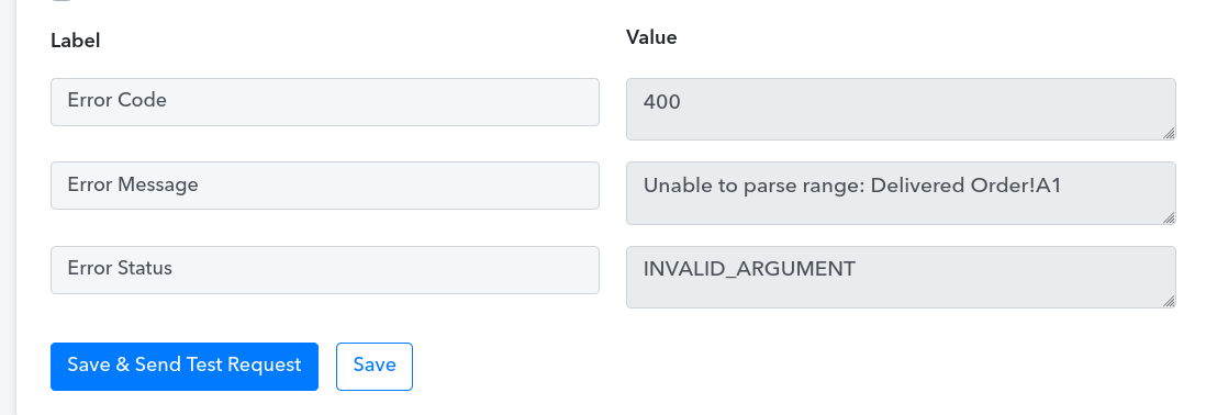

Hi Team, my workflow to update a google sheet was working but for some weird reason, I got an email that says it failed.
When I investigate it I was receiving an error code of 400 which is related to a credential issue. I reconnected to the sheet with new credentials and when I test the workflow, it is updating the google sheet.
But when I went to history to re-run the tasks that failed. Nothing is happening. It is not updating the google sheet. Can someone help me, please?
The below 3 task IDs from Workflow AMZ Delivered Order failed to execute, can someone look into it for me? Thanks.

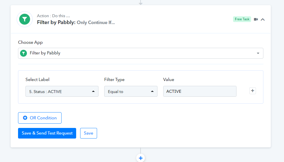

I created a new workflow but the router step is not being executed. Can you tell me why?
The workflow name is Master Sheet Test here is one of the task history ID where the router step is not being executed.
IjE4MTQ4MzUzMSI_3D
Kindly cross-check the filter condition from the workflow and the task history Id whether the Filter action steps condition gets fulfilled or not.

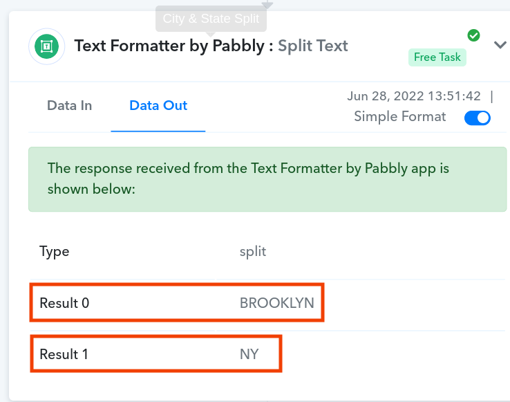

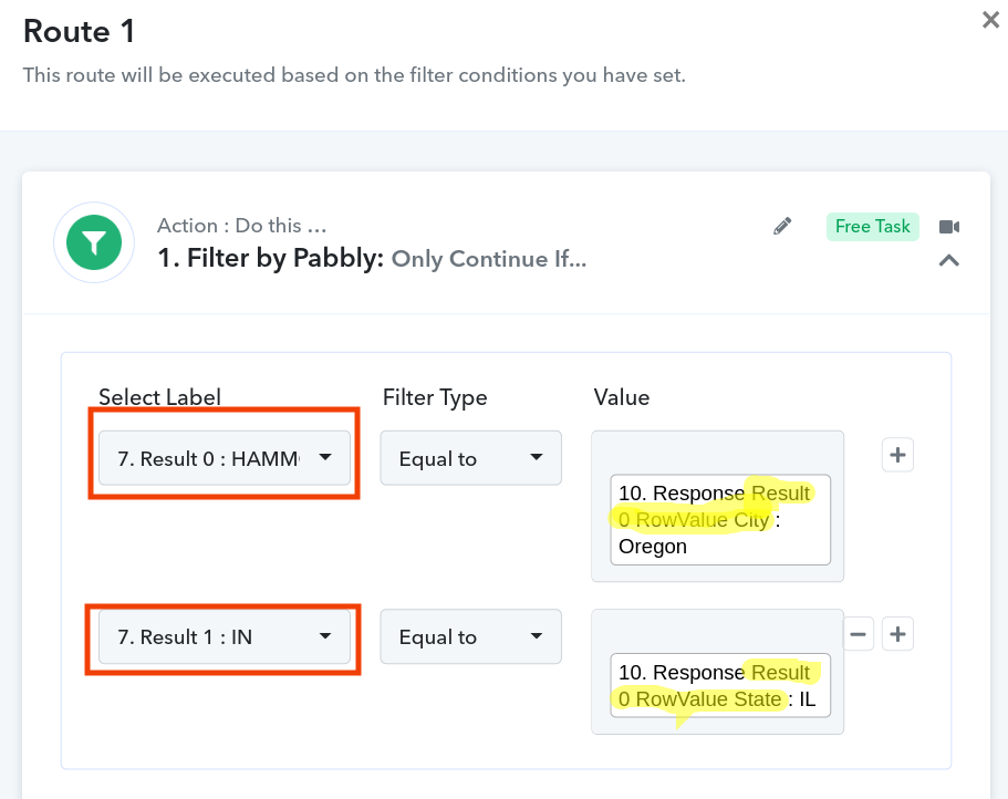

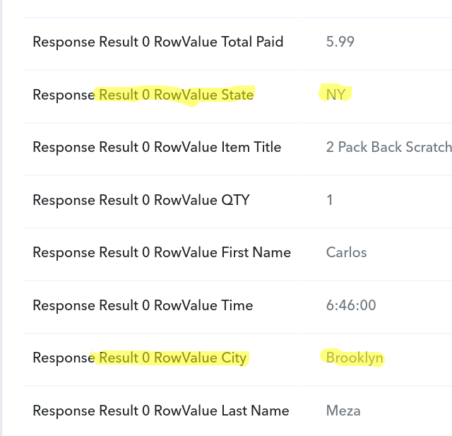

Tirezyas
I can't even check what is being passed to the router step because it is not there. It's completely gone. I verified my conditions and they seem to fine. based on the below screenshots, Route 1 should have been executed at the router step. Is the filter case sensitive?
