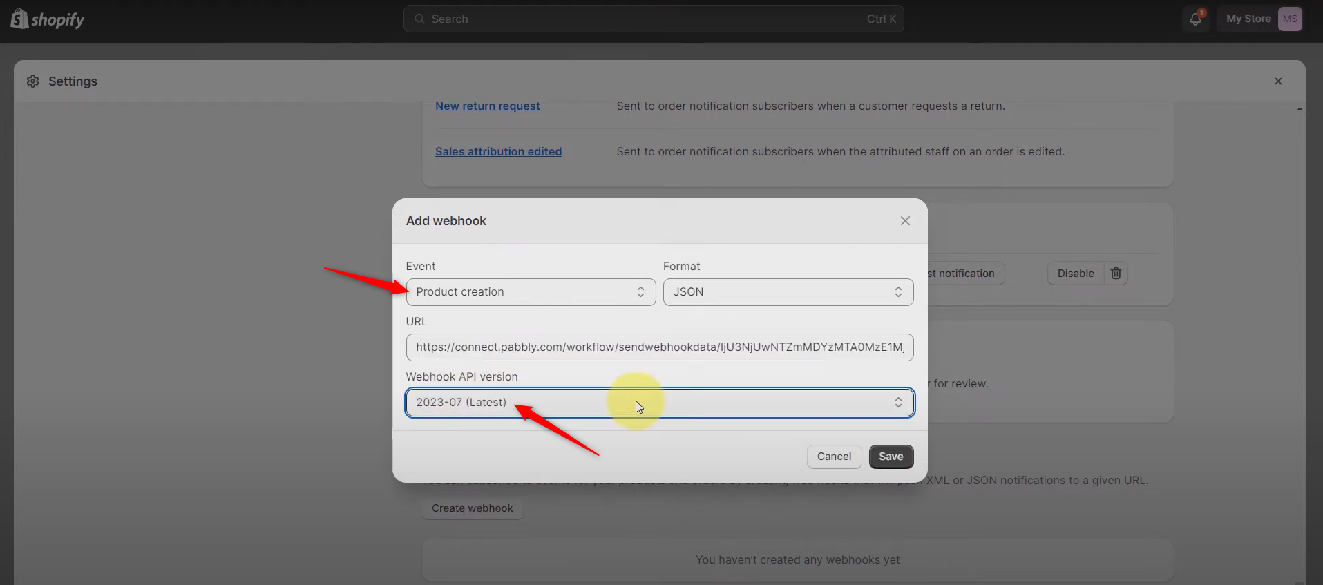

Further, I recall whenever trying to set up a new webhook, there is always a dropdown of options: unstable, release candidate, latest etc.
Please confirm which should be selected and answer my Route question from previous.
Kindly follow the exact steps given in the video share below to setup your Shopify trigger step.
youtube.com/watch?v=mmfPlvLYOLg
You are supposed to select 'Product Creation' as the Event and choose 'Latest' in the Webhook API version.

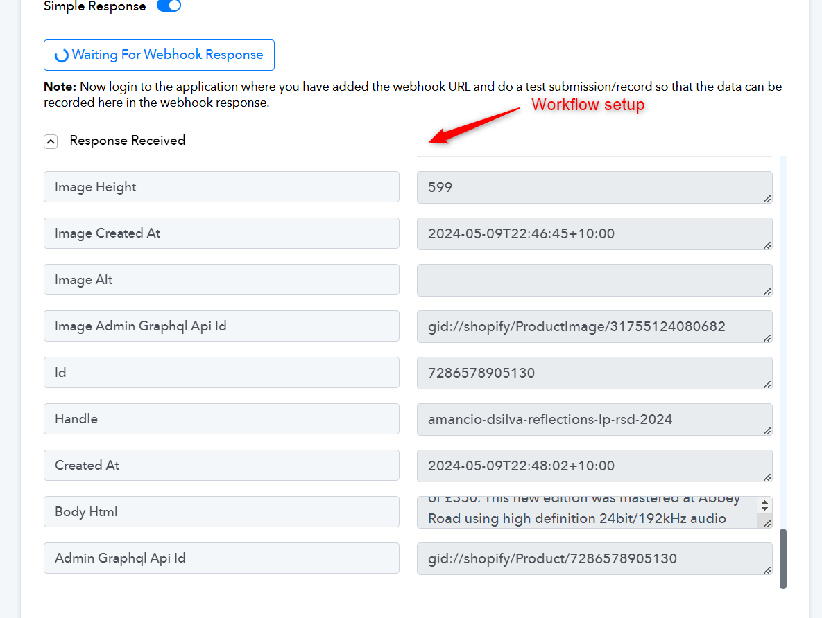

You have setup the trigger step correctly. Now create a new product in your Shopify account; it will appear in your workflow setup (not on Instagram or Facebook).
Then create another product in your Shopify account; this product will appear on Instagram and Facebook.

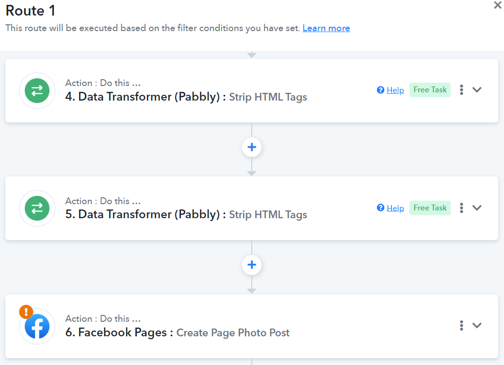

I have just noticed this in the Route filters, is this what caused it to not work?
You have not mentioned this "deprecated" event at all in your instructions.
Both Routes have this deprecated Facebook Pages event (which I don't kow how to repair!)

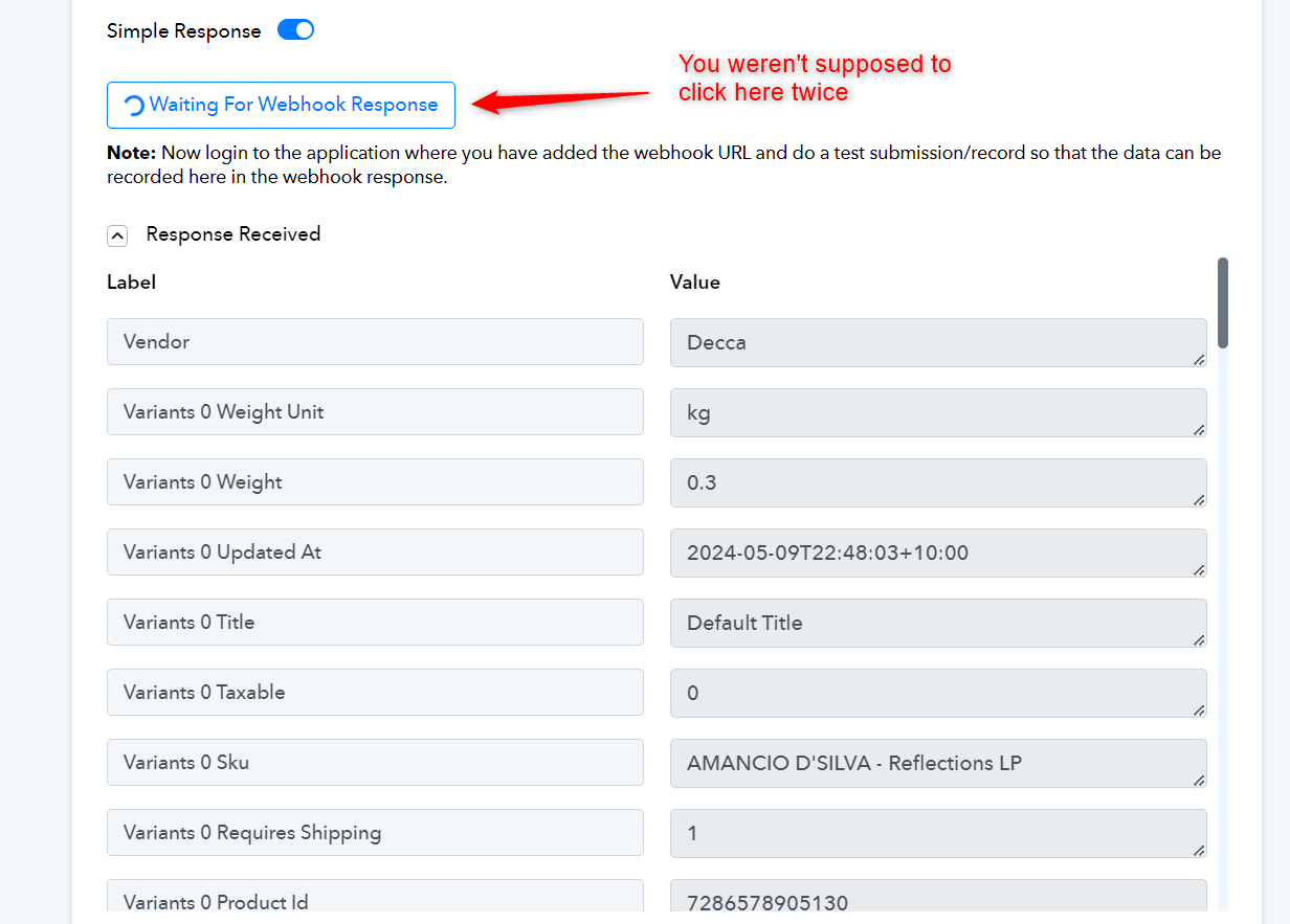

Also, when the product I entered did not appear on Insta or FB, I clicked the blue button (something about "Send Request & Receive"), which is now back to "Waiting For Webhook Response" - doI need to complete the Trigger step again because I clicked the Send Request button?

What about the Facebook deprecation?
You weren't supposed to click on 'Re-Capture Webhook Response' once you had captured the response. That is the reason why I asked you to create 2 more products. One product will be captured in your workflow setup, while the other will be passed on to Instagram and Facebook.
For now, you don't necessarily have to make any changes in the Facebook Pages action step. Once you have followed the instructions I have stated above, if the data is not passed on to Facebook, we can look into that as well.
