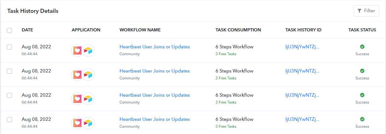

My new Heartbeat workflow triggered 4 times this morning and sent a DM to my community member all 4 times ?‍♀️This workflow isn't using "Webook" as the trigger, it's using Heartbeat as the trigger. Please help.

I have received a response back from Heartbeat. They said to use the "new user" trigger instead of the "new or update user" trigger. I have created a new workflow & will see if that solves the problem. I would then need to have a separate workflow to perform when a user is updated. There currently is no "update user" trigger, only "new or updated user". I would love to see that added.

You can identify the new and updated users from the Heartbeat trigger response, where you can check with the help of the recently created user time with the current date and then we can process the user accordingly.
lifeninjamisty — Reply ·
Thanks. For my workflow, I was just checking to see if they already exist in my Airtable base & if they do, I know it's an update. If the "new & updated" trigger is causing multiple fires for new user joins, it feels like it really should just be only for updated users.

How did the New User trigger work for you @lifeninjamisty ?
Even with the “New User Trigger” I see it fire 4 times (apart from other issues with Pabbly: namely not passing the HB id to subsequent actions like it’s been setup to do - and in fact does when I manually re-execute…)
