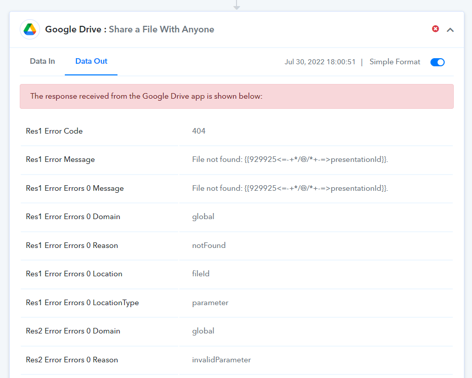

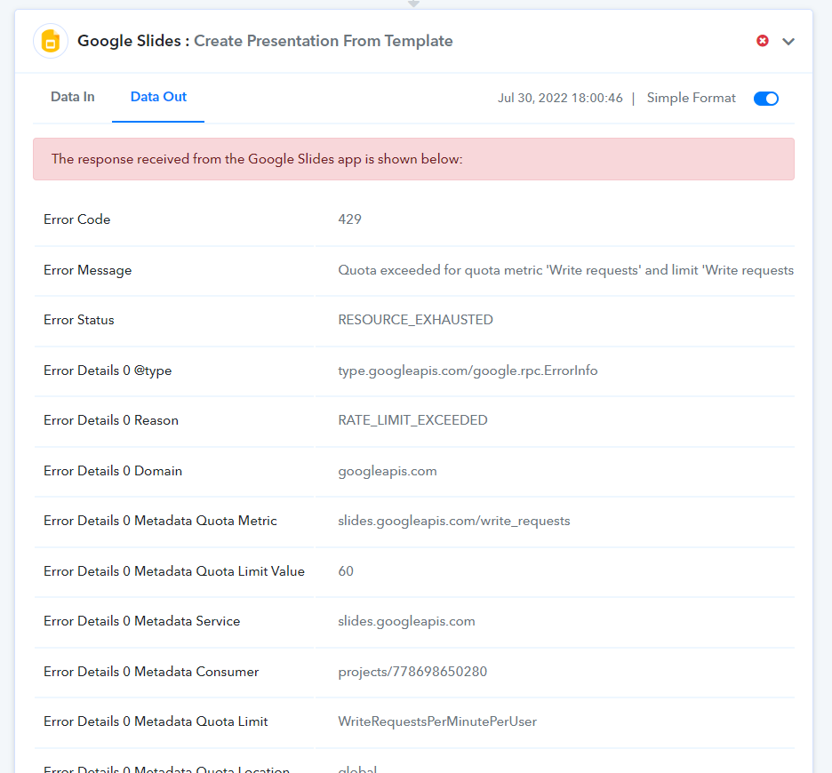

Example:
Task ID - IjIwNjczMjk1MiI_3D executed at Jul 30, 2022 15:39:07
This task has Couple of Failed Triggers: Google Slides and Two triggers after this which are depedent on the Google Slides Trigger.
This type of workflow has failed for approx 150 users today!
Request your help on the same
Hey @zest83
As we can see from your task history Id, due to excessive use of the Google Slides action step, your Google Slides was out of rate limit which cause the action step to not generate the slides at all and because you are passing the slides' Id in the Google Drives action steps your Google Drive action step also get failed correspondingly.
