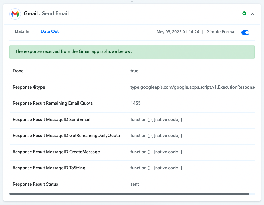

Its a simple workflow. I have joined Google form with Google Workspace Email response.
Both Triggered Well.
Email is also showing in the sent Folder in my google workspace gmail account but not getting delivered to the destination address.

I'm facing the same issue. The response shows sent on Pabbly but the recipient isn't receiving any emails.
The email is in the sent box but isn't received. The sender email is Google Workspace email.

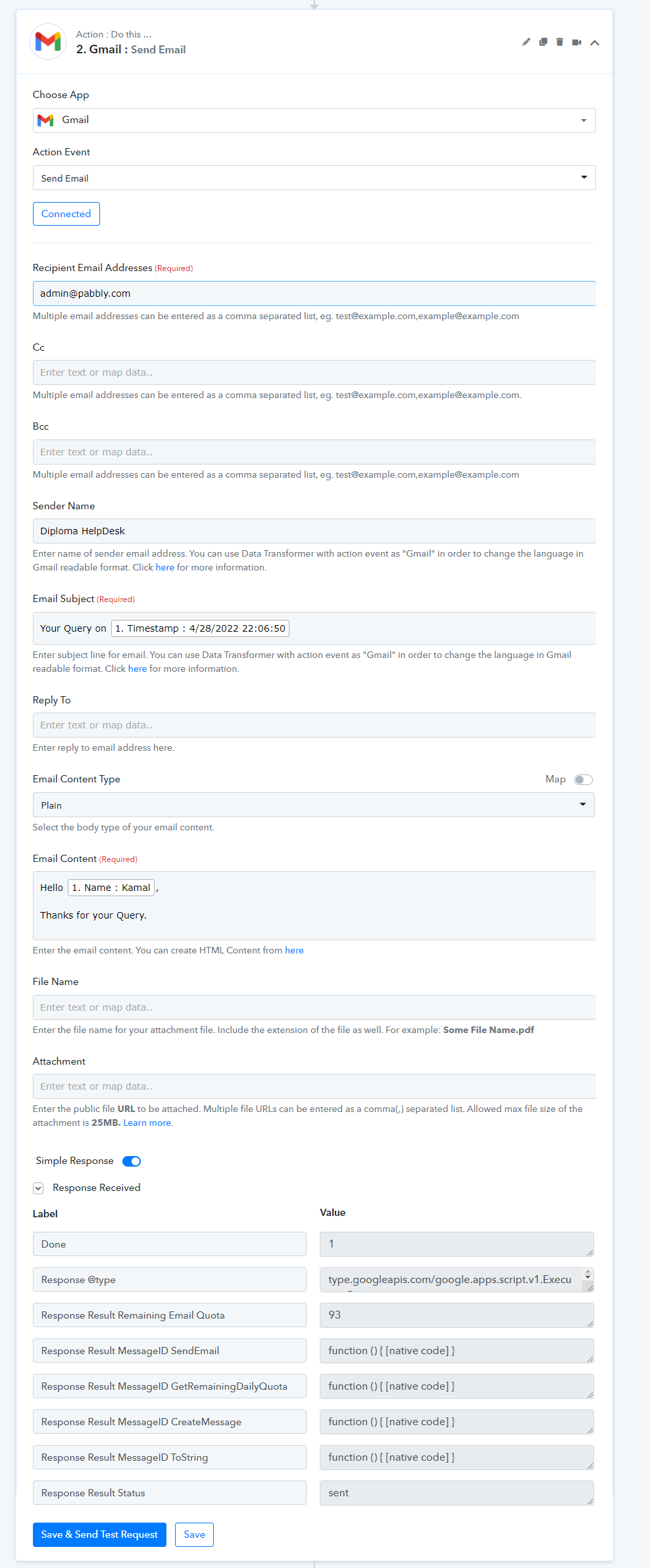

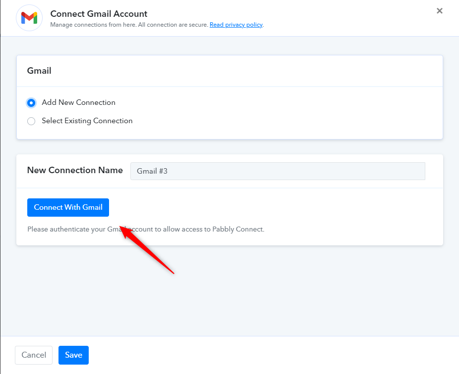

Hey @Shreyas Umesh
Can you please make a fresh connection with your Google Workspace email and then try? We tested through Google Workspace email and we were able to receive the email immediately.
Do let us know if the works for you.

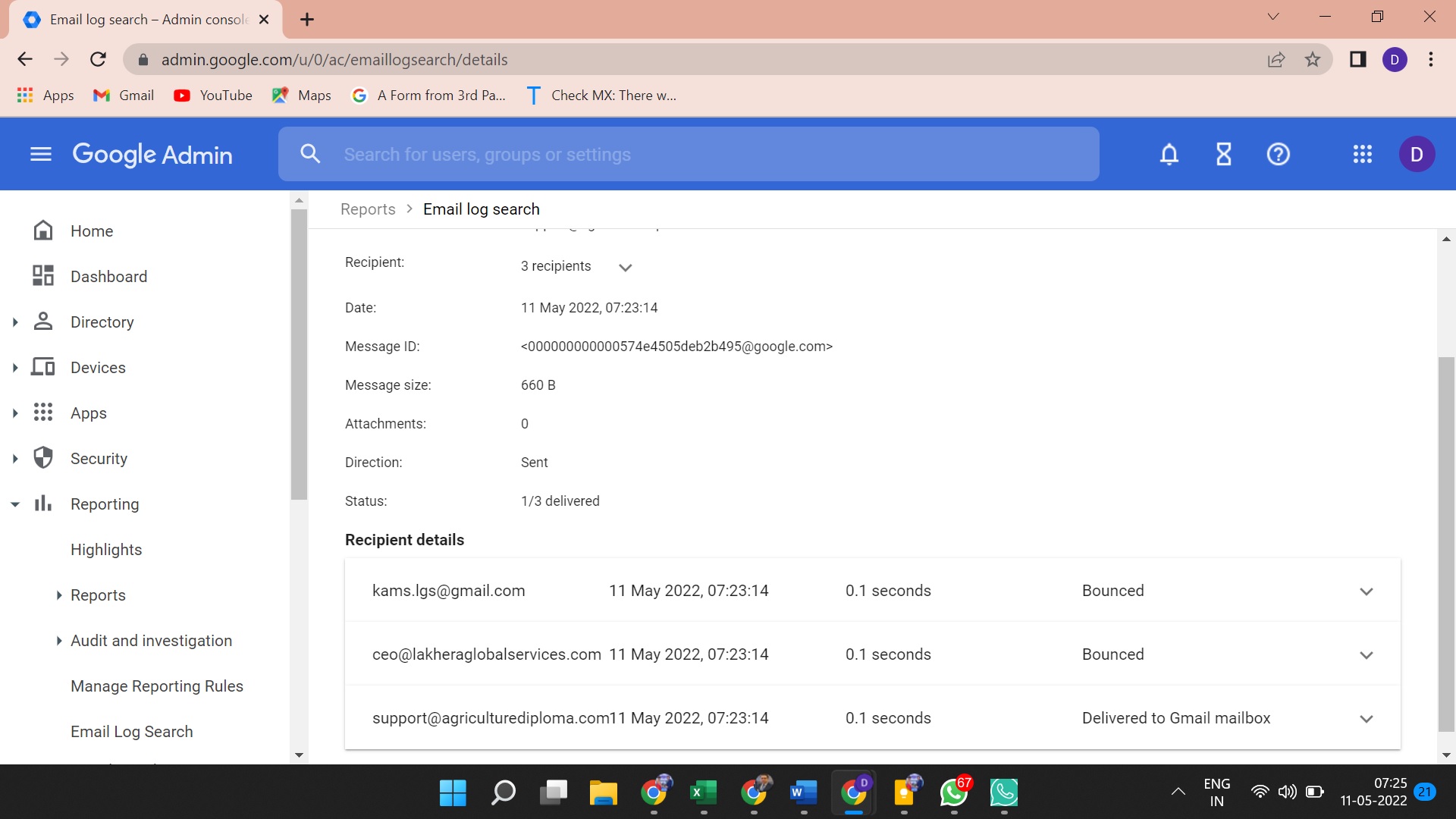

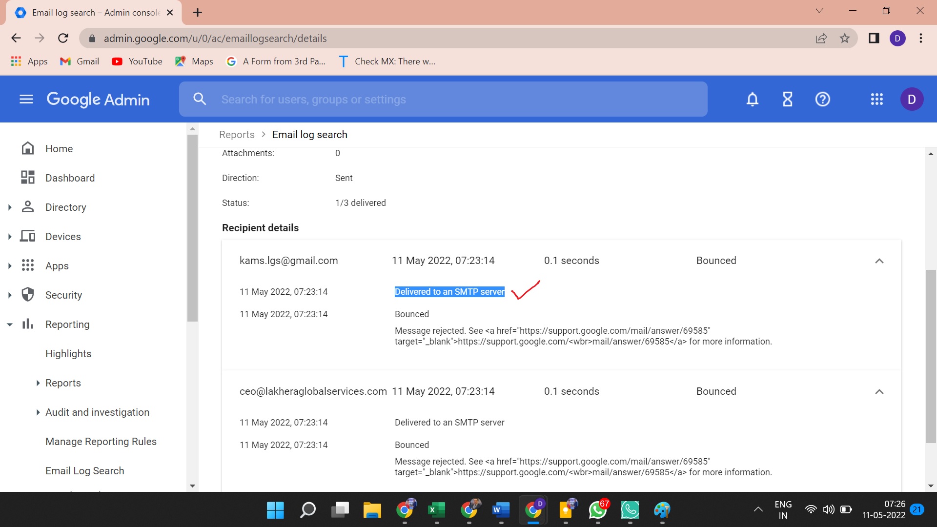

Kamal Lakhera — Reply ·
Just reached to the logs email sent through Pabbly Connect. (Snapshots Attached)
Please help to solve the issue.

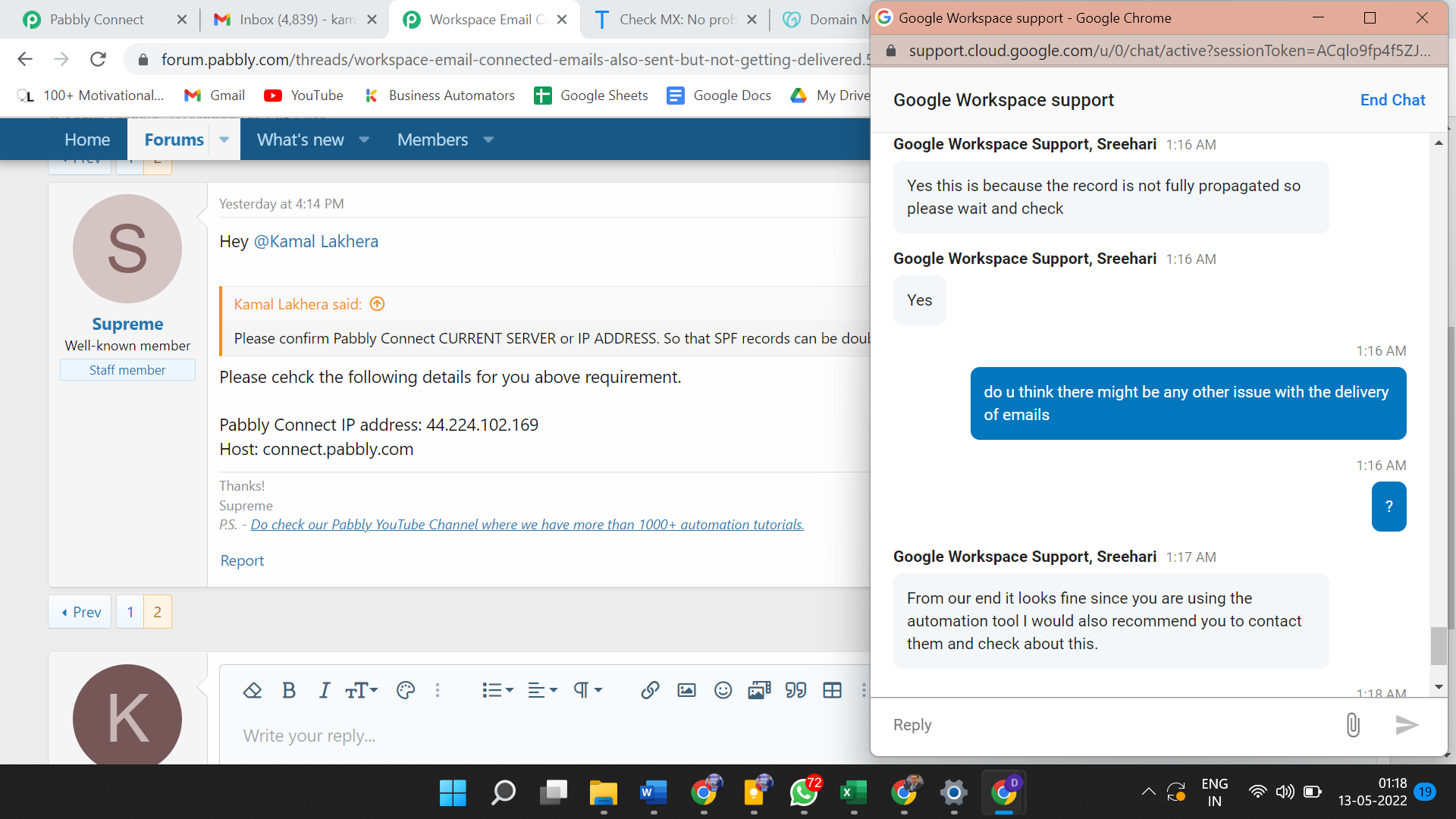

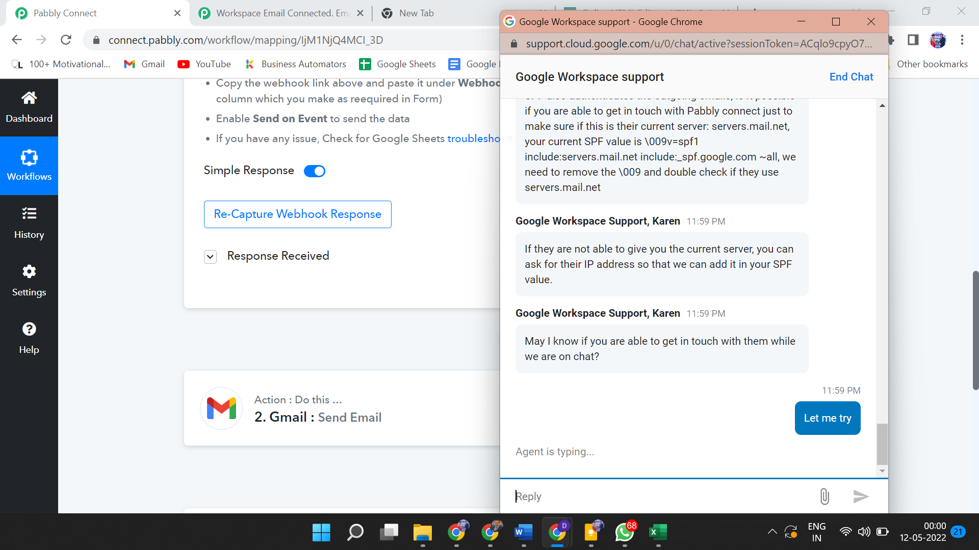

Please confirm Pabbly Connect CURRENT SERVER or IP ADDRESS. So that SPF records can be double checked as suggested by Google Support.
Hey @Kamal Lakhera
Please check the following details for you above requirement.
Pabbly Connect IP address: 44.224.102.169
Host: connect.pabbly.com

Can you check the logs in your Google Workspace account and see what delivery status is being shown thereon for the email address admin@pabbly.com? We made the test at around 12.55 PM IST on 14th May 2022.
We are sending the Gmail log as well which you can share with the Google Workspace team so that they can help you out. Please check your registered email address where we have sent that information from email admin@pabbly.com.
