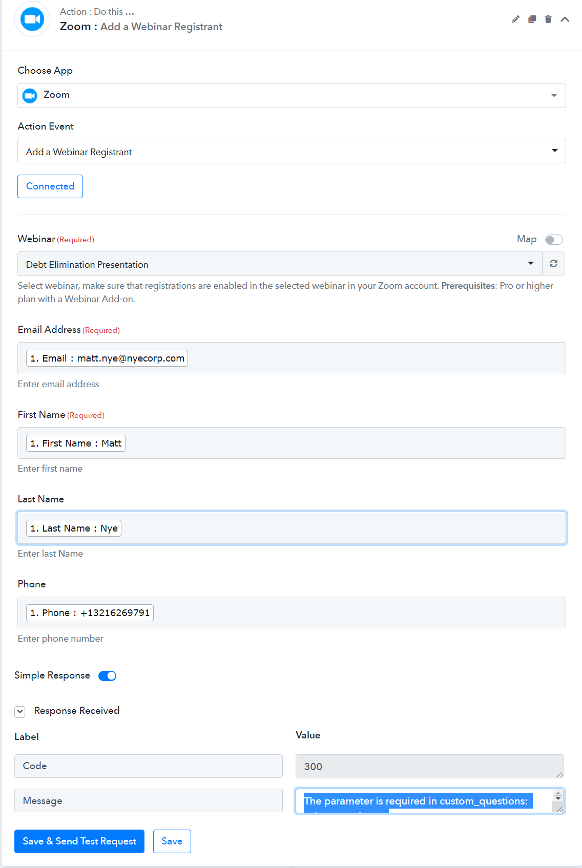

Hello, I'm trying to add webinar attendees to Zoom after they register in HighLevel. We have a required question set up in Zoom for who invited the person for people that register directly via the Zoom registration page. Turning this required field off is NOT an option.
When I test my workflow I get this:
Code 300. The parameter is required in custom_questions: Who invited you?.
I want to pass a custom value I've defined for the GHL webinar registration form, but I don't see an option to add additional data like that into the Zoom required question field? I can do it in Zapier, so I assumed I could do it in Pabbly, but I can only see the basic contact fields from Zoom. What am I missing?

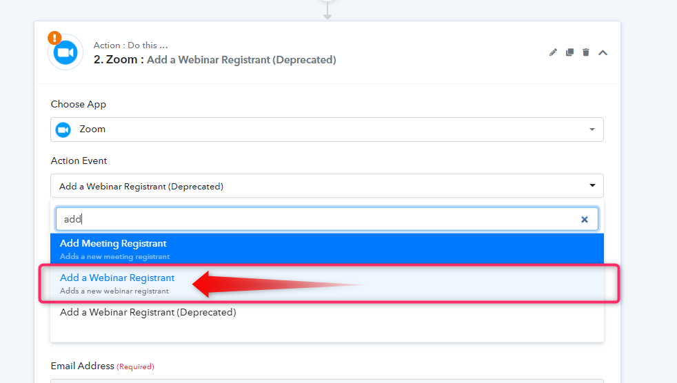

Hey @virtualinfosys
I'm sure the registration will work if I remove it - that is not the question. The question is can I pass data from HighLevel - or something added manually in Pabbly - into that custom field in Zoom like I can with Zapier. If Pabbly is unable to pass data through to that field in Zoom like Zapier can then it's not going to work for me...
As per your concern, we have updated the "Zoom: Add a Webinar Registrant" action event from our end accordingly. Kindly try again with the new action event and let us know if that works for you.
Regards
virtualinfosys — Reply ·
Hey @virtualinfosys
Regards
Hey guys, yes, this now works. Thank you very much!!!
