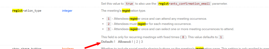

Upon reviewing the API documentation, we noticed that the registration type can be set to three values: 1, 2, or 3, with the default being 1. Currently, in the action, you are passing null, which results in the default value being applied in real time (1), meaning attendees register once and attend recurring occurrences.
However, as per the API documentation, there doesn’t seem to be an option to disable registration.

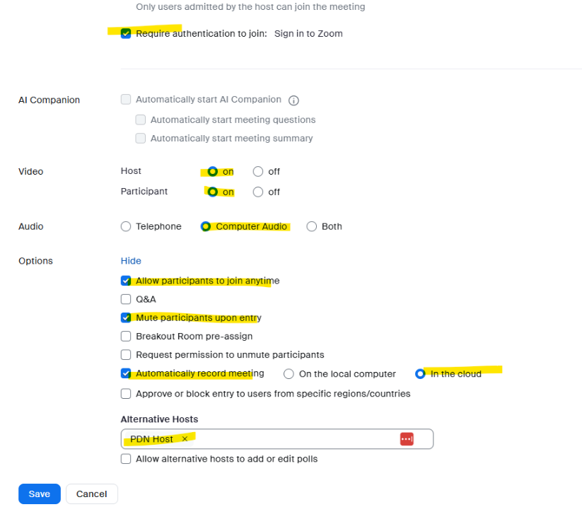

Thanks for checking. There must be a way to create meetings without requiring registration, I'll keep researching.
The reason we can't use the Pabbly in-built action is because it doesnt give many of the options we need to turn on/off (as per the above data parameters).
Would Pabbly ever consider allowing more options to choose from when creating Zoom meetings for the in-built action? These are the ones we are specifically missing in case it helps -

Our team has added a few new fields in the Create Meeting and Update Meeting actions. Please try using these actions and let us know if they work fine for you.
Looking forward to your feedback.
projects@developernetwork — Reply ·
Thanks so much Preeti and team, this is great!
I've just done a test and it works, thank you, but we're just missing the 'alternate host' option. If you have the ability to add this, that would be great. But please don't rush as I have put the Custom API request in place in the meantime.
