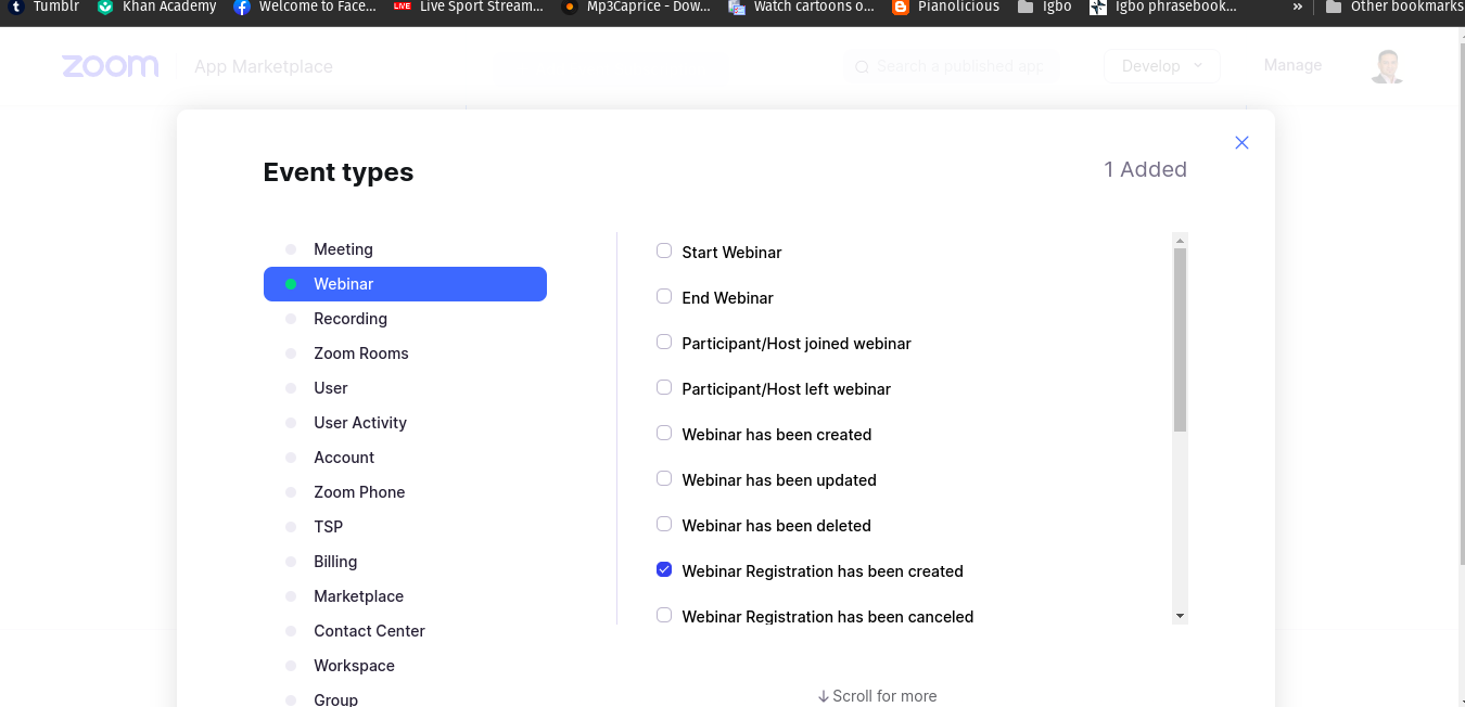

Fagun Shah — Reply ·
Which trigger event you have selected in zoom developer section webhook setup
Share a screenshot.
Here is what I would do, create a trigger in zoom for Webinar Ended and then use action for getting Webinar Attendees with simple response turned off. And then us e Iterator and GHL step.

@Fagun Shah
here's the screenshot of the event i selected on zoom.
sajhussain — Reply ·
okay @Fagun Shah
It worked thanks you
