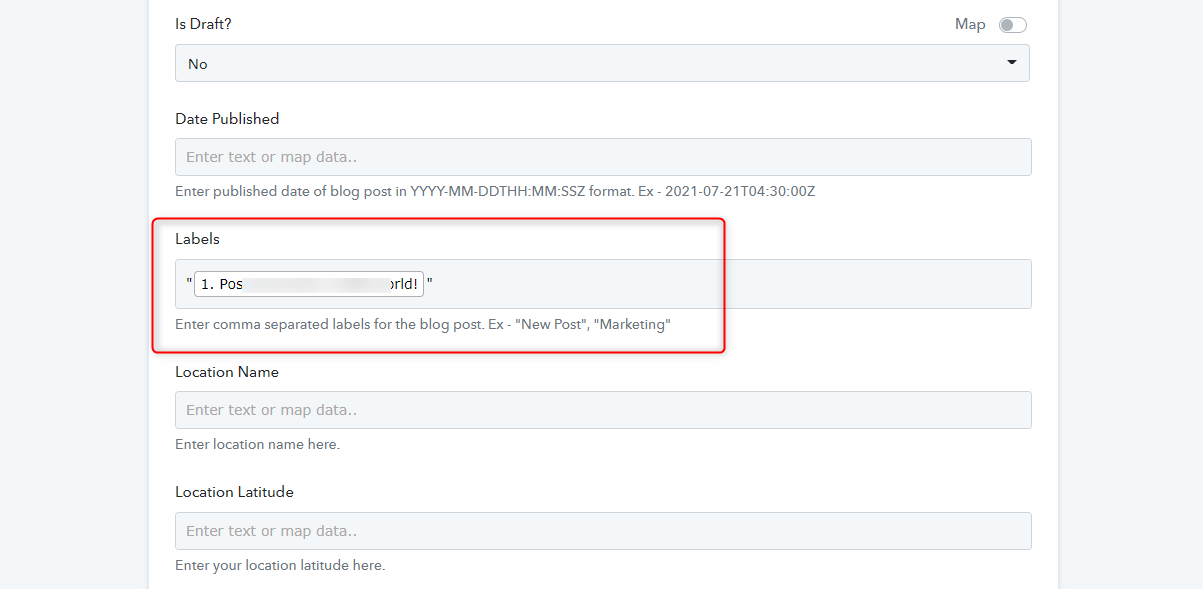

Hey @Look
It seems like you haven't passed the label in double-quotes and because of that, you have the error occurs.
Though we have made the correction for you and it is working fine now. Kindly try again and let us know if that works for you.

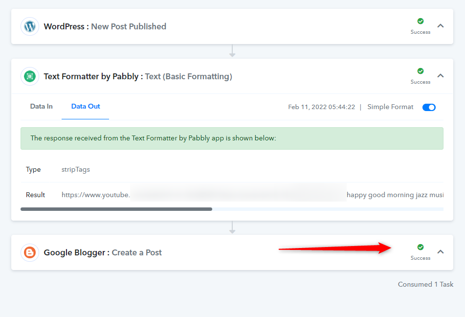

Hey @Look
From WordPress, the content is coming with HTML tags which were causing invalid JSON errors in the Google Blogger. Though to remove the HTML tags we have added a "Text Formatter by Pabbly: Text (Basic Formatting)" which will remove the tags from the content and pass it into simple text.

Hey @Supreme
Thank you for adding the text block, but it's not working correctly.
I gave it a few days to run, but the content being posted on the Blogger blog is nothing like the original.
It's just posting dead URLs that are not even live links, not mentioning the embedded videos.
I'd like the Blogger posts to be like the original ones, with a live link back to the original.

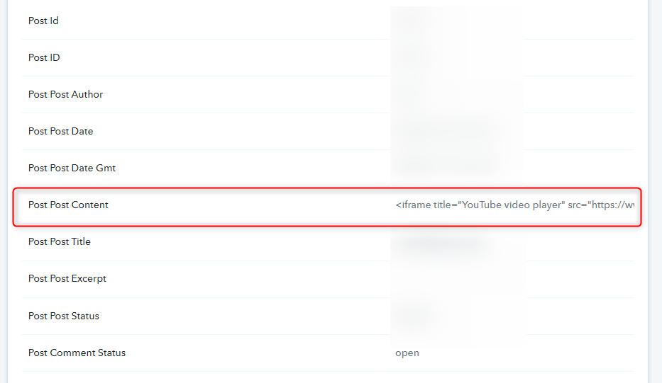

Hey @Look
For a youtube post, you need to replace the double quotes with a single quote and a <br> tag then you can post the video on Blogger. So, kindly try again and let us know how it works for you.
Though we have already made changes for posting the video links in your workflow. Further, you need to design your post by yourself or you can appoint an automation expert for that.

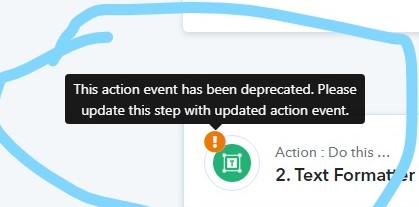

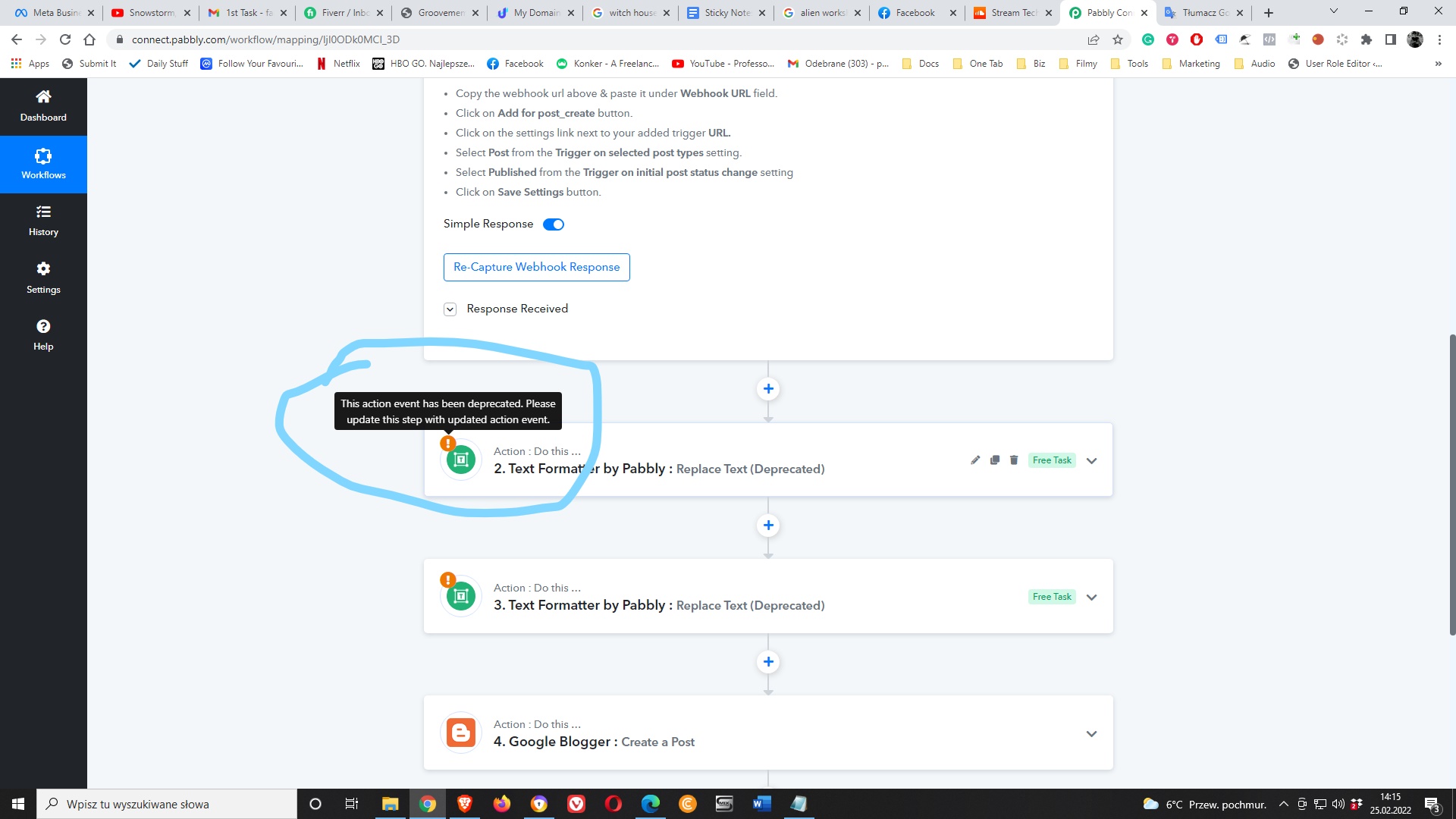

Thank you for your reply, I just wanted to do everything you have written, but by the every Text step/box I can see this info:
I didn't touch this so how this got deprecated and how do I update it?
Hey @Look
The mark which you are seeing means that the action event is deprecated and there would a new version of the same action is now available. It is recommended to use the newer version.
The old versions are not removed until 10-12 months so you can continue to use them in the meantime and it will work normally. When you have the time it's good to upgrade to the newer versions of the same endpoint.
