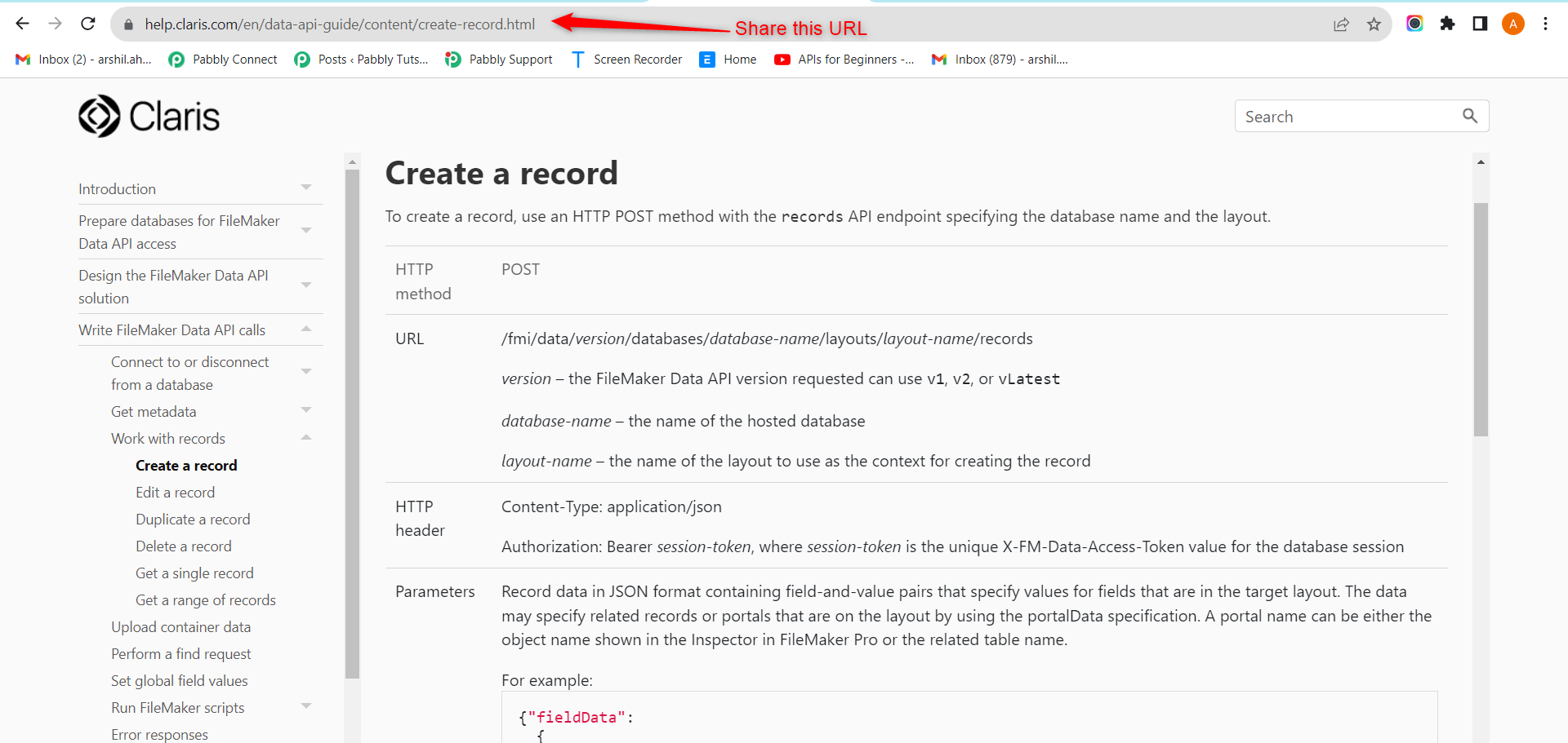

Could you please share a direct link to the specific endpoint you are using?
Please share which specific endpoint you are using in this document: https://help.claris.com/en/data-api-guide/. For example, if it's 'Create a record,' please share the link to that part of the document, as shown in the screenshot below

@joy4all, The link you have shared is the endpoint URL. Could you please share where this endpoint is located in the API documentation you shared? I need to see in the API documentation what this endpoint does, its authentication type, its parameters, etc
