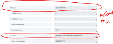

I've been able to accomplish steps 1 & 2 but I'm getting stuck at step 3 because I don't know how to process the data that the API sends back in step 2.
  • When the data comes back from via the API, it is in the form of a list of unique labels and their associated values such that the names & emails appear in the format below (see screen shots) with the response getting longer or shorter based on however many affiliate redords PushLap has at the time of the API Call in step 2
  • I believe there is way to use a JavaScrip for step 3 (such as the code below) to accomplish my desired workflow but I don't think Pabbly allows me to assign the entire API response from step 2 as a variable within the code.
    • In all of the Pabbly Code tutorials that I've watched so far (such as this one), they are working with variables that use a static label and and data that changes based on the parameters within the API call.
      • In my situation though, I'm using the API to retrieve a list that will vary in lenth as referrals are added and where each person on that list will have a unique label and associated value for their email
        • Without the ability to assign the entire API response from step 2 as my variable within my JavaScrip, I'm not sure how to do what I need to do...

  • Step 4: Use JSON extractor to convert step 2 array into format that camp be mapped
    • There are 17 data labels and unique values for each PushLap referral record
I've successfully gotten my workflow to execute through step 4, but I'm not sure how to execute the rest of what I'm trying to do:
  • Step 5: Figure out how to isolate the unique set of 17 data labels and their associated values that relate to the email sent from SuitDash in step 1
