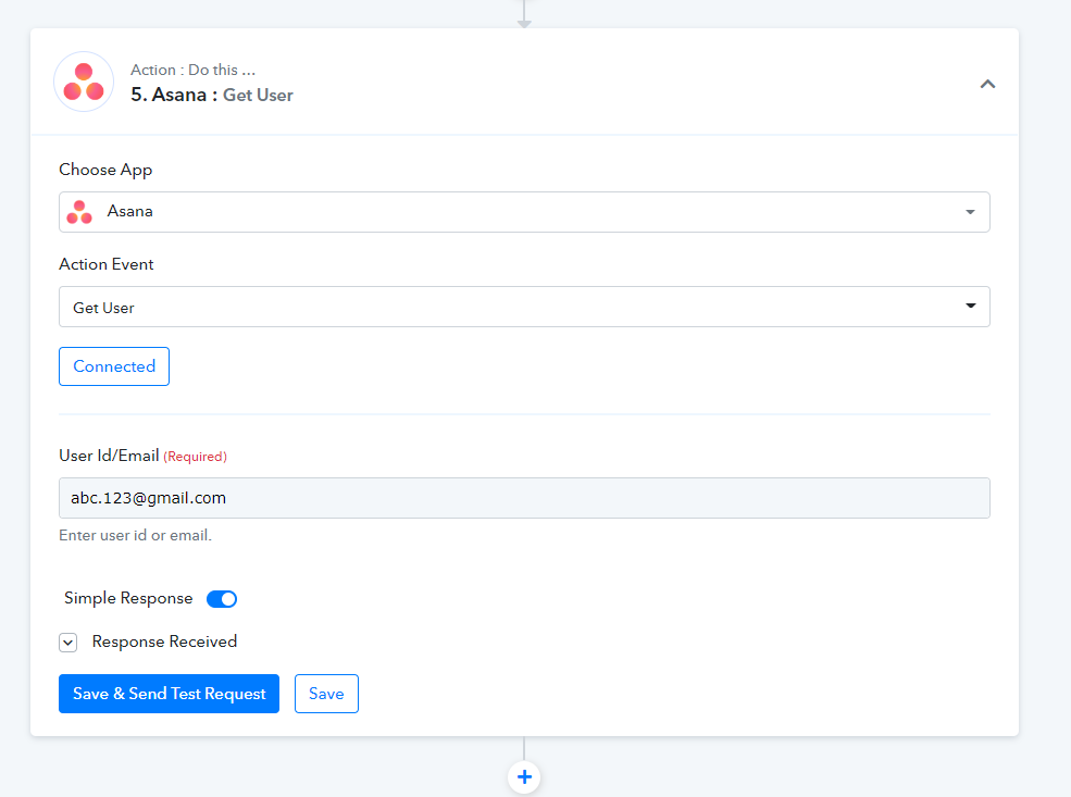

Hey @oroettger
when I create a new task in asana or update a task in asana it is not possible to map followers. I tried it with names, the number in asana and the emailadress of an follower. Am I doing mistakes or is there something wrong in pabbly or asana?
For your concern, we would suggest you to use the "Get User" action step to retrive the additional details including the Id of the follower which you can further pass to the Follower field further.

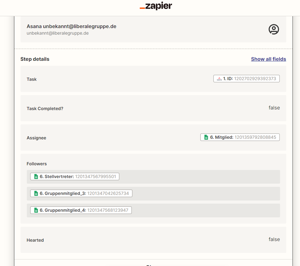

but i need more. how could i rsolve that ? it is possible in zapier:
and when not mapped, but choosen in pabbly, it is possible to choose more than one follower.

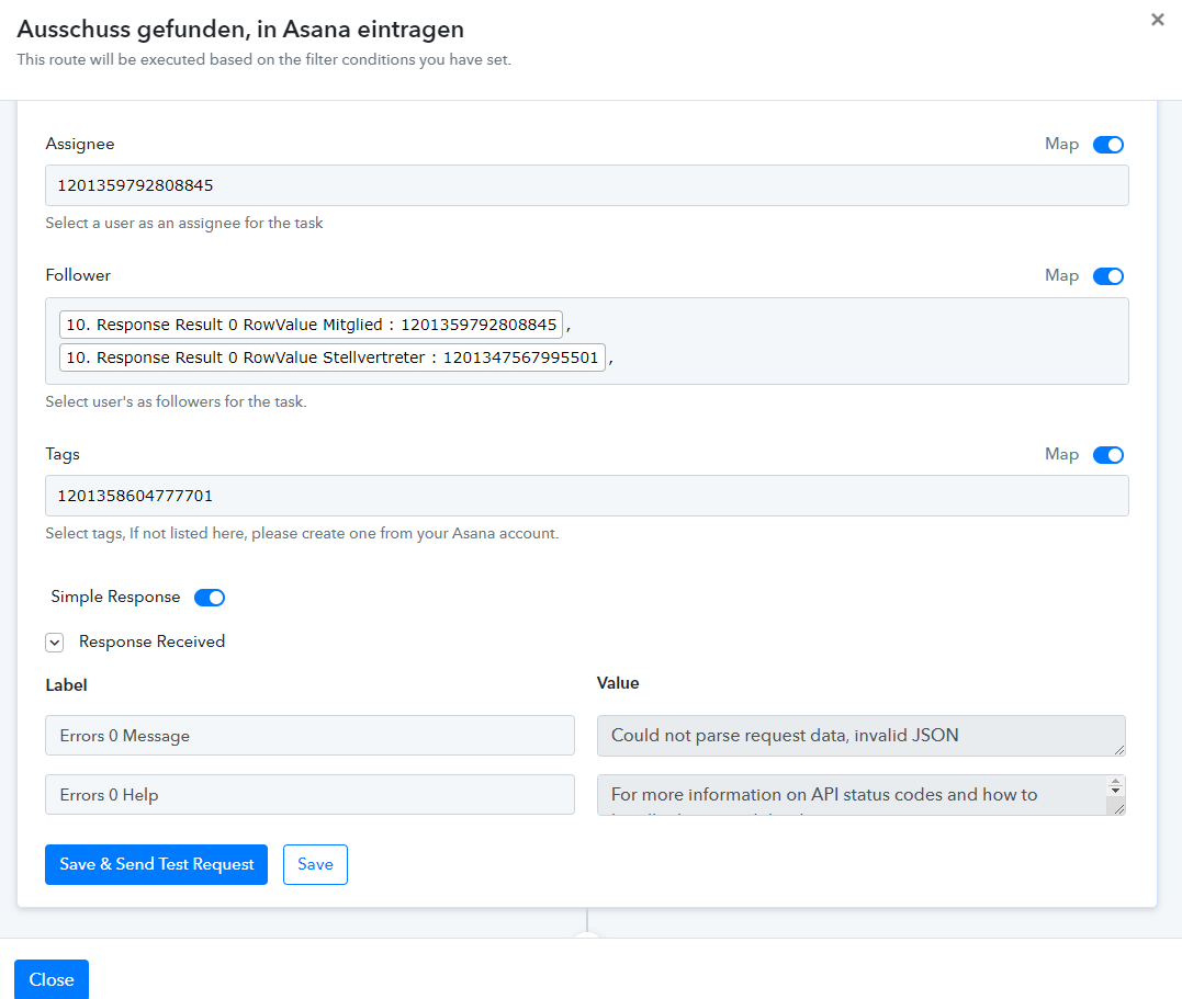

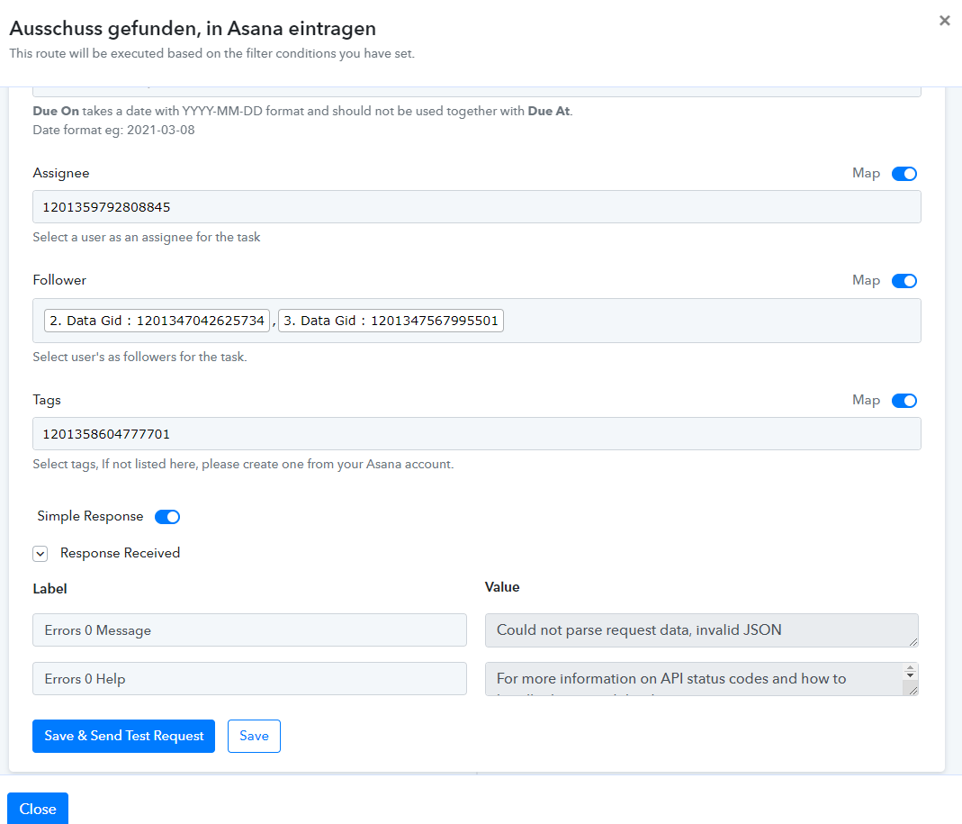

Thank you, it is working. But i have a problem with https://connect.pabbly.com/workflow/mapping/IjU3NjAwNTY4MDYzNjA0MzU1MjZhNTUzNCI_3D_pc
also related with asana. The last step creating a task in Asana ist not working and i do not know why. it is the second route (Route Ausschuss gefunden) the last step.
Error Message: Could not parse request data, invalid JSON

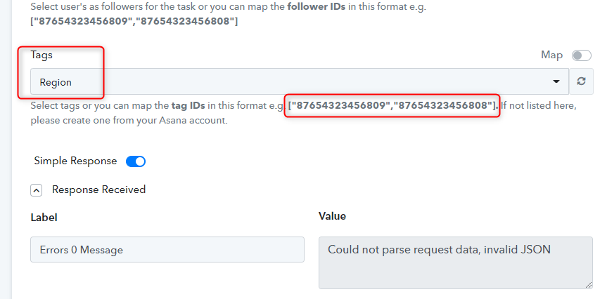

Hey @oroettger
We have checked the workflow and found that you are not entering the tags in the correct format. Could you please re-check and pass the tags in the correct format as shown in the help tip in the workflow.

Hey, thanks, but I did this also, but did not work. I can try again, but just to mention, the tag you are seeing is from the drop down list offered by pabbly in this field. This should work as well, or?
oroettger
the error occurs, if i map content from the first step in the notes field. the workaround is, to enter the notes with another step "updating task in asana".
But normally it should work with one step. anyway, perhaps you could have a look.

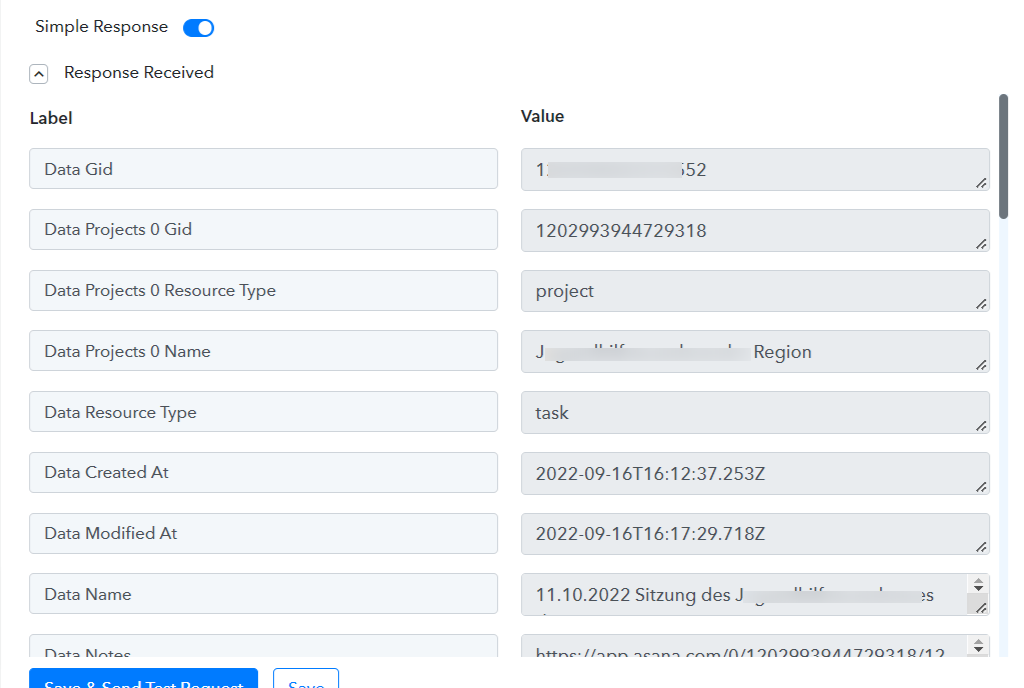

Pabbly13
Hey @oroettger !
We can see in the both Asana step in your router 2, the response is correct, it seems the issue was resolved at your end-
Kindly do a tets submission and check if this is working for you in the automation now.
Hope, to hear from you soon.
