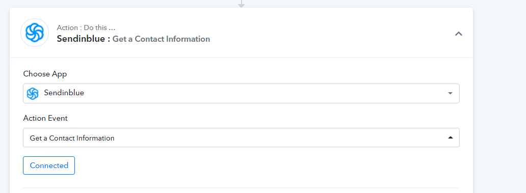

As a workaround, you can use one more step that check whether an email address already exist or not -

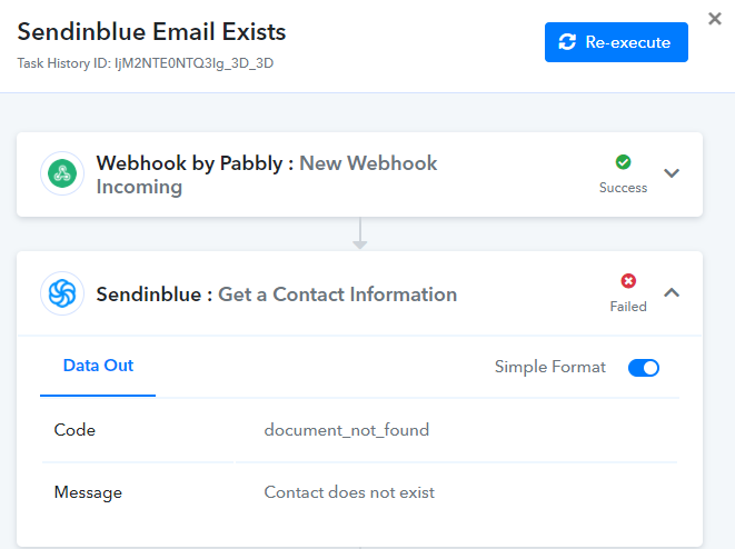

Yeah I did think about trying to set this up but as Fagun mentioned I believe this would give a partial error anyway when it fails to find the contact? So not actually any better off? :-/
