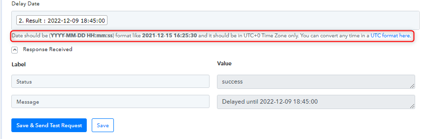

To run the Delay Until action step on your timezone you need to pass the time in UTC format as mentioned in the help text, if you are getting the time in IST (GMT 5:30) then you need to convert the timezone first and then process the time difference.

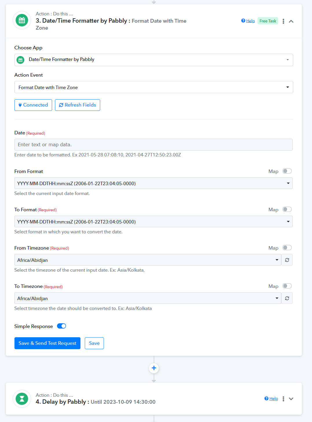

As mentioned in the Delay until Action step you need to pass the time in the UTC time format by first converting it from your country's local time with the help of the Date Time Formatter action step.
