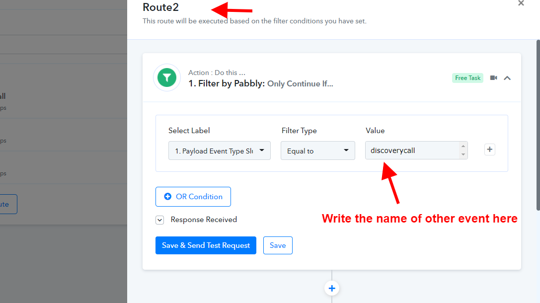

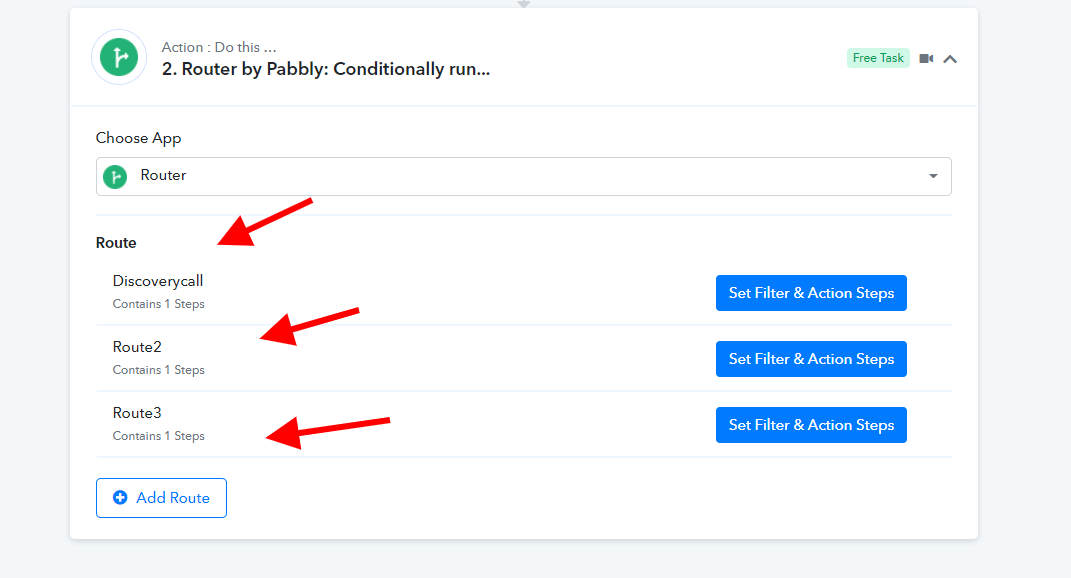

1. How do I do this for the other 2 Calendly Events to deliver to 2 separate Email subscriber lists - by adding new Routes?

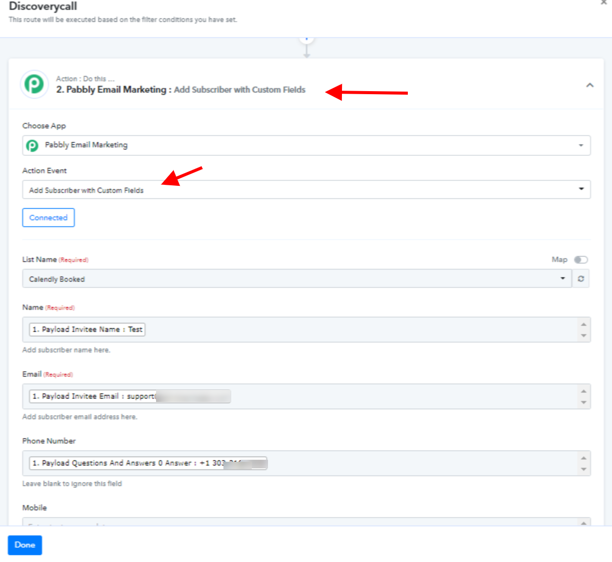

2. Can I make it so the phone number from Calendly is also added to the subsriber lists?
Yes you need to add a route for the other 2 Calendly events and set the filter to work based on the event name -
Yes you can do that using the action event "Add Subscribers with custom fields" -
