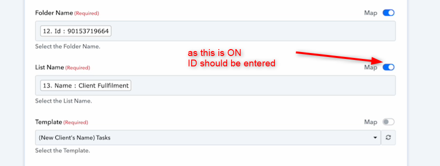

Found 2 little bugs for ClickUp, when you are trying to create a task from a template. 1st issue is that you need the List ID instead of the List Name, second issues is that pabbly only gives you 25 seconds to run the automation but, when i ran the same automation in postman, it took me around 40 seconds and I have a small list of tasks, which means that anyone with a larger list of tasks will take a lot more than 40 seconds, maybe 90seconds. here is a loom video https://www.loom.com/share/1bd7b8f7c32e4e68890d1a9e3438d9c4

Actually, when the map button is turned off, you get a dropdown to choose the "Name". And when the map button is on, the "ID" should be entered.
