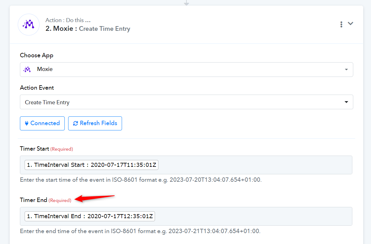

I am trying to create an automation whereby any new time entry in Clockify is automatically duplicated in Moxie timesheets.
I was able to setup the Pabbly Connect side no problem, however on the Clockify end there is no option for "New Time Entry" in the webhooks menu. There are: "Timer started (me)", "Timer started (anyone)", "Timer stopped (me)", "Timer stopped (anyone)", "Time entry created manually (me)", "Time entry created manually (anyone)", "Time entry updated (me)", and "Time entry updated (anyone)".
Does this mean that I cannot use the "New Time Entry" option available in Pabbly and must create a minimum of four separate automations in Pabbly to get the data over to Moxie?
  1. "Timer started (anyone)"
  2. "Timer stopped (anyone)"
  3. "Time entry created manually (anyone)"
  4. "Time entry updated (anyone)".
If I do that, will Moxie know which "Timer started (anyone)" and "Timer stopped (anyone)" to pair up to create one complete entry?
Before I go down the route of creating 4+ automations, I thought I would test a few.
I figured the most likely candidate for success was with the Pabbly side set to Time entry created manually (anyone) and the Clockify webhook set to the same, and if I manually add a time entry in Clockify it does show up in Moxie, but having to add the entries entirely manually rather than using the timer defeats the whole purpose of using the excellent Clockify app to begin with.
What can I do?
What am I missing?

Hi @justs,
Does "Timer started (anyone)" capture a TimeInterval End? If it doesn't, then you cannot use it with the 'Moxie: Create Time Entry' action event, as that requires an 'End Time'.
