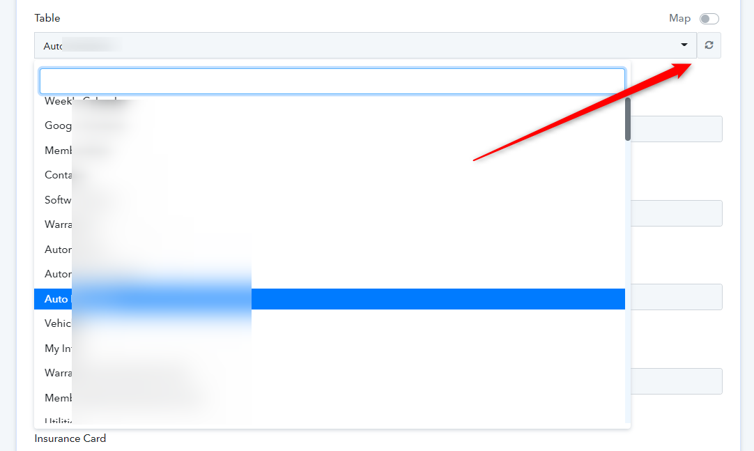

If you feel that all of your Table is not been fetched then you can simply press the "Refresh" button and then check the Table name on it.
Else you can re-connect the action step once when you want to re-configure it.

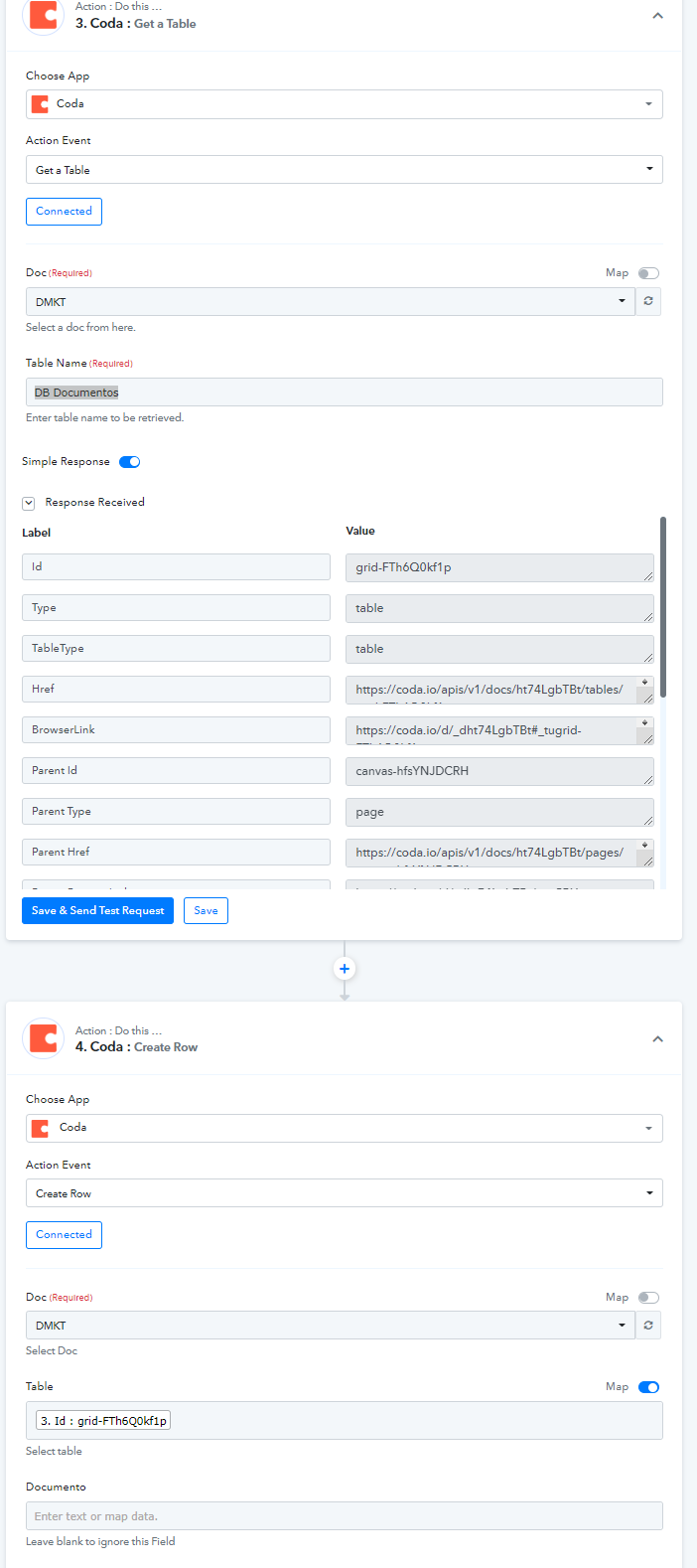

As we can see from your workflow, we can see all the tables in the dropdown, kindly let us know the number of tables in your Coda account.

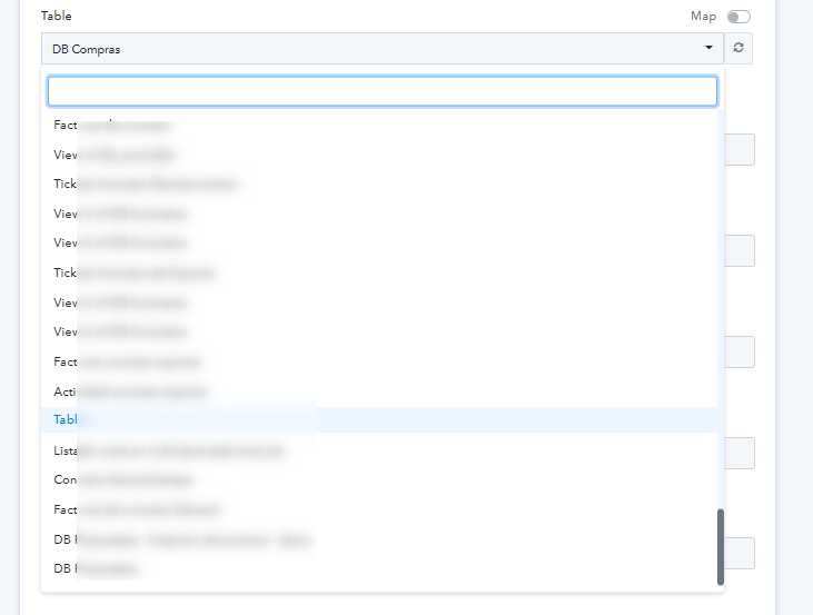

In coda, when you link a view to an original table, a new table is created. A document in which many views are made from one or more tables can quickly increase the number of tables.
Specifically, in this case, it is the "DB Documentos" table that I need and cannot find.

Seems like the Coda application only shows 100 tables in the list from their server.
So, as a solution you can use first use the "Get a Table" action step first and then you can pass its Id in the "Create Row" action step.

You can try manually copying the Table Id from the Get A Table action step and paste the Id in the Table field. After that, you can remove the Get a Table action step.
