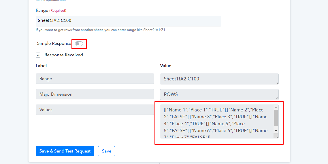

I used iterator which only passes first value in test, but passed all values in actual workflow execution.
Check sheet 2 of my Gsheet i have set it up to pass values every 1 minute.
Make sure you have simple response turned off so you get all values,

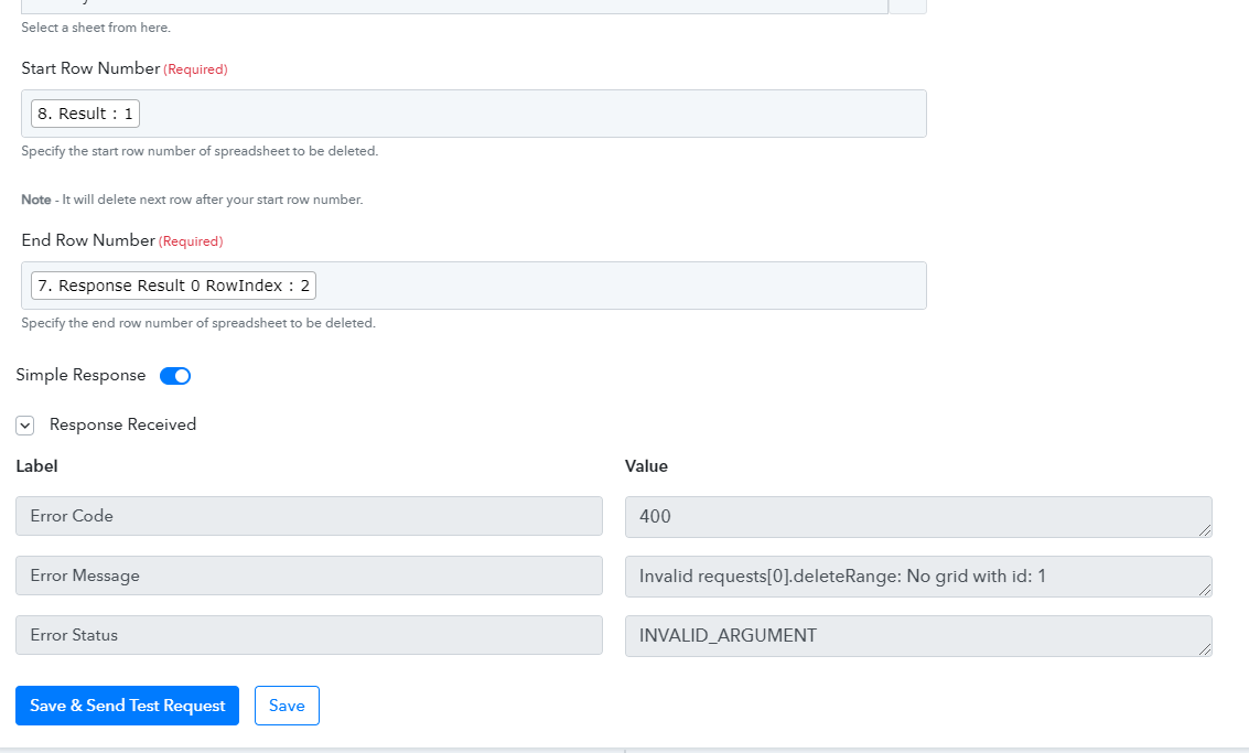

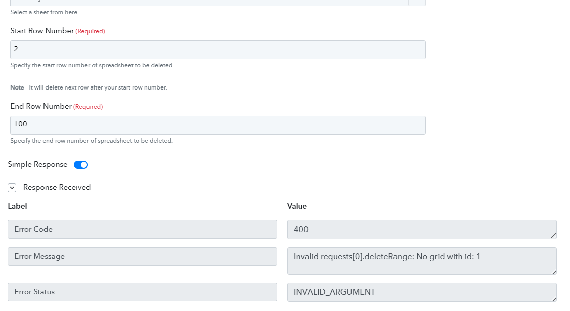

I was trying to do something in addition to this. So once it copies the values. I want the row to be deleted from Sheet 1. But I am getting this error. Also, I wouldn't want Start Row and End Row to be manually entered. I want them to be automatically picked up. Any ideas what should I do?
Fagun Shah
@sourav04 I think @Pabbly will be more helpful here. Bcoz I was also not able to delete a single row. It at least deletes 2 rows for me.
But for start you need to Lookup google sheet go get the row index and then delete that particular row by mapping that row index value.
Let's wait for @Pabbly Team reply on if it is possible to delete a single row or not?

Yes, it does work in that sheet, but for some reason when I am trying to replicate the same thing in another sheet. It's showing me the error. Any idea what is going on over there. Even Fagun had a look at that one.

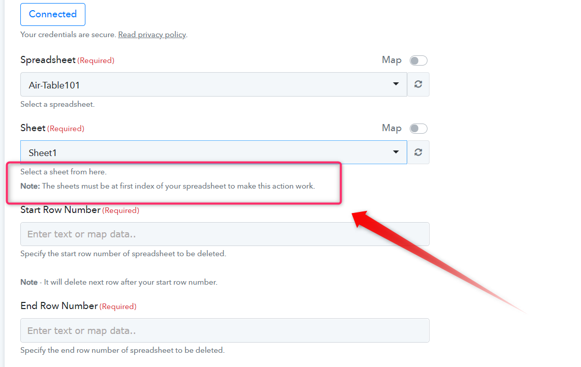

Hey @sourav04
In your spreadsheet, the sheet must be at the first index of your spreadsheet to make this action work.
I have had a word with our developers and it seems you are trying to deleting the data from sheet9 of the same spreadsheet. For your information, the desired action will work only with the first indexed sheet of a spreadsheet.
Please create another spreadsheet and try deleting the data from the first indexed sheet of the same.
Let me know how it goes.
Example -
Hey @sourav04
We have updated the help text beneath the "Sheet" field. Do let us know if you have any other feedback.
