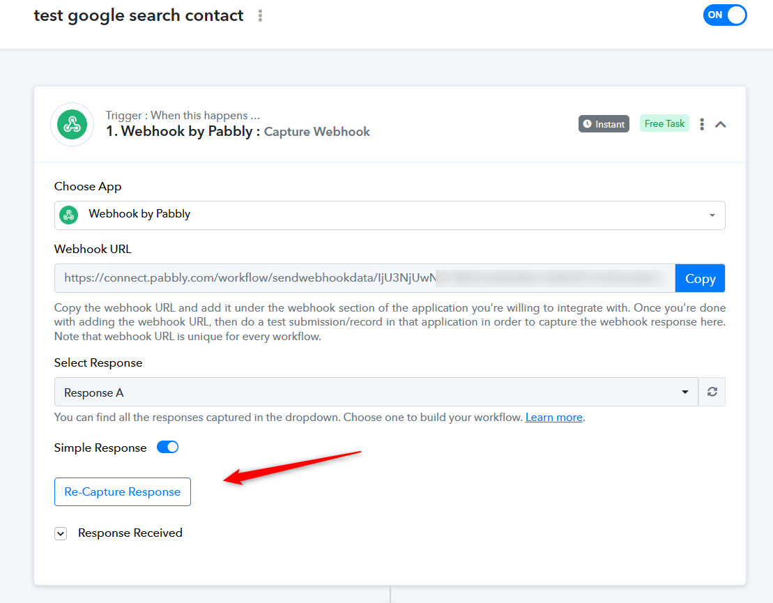

Can you please try recapturing the webhook response once and then try again?
dbs00
@Supreme
Delete your previous picture please that shows my tasks history
The webhook seems to be working correctly
The workflow runs daily a couple of times
But ill try recapturing it again. Np
