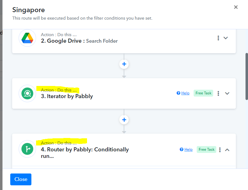

Creating a Google Drive folder if none exists but continuing the workflow after applying the filter step
Helen Dang

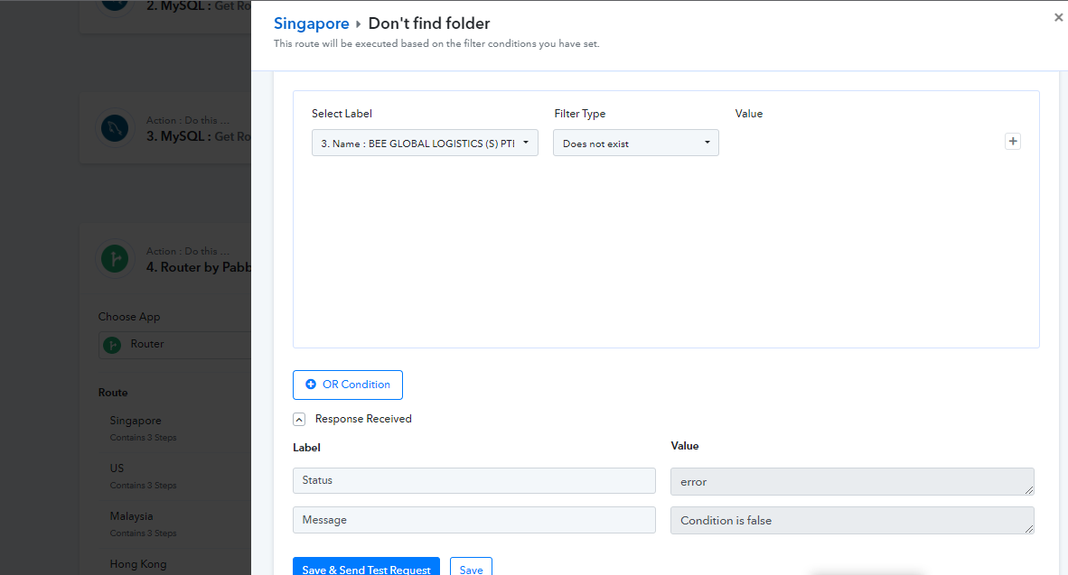

I used Search folder on Google Drive and Router then.
If find the folder, I will create a sub folder on Specific folder.
If don't find the folder, I will create a folder and create a sub-folder on this folder have just created.
However, if don't find folder, workflow stop here. I would like to continue the next step.
Please advise.
Thanks.

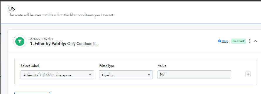

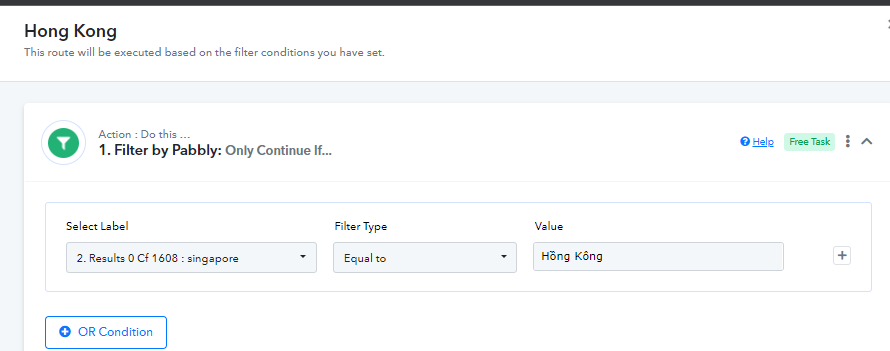

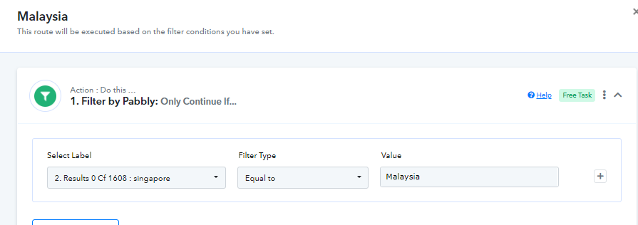

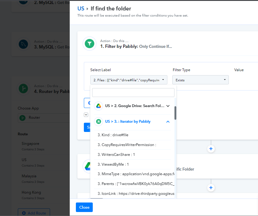

Hey @Helen Dang
We have identified that an incorrect "Filter label" has been mapped in the "Router>Singapore>Router>Filter" step of your workflow. We recommend that you re-map the label from the Iterator step to rectify this error.
We have made changes in the "Router>Singapore>Router>Filter" step and request you to apply the same changes in all other routes in your workflow, including those for US, Malaysia, and Hongkong, to ensure that the workflow is working fine.
Screenshot for your reference:
Please let me know if you are still facing the same issue.

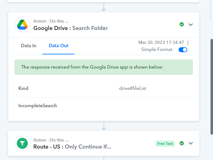

Helen Dang
Hi Arshita,
I just have run my workflow you changed. However, I'm still facing this issue. The Google Drive folder doesn't find and the next step on this rounter doesn't run. Please see my history below.
History ID: IjU3NjAwNTZjMDYzNjA0MzA1MjZjNTUzNTUxMzU1MTY2NTQzOCI_3D_pc​

Helen Dang
I have 2 actions (action 3 and action 4) after search folder on Drive.
I really want these 2 actions to perform after searching the folder on google drive, Regardless if it finds any folder. However, this doesn't seem to be possible. The process stopped completely after not finding any folders.
Please advise.

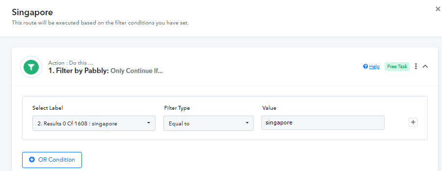

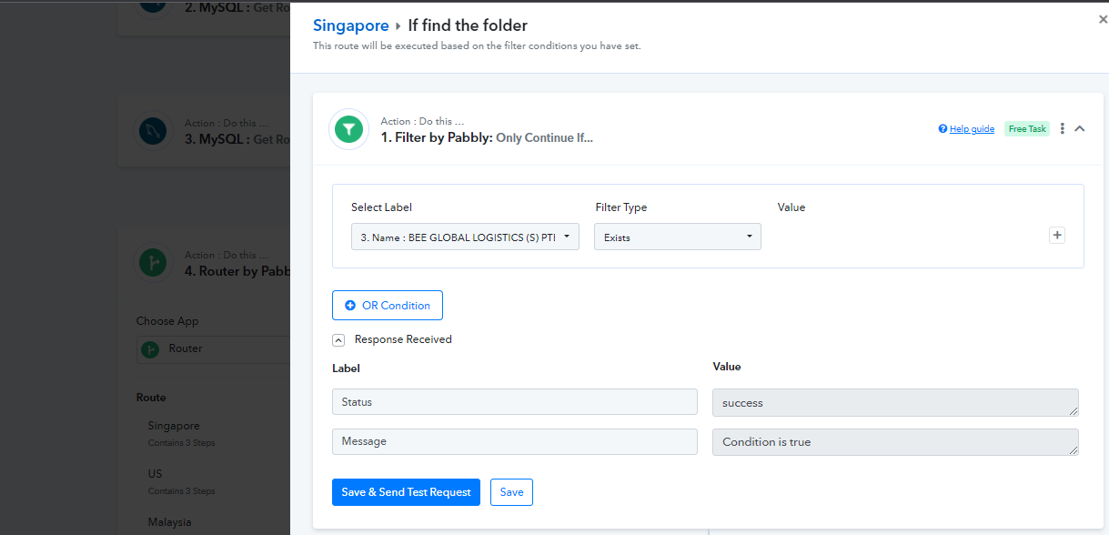

Arshita
Hey @Helen Dang
Upon reviewing your workflow thoroughly, we noticed that the filter conditions in each of the routes are different. We have reset all the filter conditions again and it appears to be working properly now.
We kindly request you to verify the filter condition in the below screenshot and confirm if it has been set correctly.

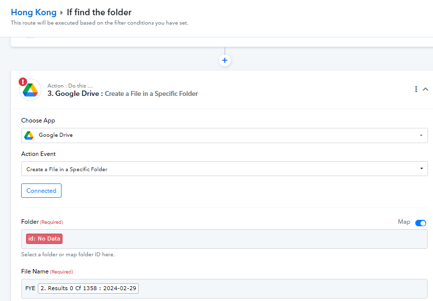

Also, based on my understanding, the folder you are trying to access is not mapped in Google Drive, specifically in the "Create a file in specific folder" step of the HongKonf > If find a folder process. To resolve this issue, please make sure that you have properly mapped the folder.
