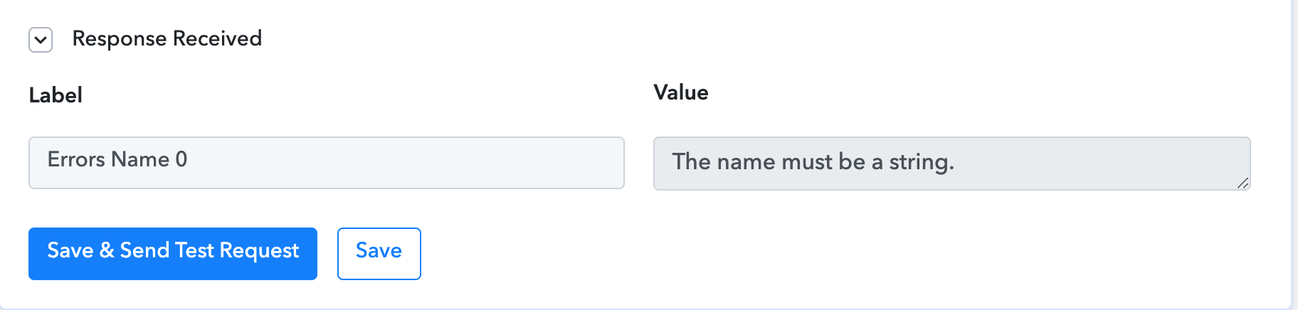

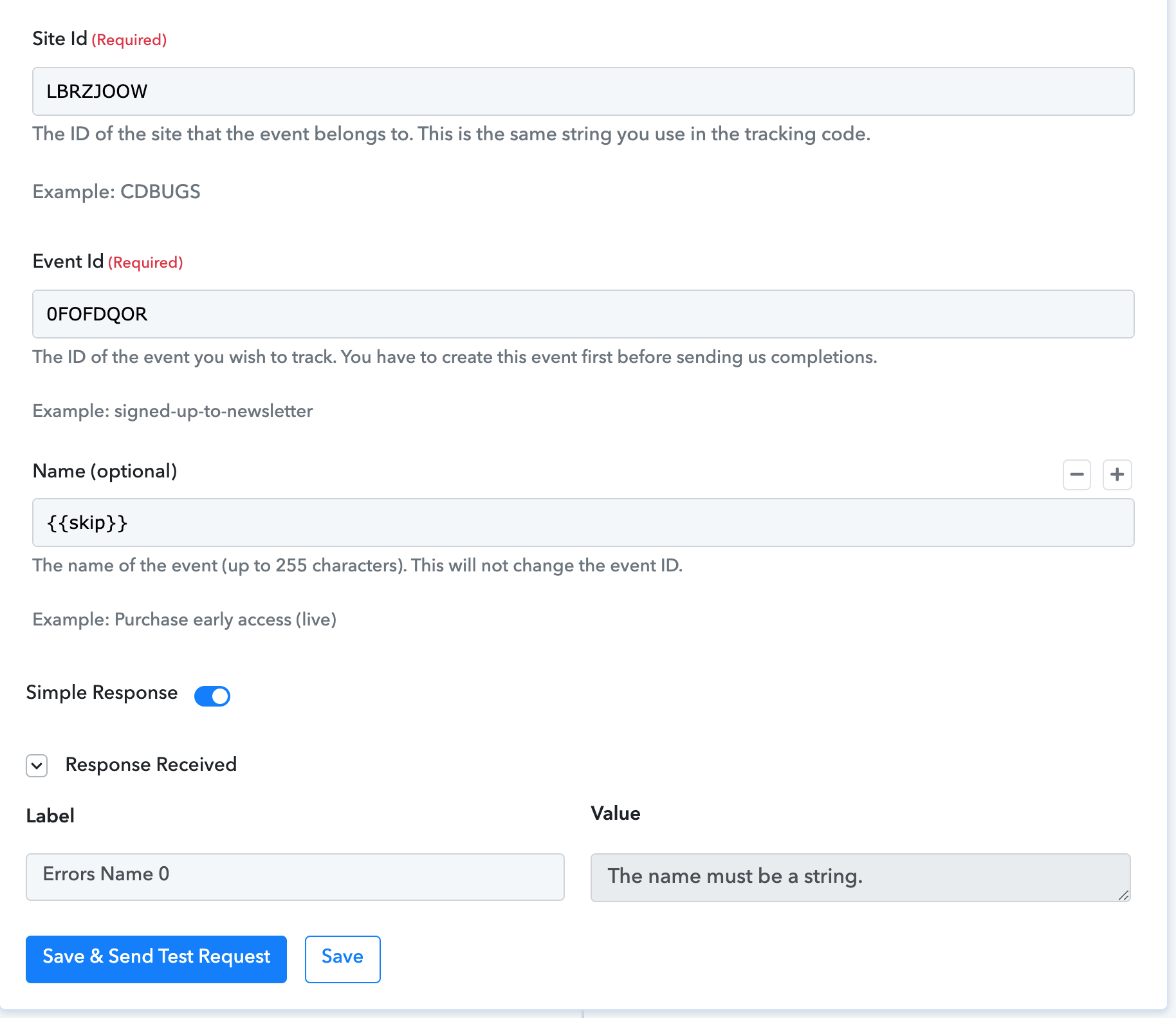

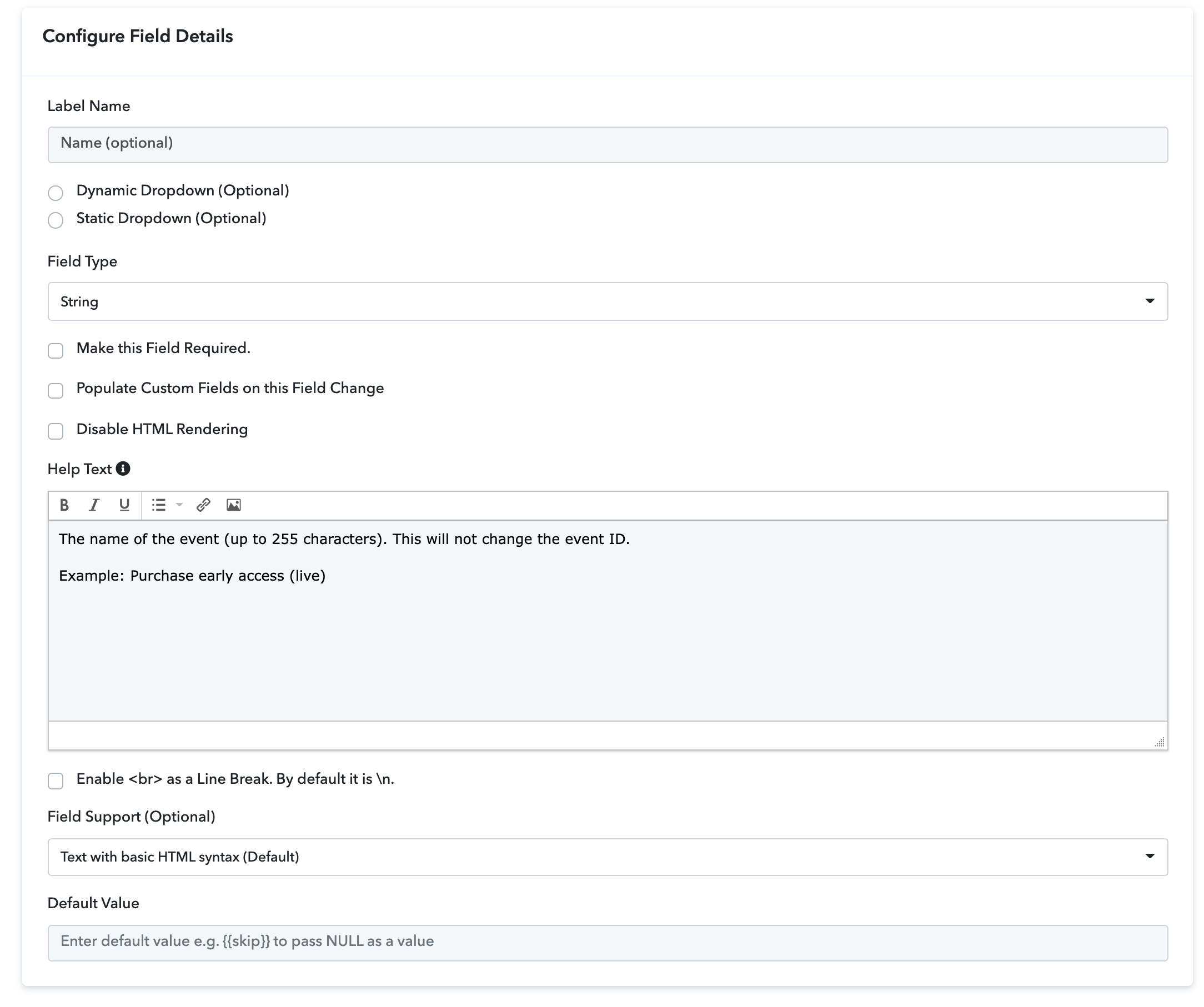

I am creating a custom app for an API in PC. With the API I am calling, I can add many optional query parameters to different endpoints. The issue I have is that when a parameter is defined, it seems that PC adds it to the http request whether there is data in the parameter or not.
I have tried adding in null and {{skip}} on the default value on the apps backend and also in the front end but the API will not accept the call as there is no data in the parameter. This API works by having any optional parameters NOT in the request.
Is there a way to have a parameter defined in the backend, but if left blank on the front end / no data is entered then it is NOT sent in the API request?
In the images attached, the name field is an optional query parameter. If you want to add to the request then you must add data else you receive an error response, if you do not want to enter a name then the parameter must NOT be in request, it cannot be left blank or null etc. There are other parameters where I need this but this is the simplest parameter to explain as it is just a text field.

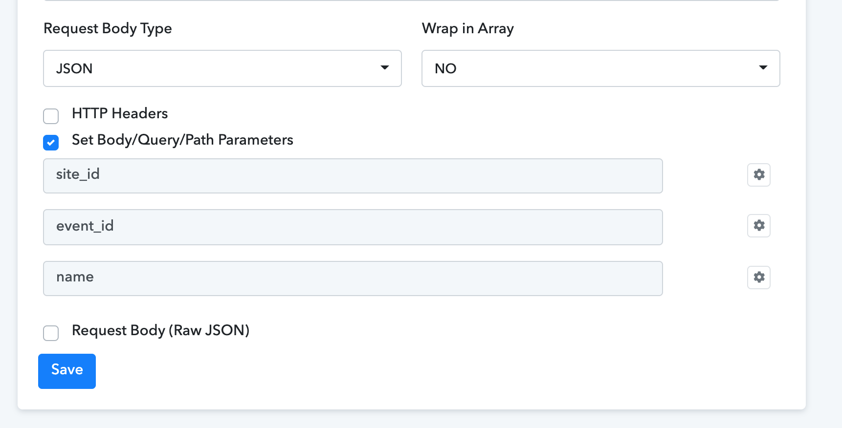

If you want to pass NOT as a default value for the name field configuration. Also, ensure that, you are using an appropriate Request Body Type for your API request, if you have a query string parameter supported API then, the Request Body Type must be either X-Url-Encoded-Form-Data or Form-Data instead of JSON.
You can also refer our Advanced Built-in Functions here: https://forum.pabbly.com/threads/advanced-builtin-functions.2431/ that can be used as default value for any parameter.
Daniel Fawcett — Reply ·
@Naveen thanks for this. the {{pc_skip_field}} is what i needed to get it working.

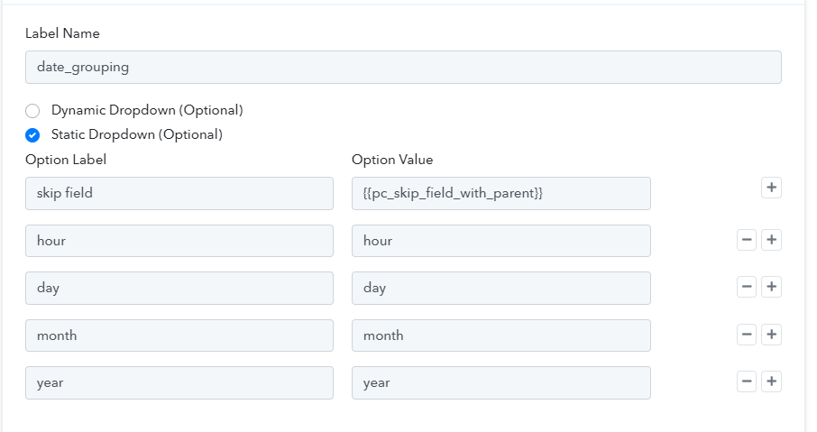

How would I have a list of dropdowns where there is a {{pc_skip_field}} as default (so no data or parameter sent in request) and then if 1 of the dropdowns is selected it sends that data.
I can't see how I can have a dropdown list without having send data as default. Below image is what i am trying to achieve but not having to have a skip field option.

The advanced functions will not be supported in the dropdown fields, you need to pass at least one default value for the dropdown field.

Ahh ok, thanks. So there is no way to have dropdown fields that are optionally sent on the request? If I have dropdowns then the parameter will always be sent?
PabblyMember3 — Reply ·
Yes, for now dropdown field option not support the pc_skip_field or any other advanced function.
