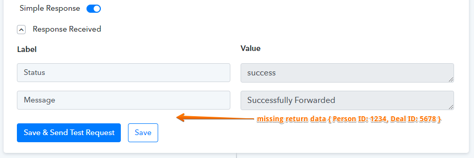

    • Receiving returned data from inner workflow
My problem is, that the outer workflow does not receive the data returned by the inner workflow.
It receives { Status: success, Message: Successfully Forwarded } – but I'm missing the additional data, which should be returned by one of the routes.

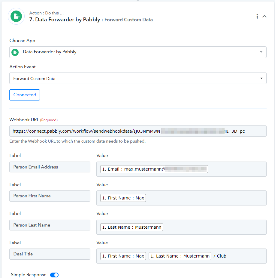

It's step #7 in the outer workflow, that uses the Data Forwarder.
Anyway, the call works perfectly. It's the return that does never happen.

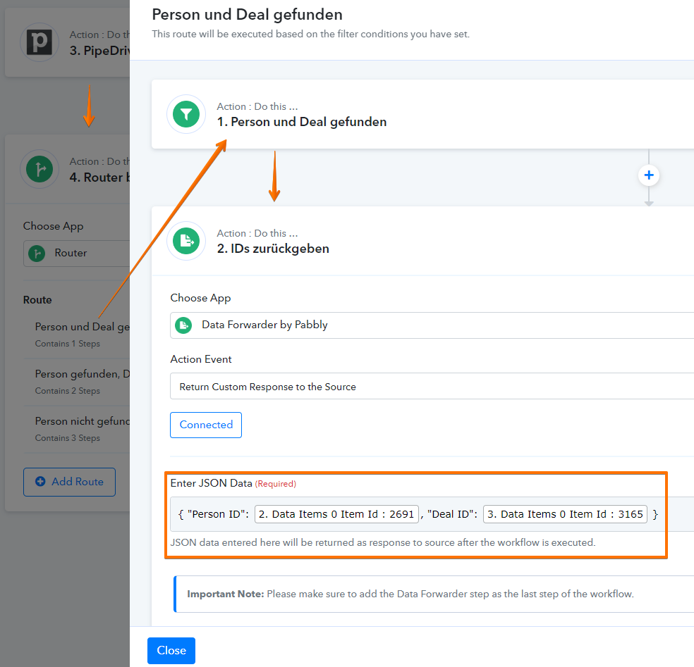

Data is returned in the inner workflow in each router condition:
Is it maybe a syntax problem of the returned JSON Data?
