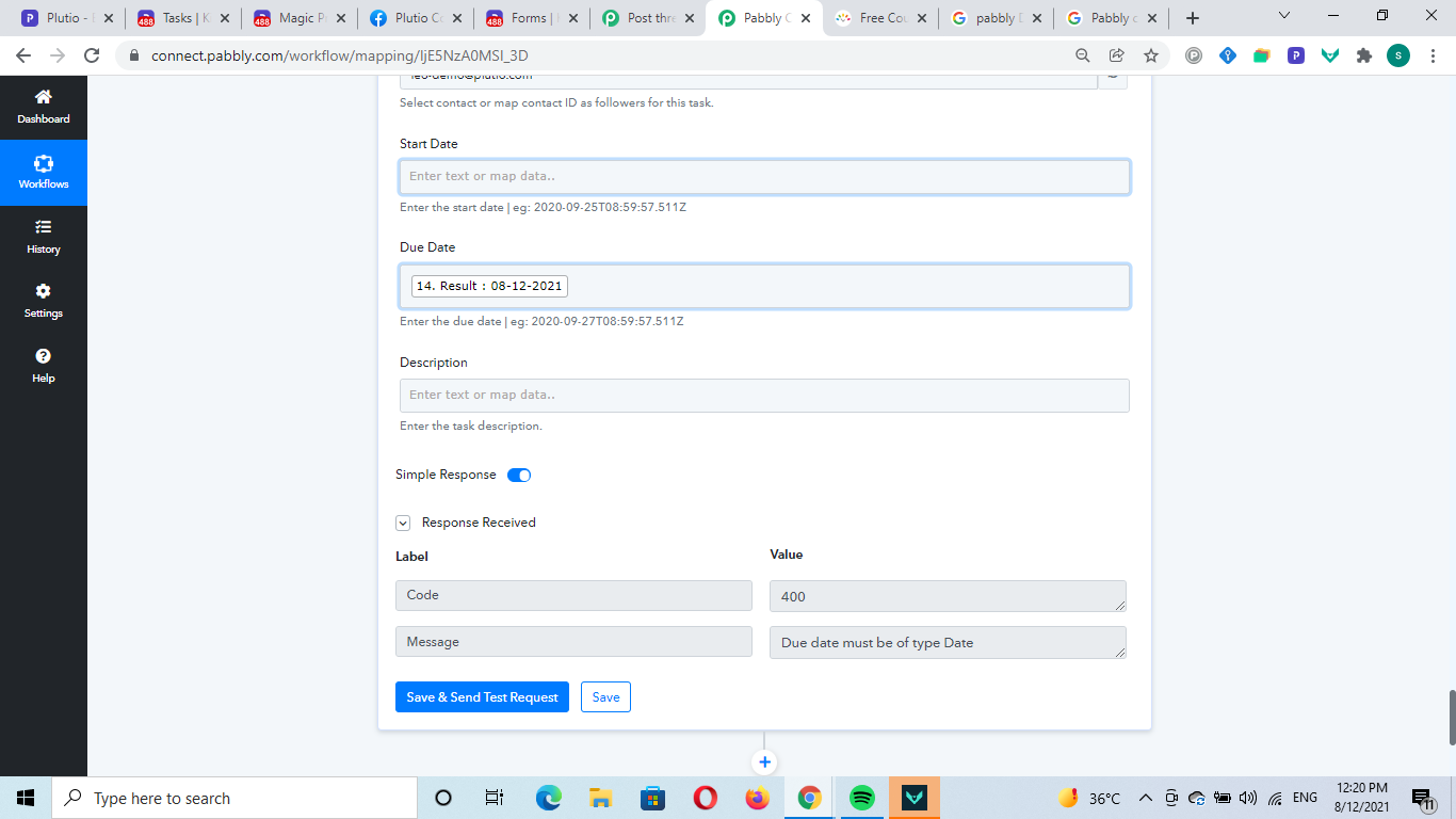

I am modifying a date with time/date modifier but when I try to utilise the modified date in the creation if a task, I get:
Due date must be of type Date

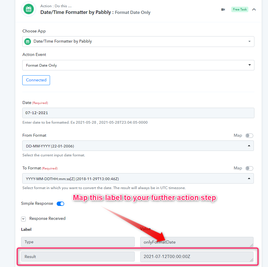

You need to provide the data in "YYYY-MM-DDTHH:mm:ss[Z]". For this, you can use the "Date Time formatter" to convert the time.

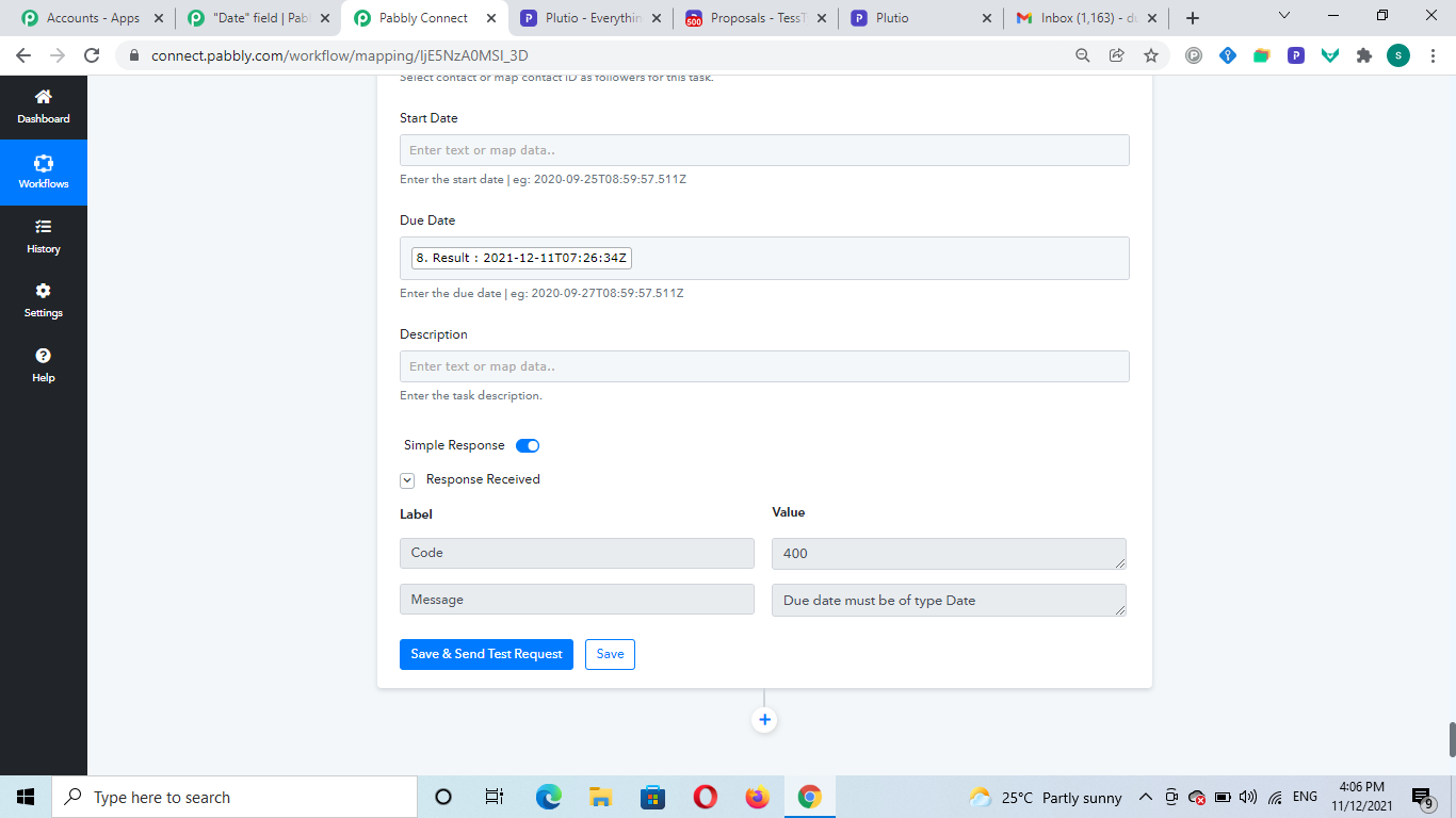

Durkis
OK, I have done this, and I have triple checked that the format is correct but I still get the error message

Hey @Durkis
The TIme which you have provided doesn't have the required time format - YYYY-MM-DDTHH:mm:ss.SSS.
Although we have set the correct date time format in your action step correctly. Kindly check that out in your workflow.

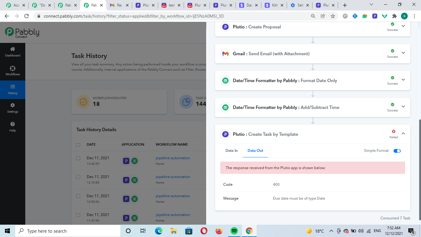

Pabbly13
Hey @Durkis !
We are not able to find the workflow in your account that has the "Plutio: Create a Task by Template" action step added to it.
In your overall history, we can see there is a deleted workflow, so we are not able to check on the workflow.
Can you please check at your end if the workflow is deleted?
Hope, to hear from you soon.

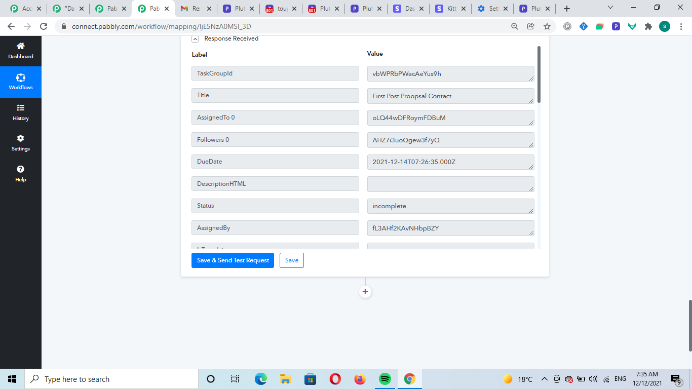

Durkis

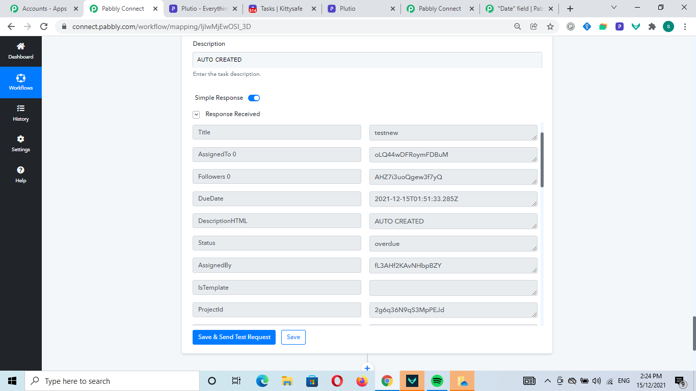

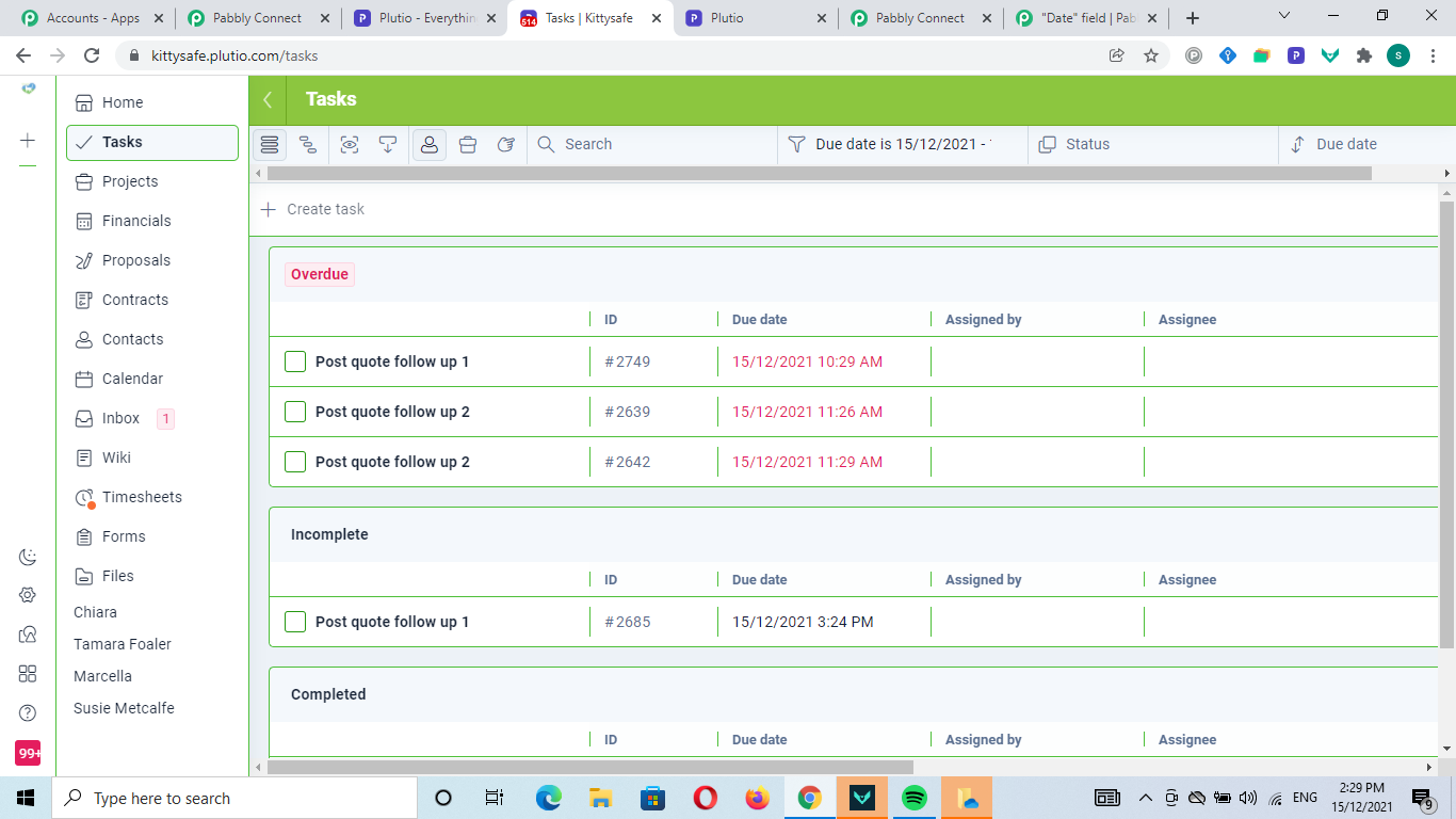

Thanks for your guidance, Hermes. Sometimes it takes me a few days to find the time to address these things. I have added this to the workflow and have been assured that it's all working by Pabbly. See screenshot. But when I go to Plutio, I can't find the task that Pabbly thinks it has created. I searched by name and due date but can't find it.
Hermes
Active member
The task has been created, I can see them. But it's indeed not visible in projects. That has something to do with taskgroups I believe (you have 30 of them in the project it should go). But I can see 6 testnew tasks in your account.
Please let me help you with the automation part, And check how I have done it.
