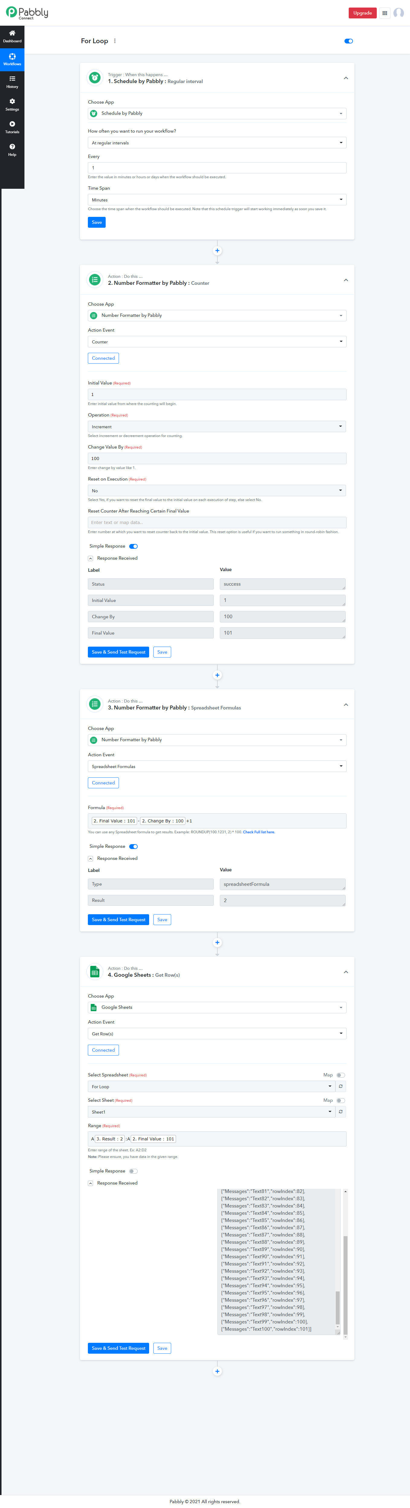

This workflow is for Picking up 100 rows every 1 minute, you can change the Every field of Schdule to 10 minutes, and Change Value field of Counter to 10 and it should work. Let me know if you need more help.
So basically you will be getting 10 rows every 10 minutes from Google SHeet, then use Iterator and add whatever you want to use after iterator step.
