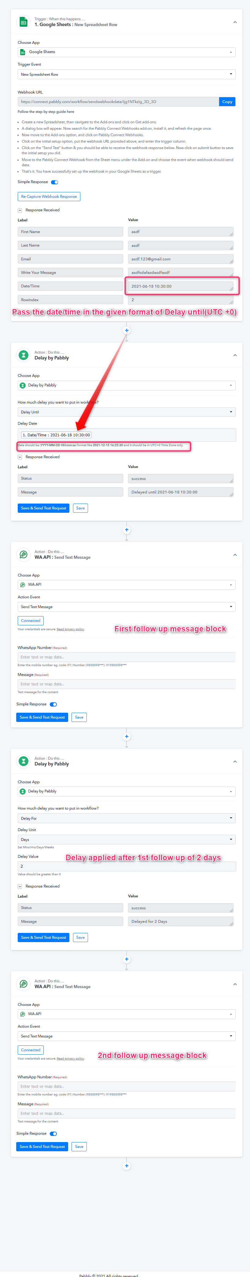

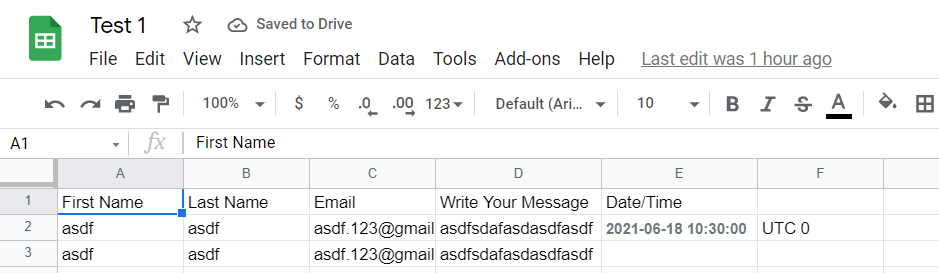

2) Second way by adding one more column with the date/time by which user must get the message -
Google Sheets Data with the time format (UTC +0)
Workflow Sample -
Workflow Sample -
