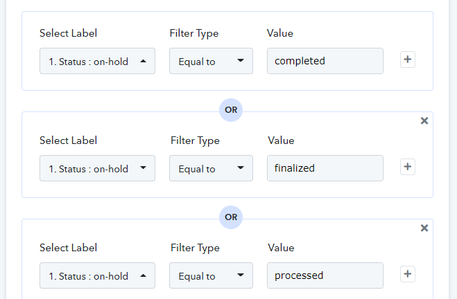

For 1st issue setup router filter with 3 "OR" conditions, so it will go ahead if any one of them is TRUE.

For 2nd use case I think you can use "Order Updated" trigger of woocommerce in pabbly connect. That way when you change status of order to cancelled it will send that order data to pabbly connect and then lookup row in Gsheet using order id and delete the row or update the row as per your requirement.
