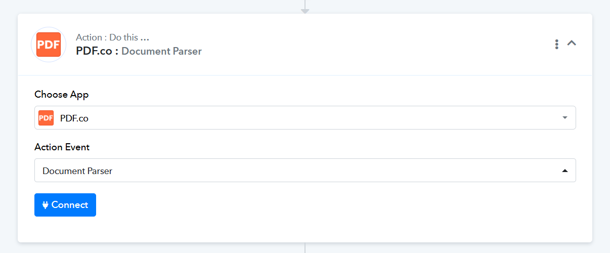

We assume that the invoice you upload to Google Drive is in PDF format. For this, you can use the 'PDF.co: Document Parser' action step, which will extract the content from the PDF. You can then pass this data to ChatGPT for further analysis. Please check if this helps you extract the necessary data. Once done, we can look into how the extracted data will be added to Google Sheets.

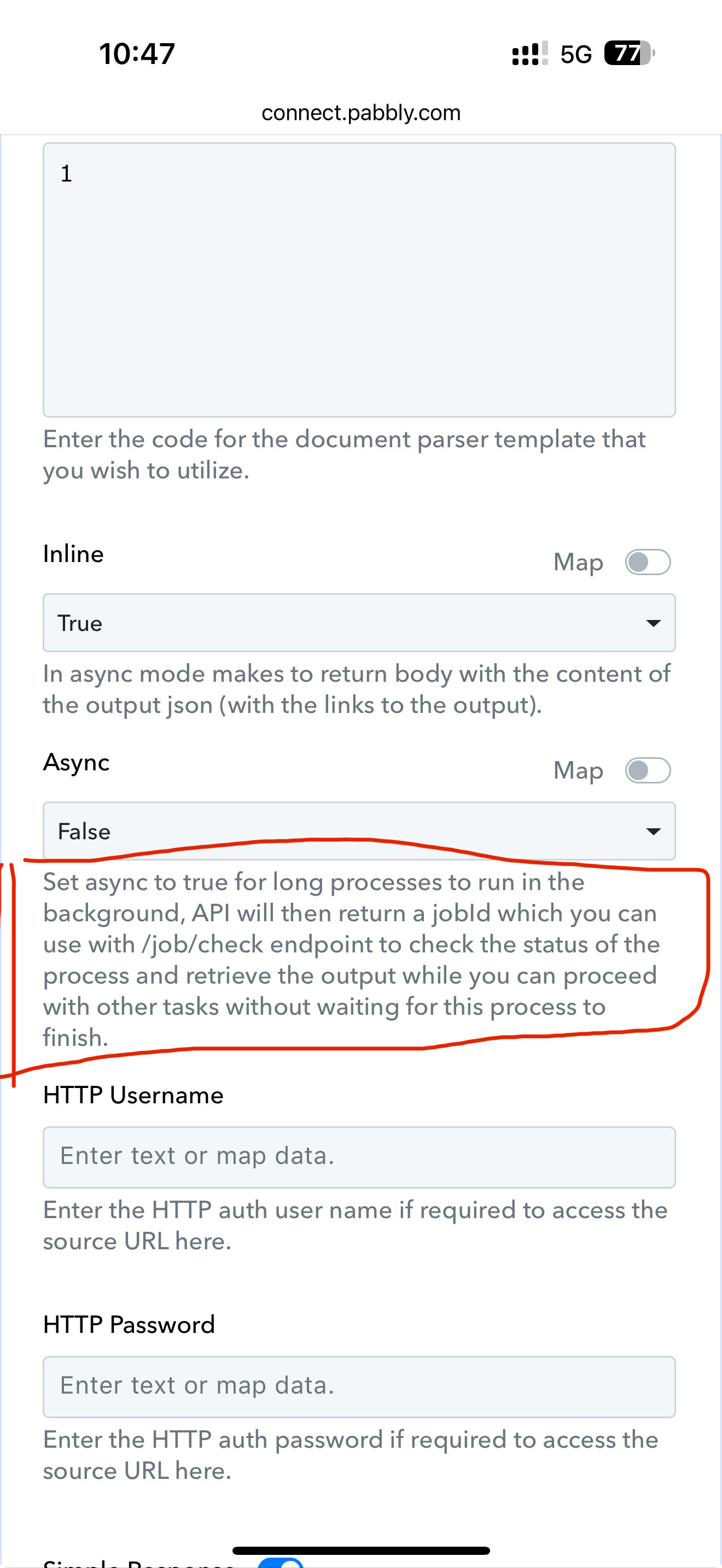

How do we do what I have highlighted from a screenshot from the workflow part of pdf.co
Hello @usman
You can select "True" from the Async dropdown, which will allow the process to run in the background while you continue with the next steps of your workflow. However, please note that if you have mapped data from the pdf.co step, an error may occur because the required mapped details may not be received

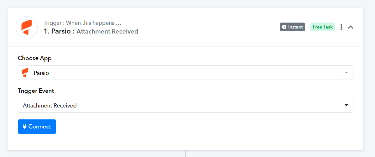

a challenge i am facing is the size of the attachement in the email to be parsed, adn then there are emails with multiple attachments. any way to increase the size of the attachments by the email parser. and how do i handle multiple attachments.
I am afraid it is not possible to increase the attachment size in the Email Parser. You can try using the 'Parsio: Attachment Received' trigger step to fetch a larger attachment.
