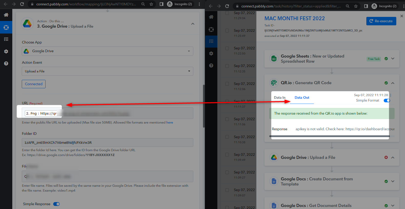

Hello Maxim DMello,
This email is to notify you that for the workflow "MAC MONTHI FEST 2022" , a recent task was not executed due to following error -​
Task History ID: IjU3NjYwNTY5MDYzNDA0Mzc1MjZjNTUzMzUxMzY1MTY2NTQzNiI_3D_pc
Step Name: Google Drive > Upload a File
Task Error Detail:
"status": "error",
"message": "Required field URL missing. Learn more: https://forum.pabbly.com/threads/how-to-fix-required-field-is-missing-errors-in-pabbly-connect.7488/"

HEy @Maxpres
As we can see from your task history Id since your" QR.io : Generate QR Code" action step didn't produce the image file URL because of that the "Google Drive: Upload a File" action step didn't work which was required to upload the file.

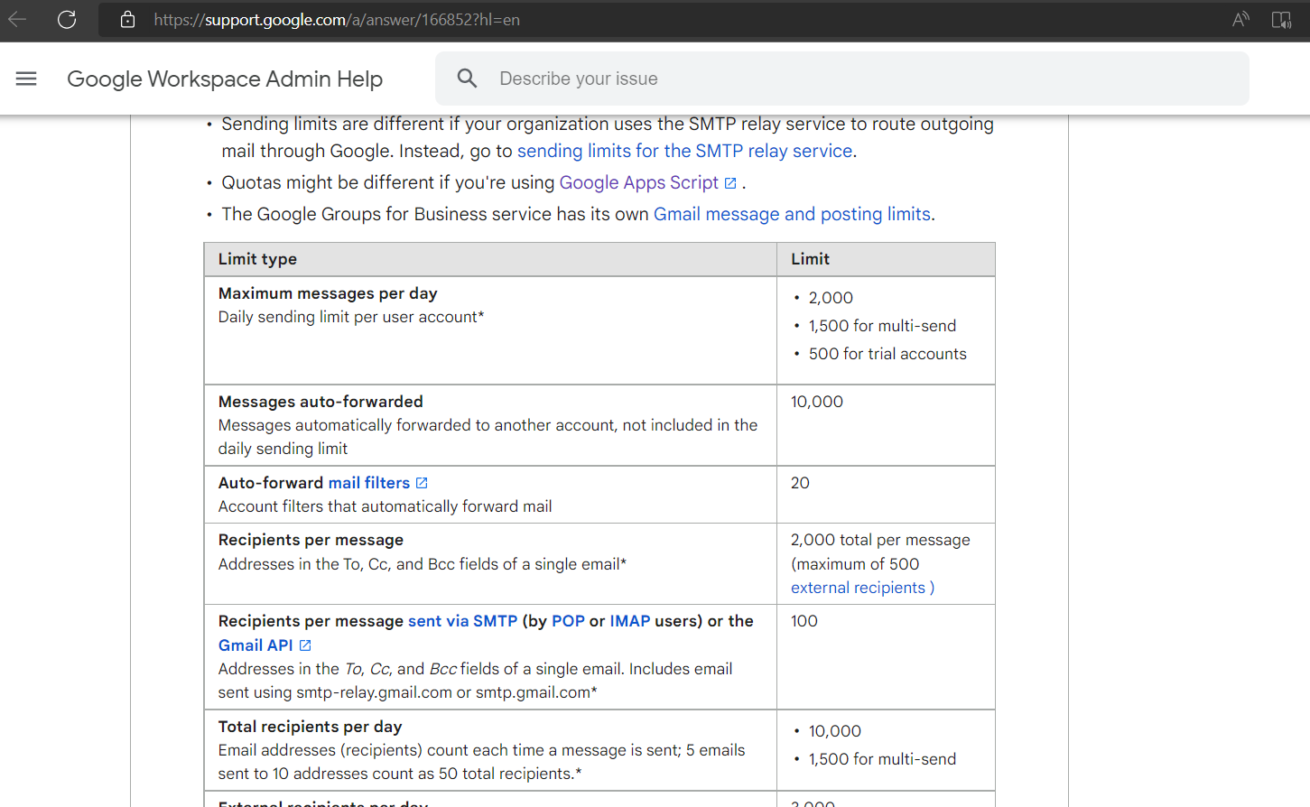

Hey @Maxpres
The limit of sending the emails from the Gmail is defined and if you exceed the limit then the Gmail API doesn't allow you to send the emails.
Though you can check the Gmail documentation, for the quota on how much you can send emails in a day.
