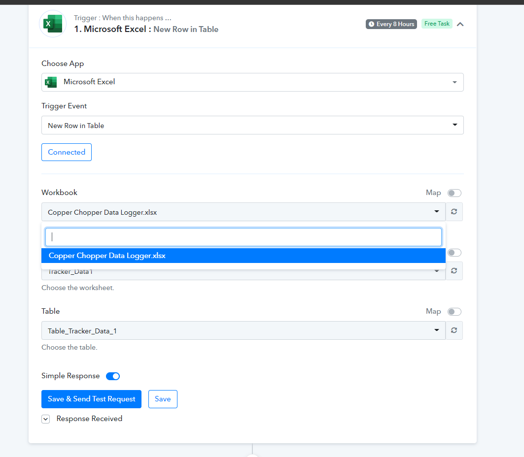

I am not sure a video will show it but here is a screen shot.
In the same one drive folder as Copper Chopper Data Logger.xlsx there is a file called Copper Chopper Data Logger.xlsm and nonmatter what I have done the xlsm file will not show up on this drop down.
I do have a secondary issue with this work flow also. When I made the workflow and press the save & Send test request I get the first line of date just like the video. However after waiting the 8 hours (24 actually) no additional data is transferred from my excel sheet to my google sheet.

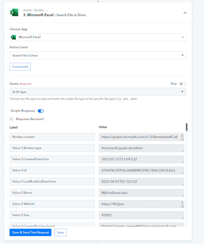

Since the MS Excel trigger event only list the workbook which is of xlsx type.

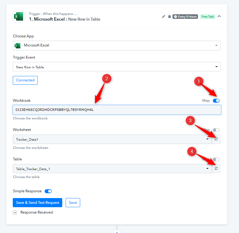

So, as a solution, we would recommend using the "Search File in Drive" action step once to receive the Id of the workflow from your One Drive and that WorkBook Id you can pass it on the Trigger events' workbook field.
