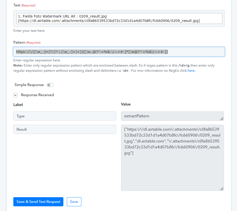

And i want to extract using below regex:
https:\/\/([\w_-]+(?:(?:\.[\w_-]+)+))([\w.,@?^=%&:\/~+#-]*[\w@?^=%&\/~+#-])
What is got from the result is like this below:
["https:\/\/dl.airtable.com\/.attachments\/c0fa86539533bd72c33d1d1a4d07b8fc\/fc660906\/0209_result.jpg","dl.airtable.com","\/.attachments\/c0fa86539533bd72c33d1d1a4d07b8fc\/fc660906\/0209_result.jpg"]

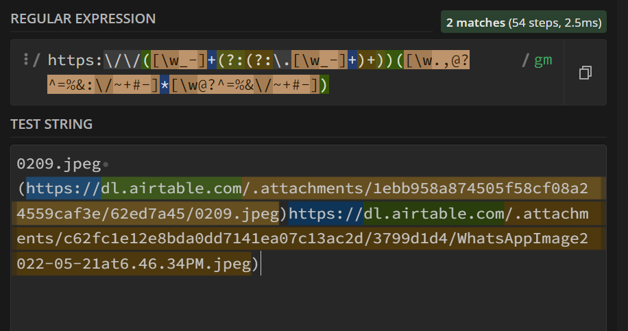

From REGEX 101, i got the result i want:

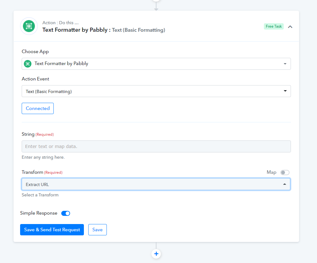

Hey @Kenny
If you want simply want to extract the image URL from the text then you can use "Text Formatter by Pabbly: Text (Basic Formatting)" which will extract the URL for you.

Hey @Kenny
I have 3 to 5 urls. Will this work?

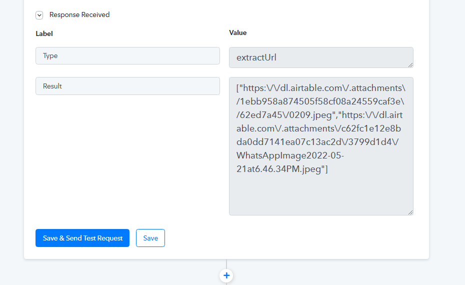

it looks like this:
How can i perform join array and return the text?
Hey @Kenny
Since you are getting the response in advance the URL is in the array, so you can use the Iterator action step or Line Itemizer action step in your workflow to get it once by one or in commas separated.

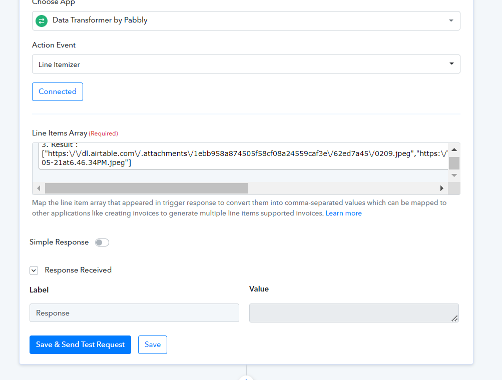

Line Itemizer does not work
PabblyMember3 — Reply ·

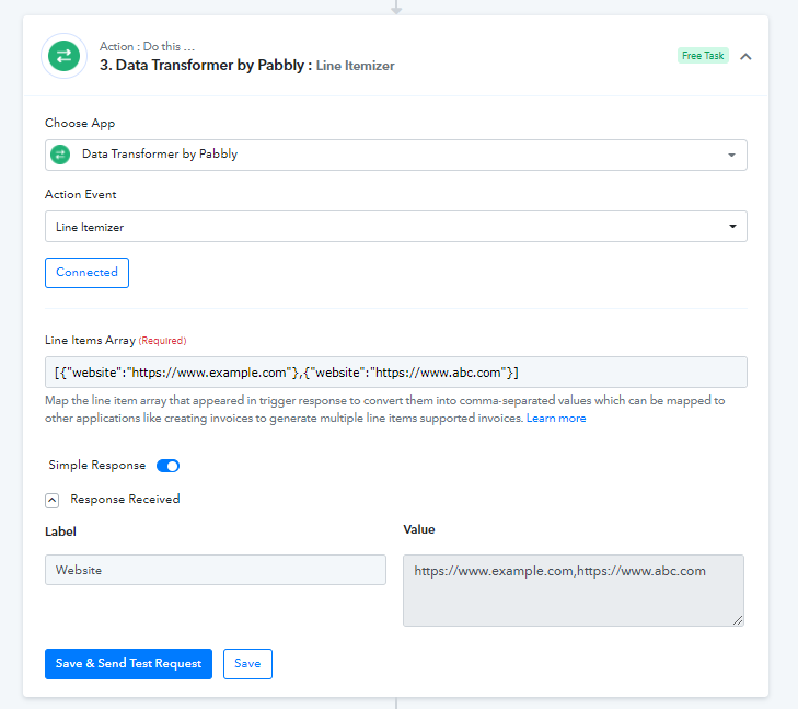

Line Itemizer accepts an array of objects with identical keys. It won't work with the direct array of avlues.
Please pass the array of objects with proper keys as shown in the above screenshot. It will work.

There is a bit difference in the result. Also, I've checked the same https://www.phpliveregex.com/ and it shows a different result.
I would request you try a different REGEX to obtain the expected result.
