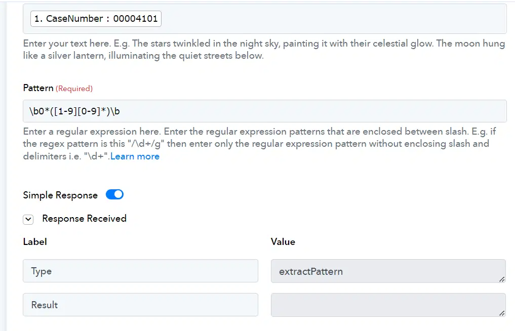

hello,
i have a series of number as follow:
00004101
00023489
00134939
I would like to remove all leading zeros.
i have tried this \b0*([1-9][0-9]*)\b
but it doesnt work.
can somebody help?
thanks

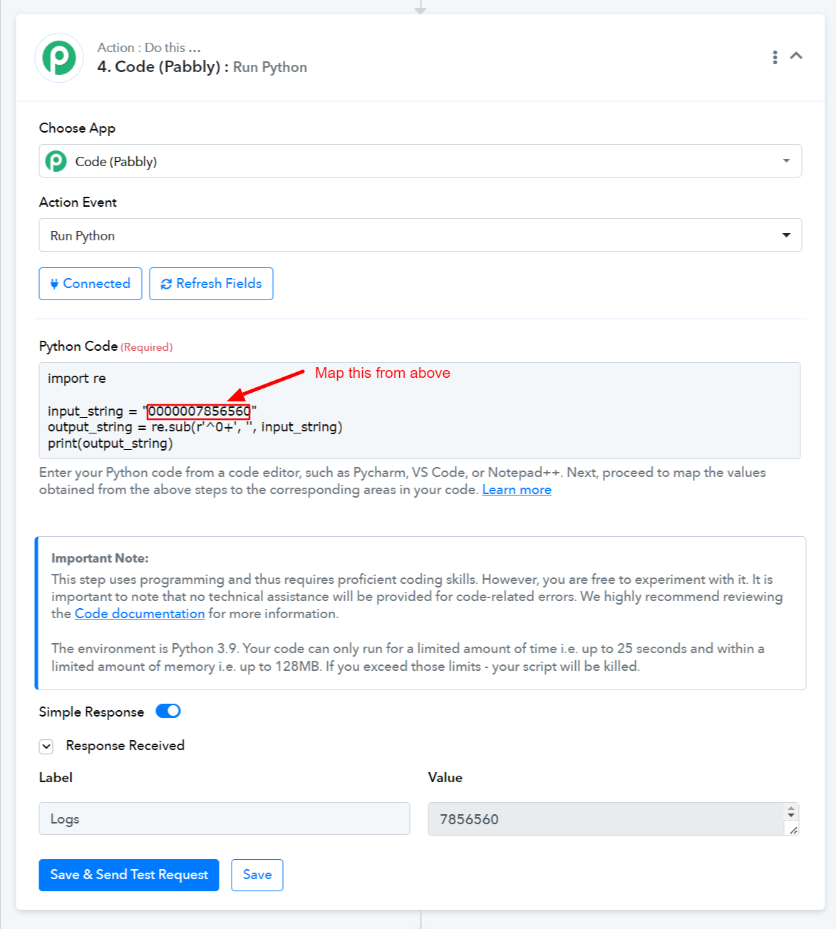

Please try using Code by Pabbly to run this Python code, which will help you remove the leading zeros.
import re
input_string = "0000007856560"
output_string = re.sub(r'^0+', '', input_string)
print(output_string)
