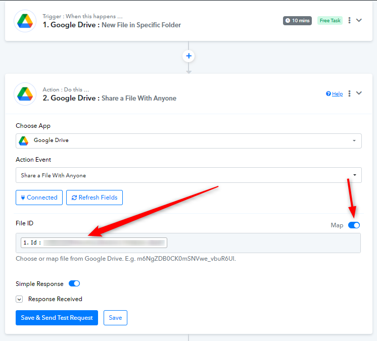

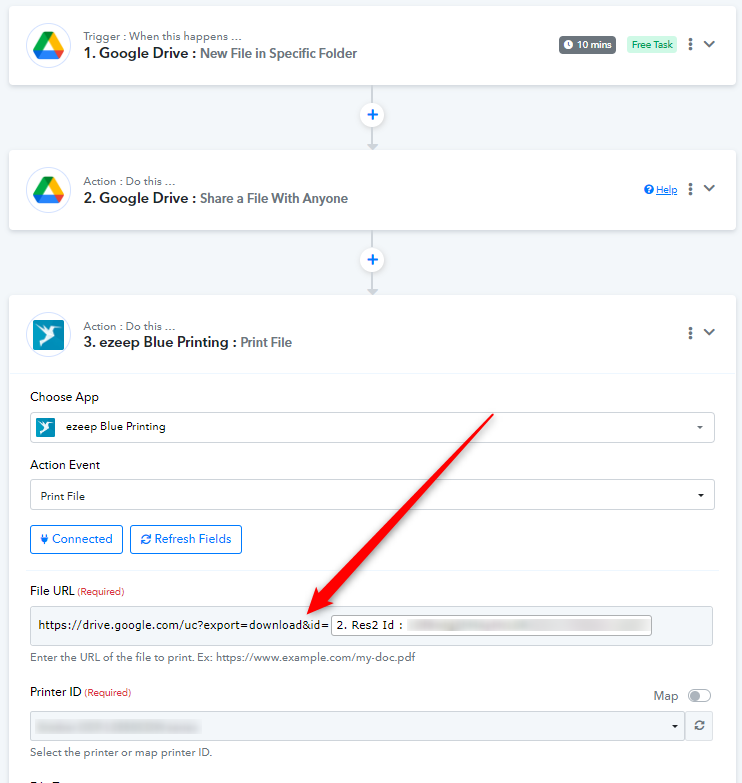

Hey @Jordan Darlison
Kindly use a permanent download link instead of the share link. Refer to the image below.
Also, you haven't mapped the "File ID" from the previous step in the "Share File with Anyone" action step. Kindly set your workflow accordingly and let us know in case you face any further issues.

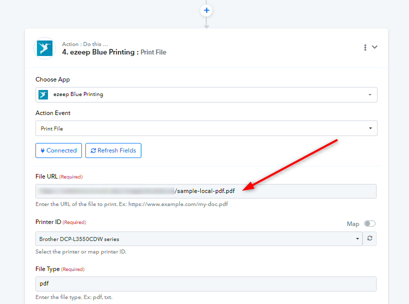

Upon looking into the issue a bit more, we can conclude that you will need a '.pdf' link, instead of a Google Drive share or download link. Kindly have a look at the image below,
You can use PDF Monkey for generating such link. Kindly watch the video below from 10:15 for further instructions.
