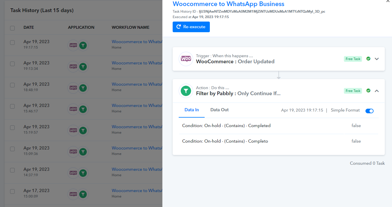

I'm using Woocommerce and I have a filter in which I look for the status: COMPLETED is EQUAL TO and then I select from the value field where the transaction status is received and I select also the COMPLETED value.
The filter keeps deleting the Value field and that makes the Order be processed and sent to WhatsApp which is wrong. The process should ONLY run when Status is "Completed" and no other else.
I even set different filter types to CONTAINS and EXISTS and the process keeps running like there is no filter at all.
Please review my issues as soon as possible.
Hey @Desarrollo Swiitch
According to the workflow history log, it appears that the Filter action step is performing as intended. Only the data for orders with the status "Completed" is processed all other orders with the status "On-hold" are blocked.
Thank you. I found the problem. My error was that I was looking for the value "completed" against a field that happened to be empty by default. Therefore when an Order arrives the supposed required value from Order updated options would arrive with any value and that would make the process run as well.
I ended up manually typing the value I was looking and that solved things. So far... everything works correctly.
