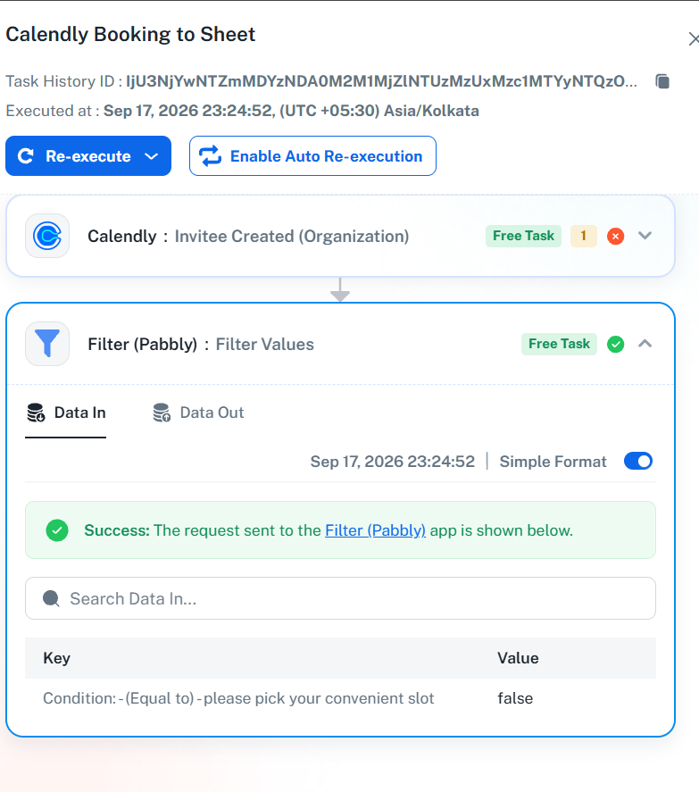

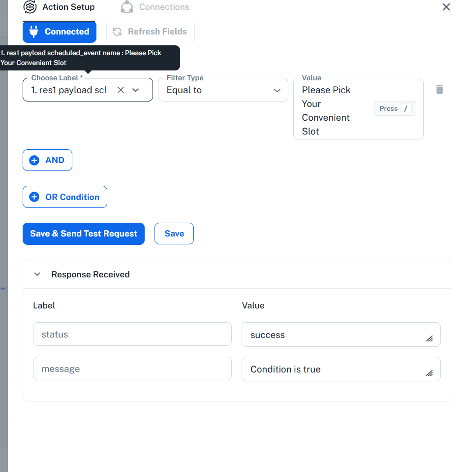

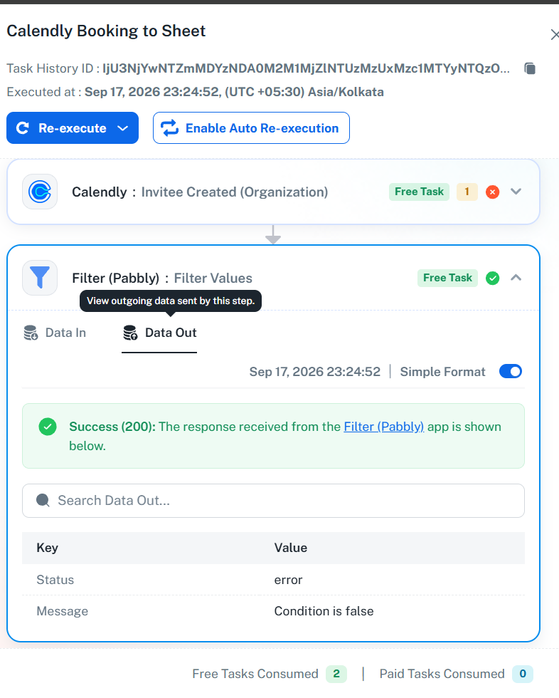

I am setting app filter step after calendly event create by event name, builder shows tru but in realtime history it shows false.

Thanks for reaching out and for sharing the screenshots.
We have captured the response received as a task trigger in the Trigger step of the workflow, the payload has a different label that is why the Filter and subsequent actions won't execute.

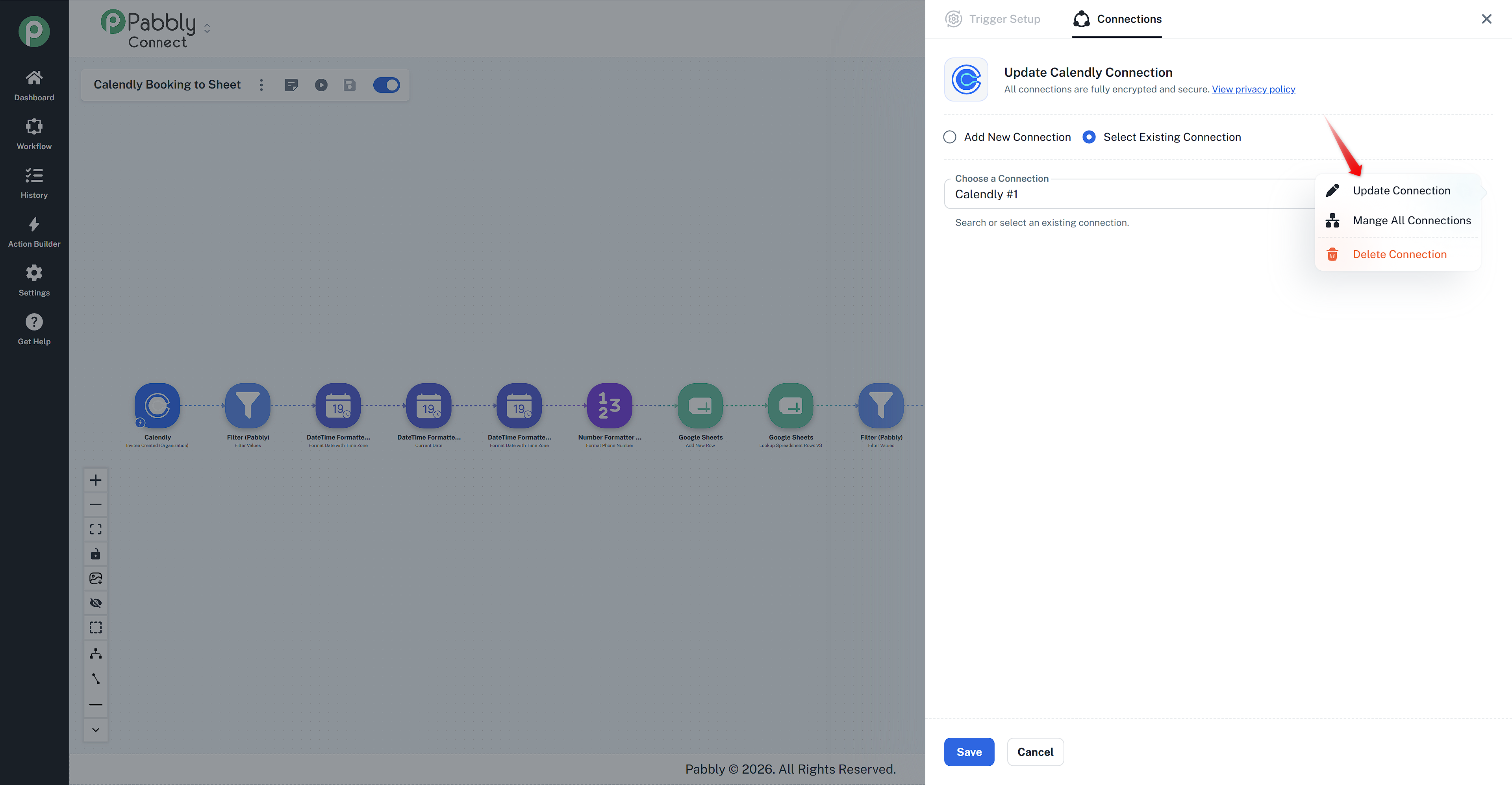

We captured the Response G from the actual task; now update the mapping of the entire workflow.
Also, update the Calendly connection as the connection token is expired.
