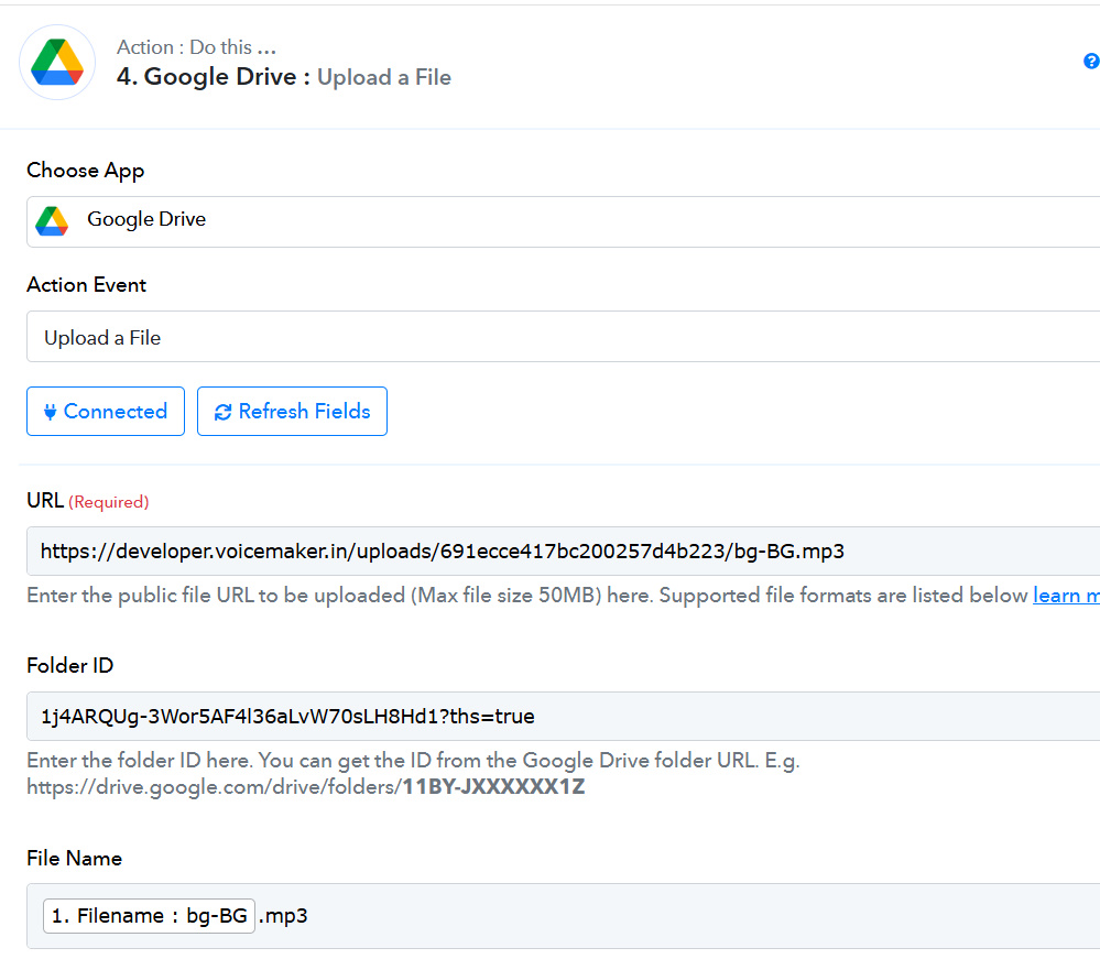

I created a Google Drive connection, entered all the required data fields as requested.

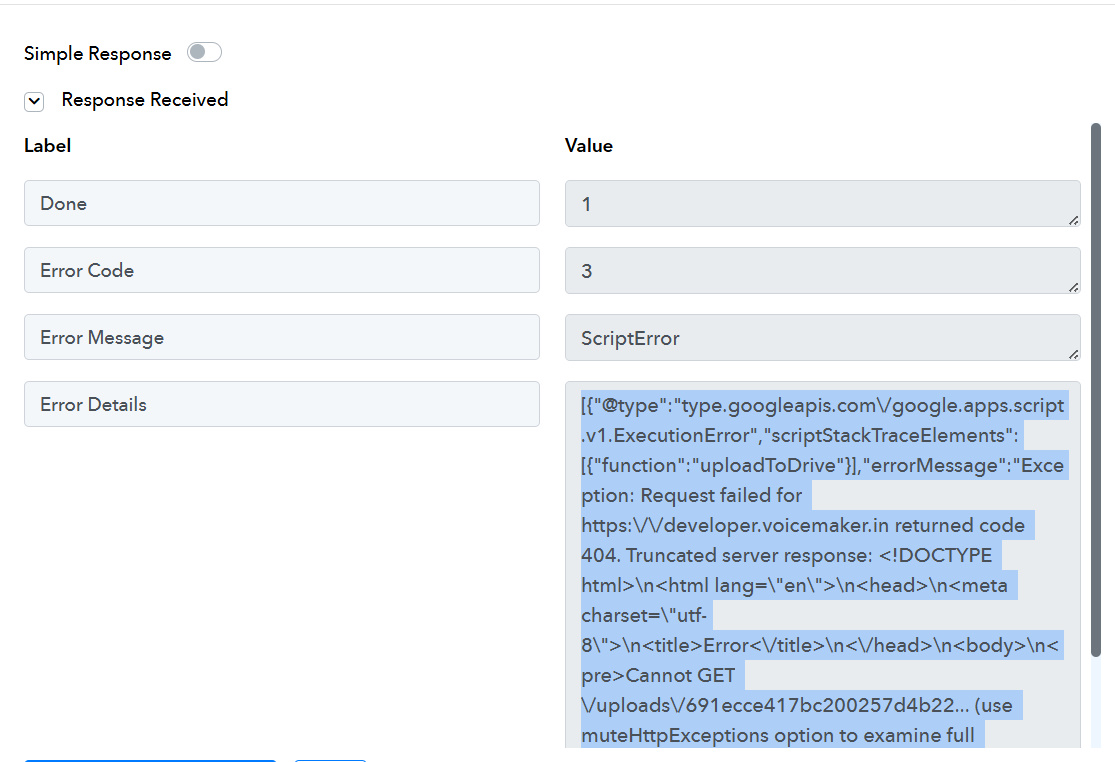

My workflow does not complete correctly.
This is the error message I get.
[{"@type":"type.googleapis.com\/google.apps.script.v1.ExecutionError","scriptStackTraceElements":[{"function":"uploadToDrive"}],"errorMessage":"Exception: Request failed for https:\/\/developer.voicemaker.in returned code 404. Truncated server response: <!DOCTYPE html>\n<html lang=\"en\">\n<head>\n<meta charset=\"utf-8\">\n<title>Error<\/title>\n<\/head>\n<body>\n<pre>Cannot GET \/uploads\/691ecce417bc200257d4b22... (use muteHttpExceptions option to examine full response)","errorType":"ScriptError"}]
Can you pinpoint the reason for the error?

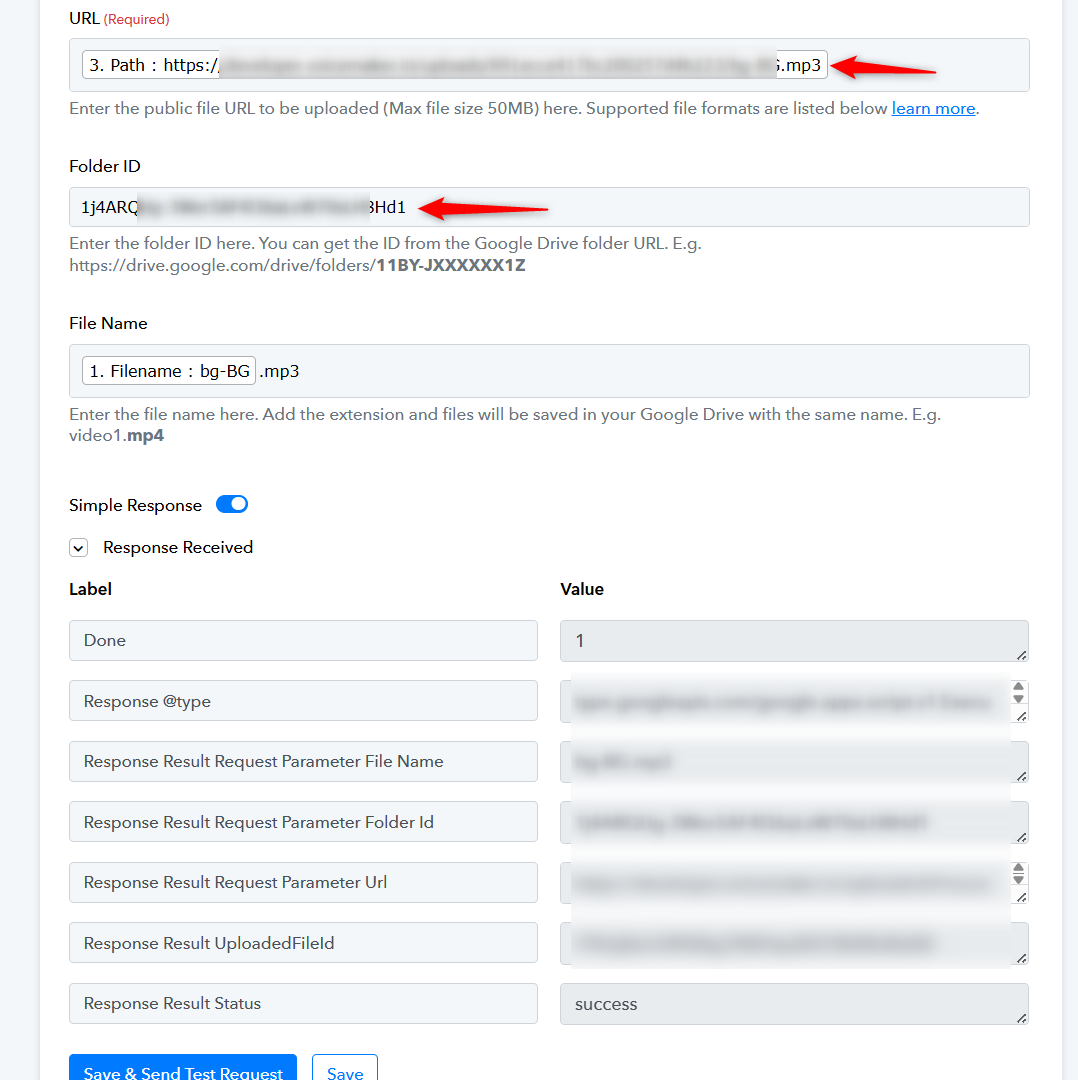

Hi @tnelms58,
We recaptured the file in the Voicemaker action step and then mapped it to your Google Drive action step. We also made a small change in the Folder ID, and it appears to have fixed the issue.
