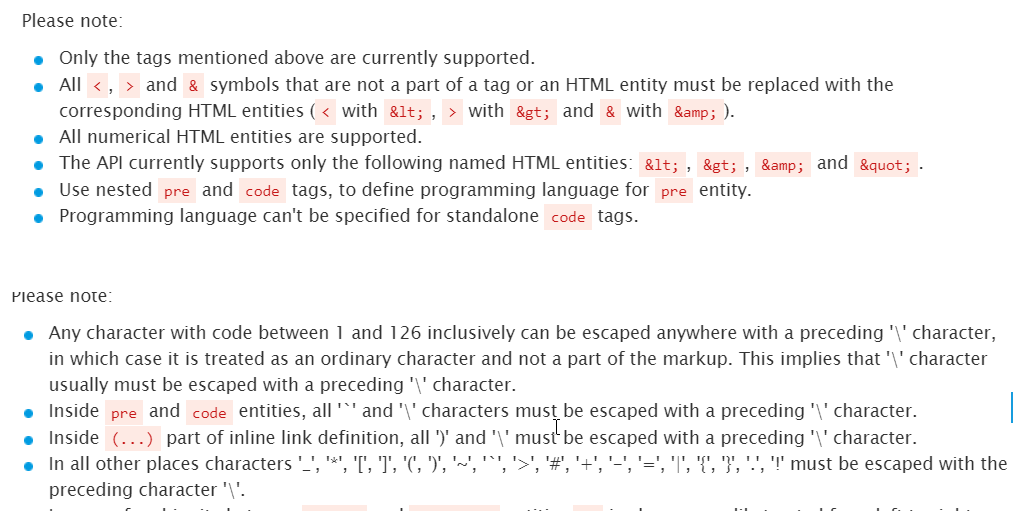

I'm trying to create a workflow to send new WordPress posts to Telegram. Most of my post titles contain the "." (full stop) character, and because of this, I'm getting the error that says:
Bad Request: can't parse entities: Character '.' is reserved and must be escaped with the preceding '\'
Problem is, how am I suppose to escape the character? I can't possibly add "\" to the post title or it they will look weird on my website.
See screenshot: https://nimb.ws/6y5EOm

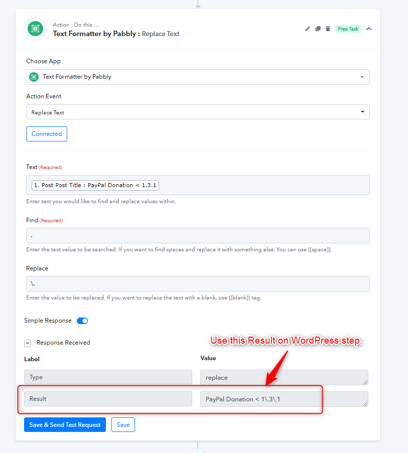

This message is coming back from WordPress to add a \ in front of a dot "." to allow the dot to pass into the title.
If you add a slash, it will not be published but will allow dot to pass into the title.
Here is what you can do.
In your current title. Replace all instances of dot "." with slash dot "\."
and than use that string on your WordPress step.
You need add a new step above the WordPress step as shown below.

Thank you Neeraj for the quick reply. I was happy to learn that I could use the text formatter step to escape the dots, the I realized I was supposed to escape many other symbols too! Does it mean I need to create a dozen of text formatter just so I can make this work? This doesn't sound much improvement of productivity to me...

Yes Please! - Bumping up a better way to do this. Even for Telegram HTML / Markdown, there is a whole bunch of Symbols to escape and replace
@Supreme Would there be a better way then adding multiple steps to escape each symbol? - thanks!
Unfortunately, there is no other way to escape such characters, so you need to use the Replace Text action step to replace such characters before passing the content.
