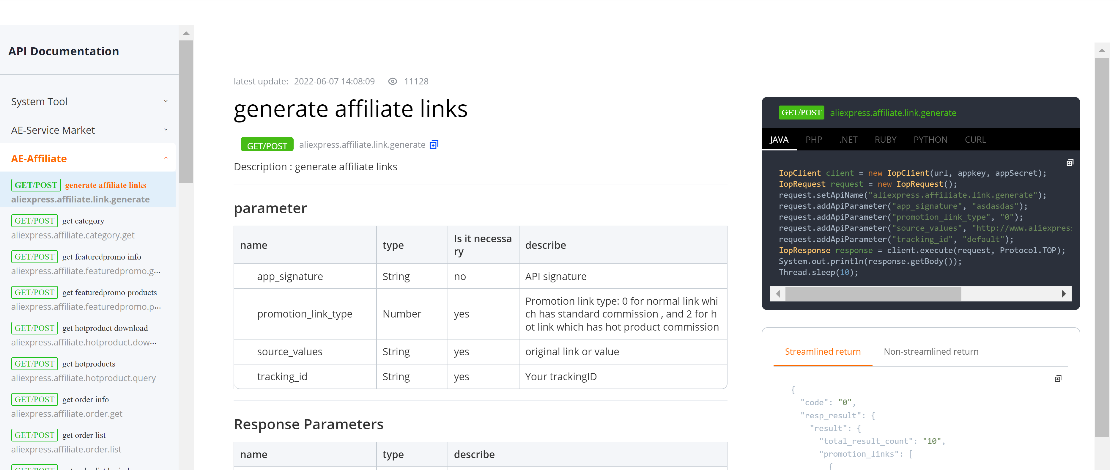

i only have 1 workflow and the last step is the step with telegram bot that i would like it to send an aliexpress URL to telegram and convert it to my affiliate link using my API.
i attached aliexpress api backend

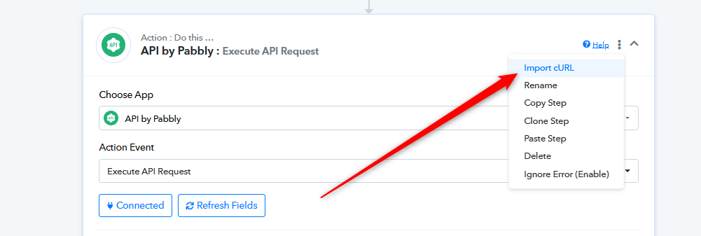

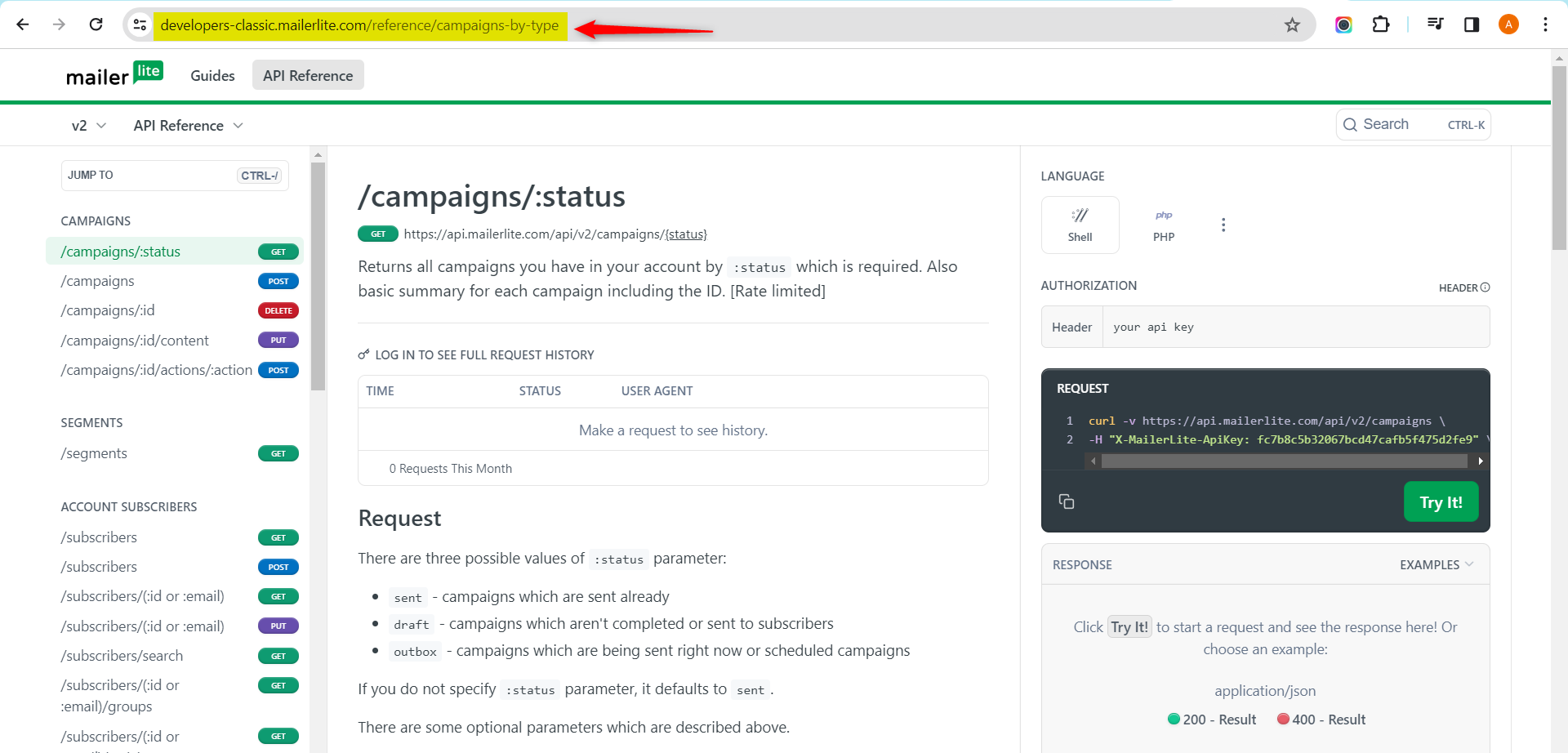

In the video shared below, our video team member is trying to execute an endpoint related to Mailerlite. In this video, she is referencing Mailerlite's API documentation to set up the endpoint.
So, this would be the API documentation of the application she is trying to connect using API by Pabbly:
I need you to share the API documentation of the application you are trying to connect to using API by Pabbly in a similar manner.
ArshilAhmad
Moderator
Thank you for sharing the API documentation. Please allow me some time to discuss the possibility of this use case with my team. We will get back to you with an update soon.

I couldn't discover an alternative method for making this API request. We suggest that you test the API reference using the Postman application first. If it works in Postman, you can then import the CURL request and use it with the Pabbly action step in the API.

Kindly try this CURL request in your workflow once and then check.
curl --location --globoff '{{url}}/aliexpress.affiliate.link.generate' \ --header 'Content-Type: application/x-www-form-urlencoded' \ --header 'charset: utf-8' \ --data-urlencode 'app_key=12345678' \ --data-urlencode 'timestamp=1712125822133' \ --data-urlencode 'sign_method=sha256' \ --data-urlencode 'sign=D13F2A03BE94D9AAE9F933FFA7B13E0A5AD84A3DAEBC62A458A3C382EC2E91EC:' \ --data-urlencode 'app_signature=asdasdas' \ --data-urlencode 'promotion_link_type=0' \ --data-urlencode 'source_values=http%3A%2F%[URL='http://2Fwww.aliexpress.com']2Fwww.aliexpress.com[/URL]%2Chttp%3A%2F%[URL='http://2Fwww.aliexpress.ru']2Fwww.aliexpress.ru[/URL]' \ --data-urlencode 'tracking_id=default'
