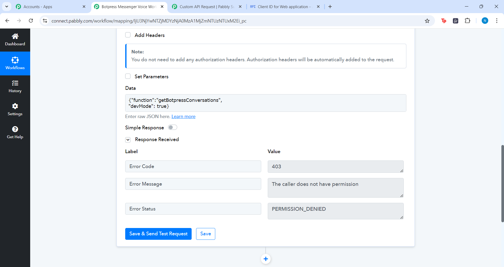

What I intend to achieve is triggering my Google App Script's function to run first, before I attempt to search for the information i need in the Google Sheet. But I keep getting 403 The Caller Does Not Have Permission error

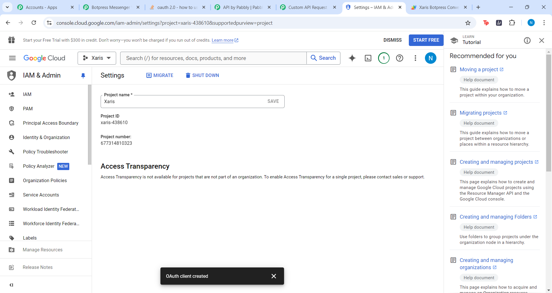

I did follow this to set up my google console project. https://forum.pabbly.com/threads/google-sheets-developers.21239/

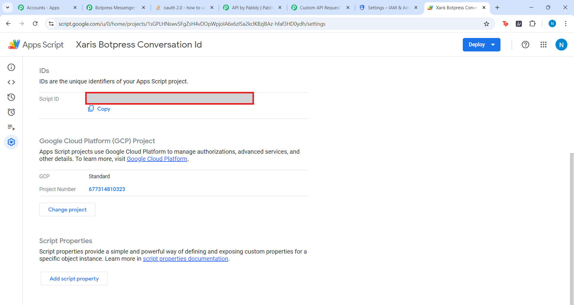

I had also made sure that my google app script is set up correctly into the same google console project as well (https://developers.google.com/apps-script/api/how-tos/execute), here is the screenshot of my google app script project details
It is the same project number...

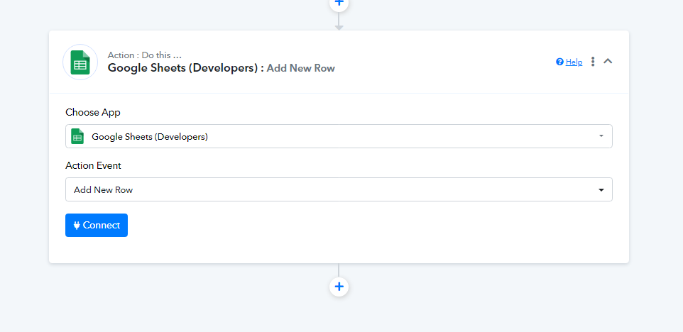

Upon reviewing the workflow, we noticed that you used Google Sheets instead of the Google Sheets Developer application. Please try setting up the workflow using the Google Sheets Developer Application to see if the issue persists.

Could you kindly provide us with the proper CURL request along with the API documentation so that we can investigate the issue?

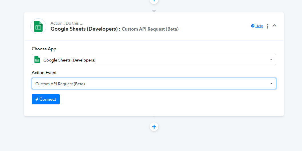

the reason I am using Google Sheets because Google Sheets (Developers) dont have custom api request (beta). or else, can you guide me how to use google sheets (developers) and still send a curl to google with the same google account that i given access to google sheets (developers)?
like, do i use google sheets (developers) and then next step i use API (Pabbly) and it will automatically be using the authenticatino from google sheets (developers)?
CURL request: https://script.googleapis.com/v1/sc...jwM-yaHKkxJvcUeKtUS37yH4Cw0udjZb_OV_T3aTB:run
parameters: {"function":"getBotpressConversations"}
