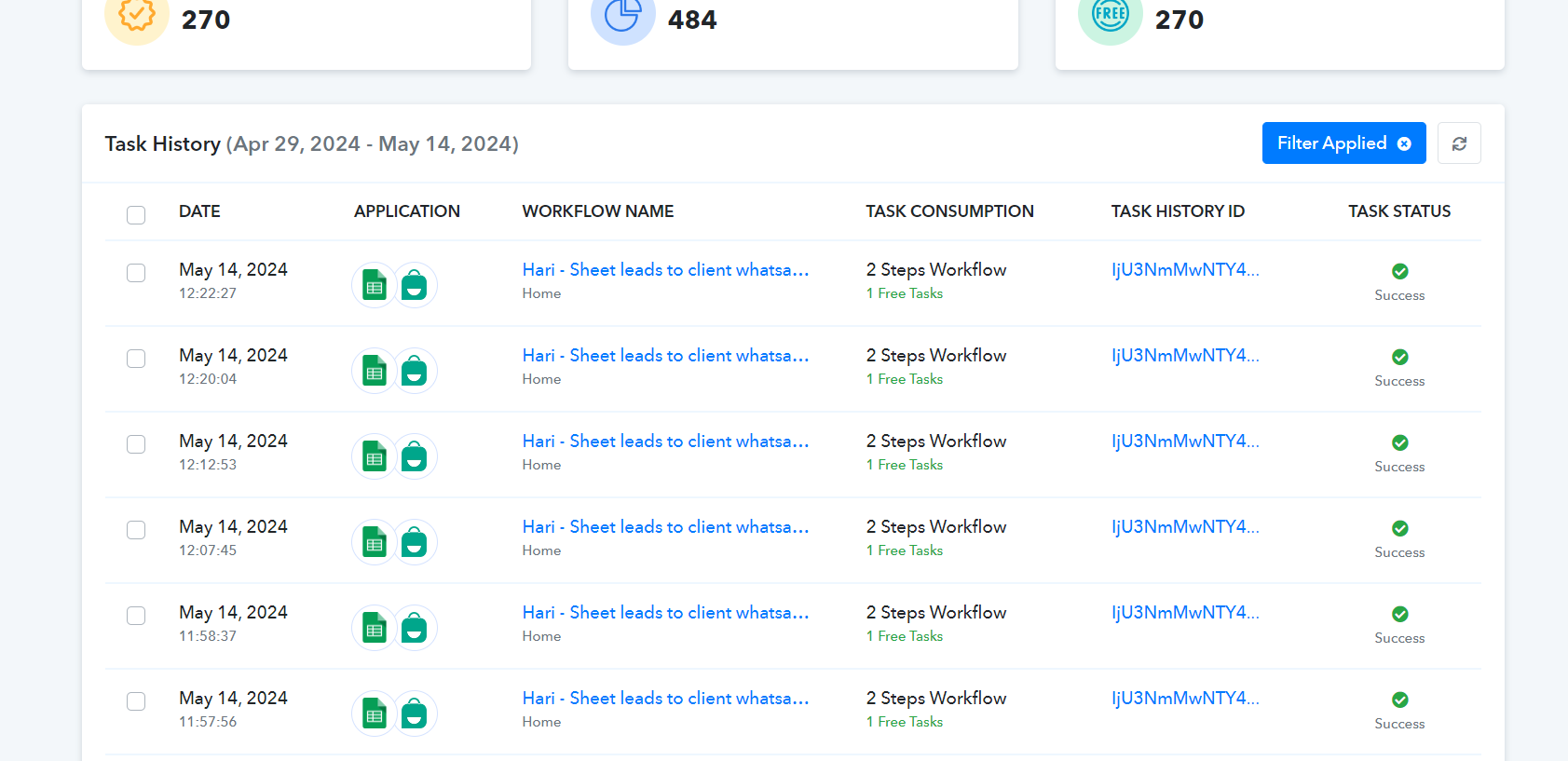

Furthermore, based on the latest history of your workflows, it is evident that the workflow has run as expected.

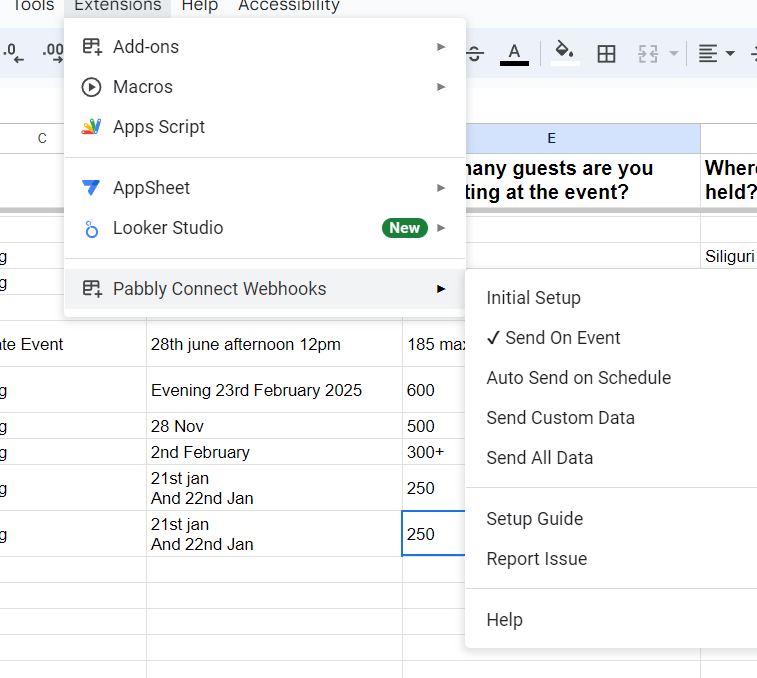

I have enabled send on event. You can check my screenshots
I am manually adding data copy paste in google sheet. when test it, it works fine and even after testing it works for few minutes or few action. Then after some time it doesn't work

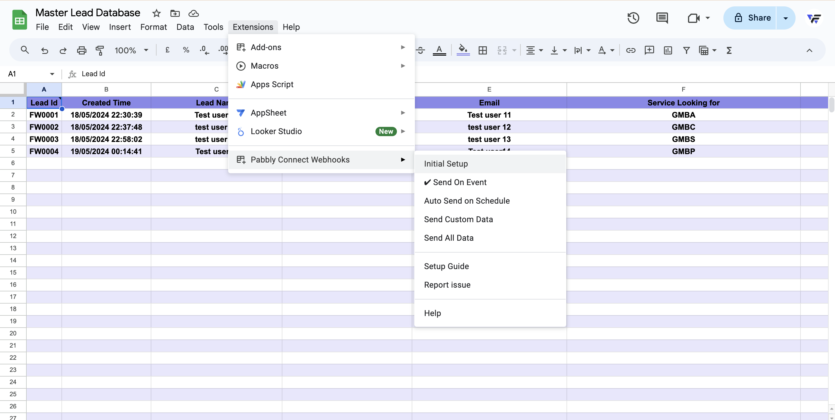

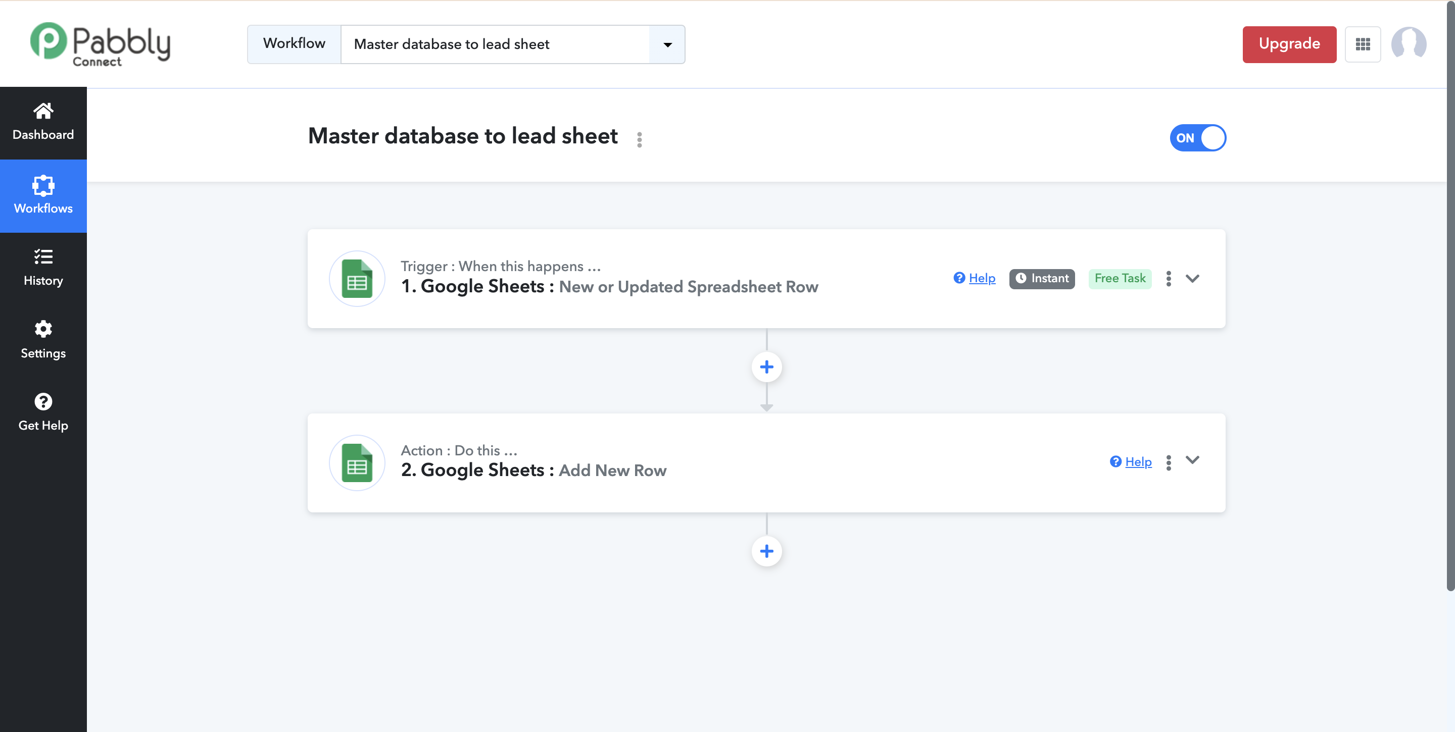

Im also facing same issue i have master lead sheet i have created automation from facebook instent forms and google froms to add leads automatically to my master leads sheet this is working fine
when ever a new row added on my master lead sheet i want to copy that lead to another lead sheet call lead dashboad ( will do some operations here ) This is not working don't know why
In my master lead sheet i have put send on event it's not working
when i have put Send on Schedule its working but data added after 1hour dealy i dont want that i want send data instantly

Hey @Naveensurya

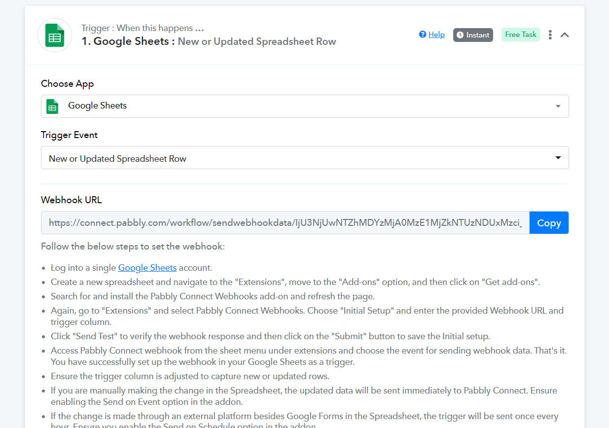

Can you please reconfigure the webhook URL to your Google Sheets once and then try again?
Further, you can only use "Send On Event" when setting up Google Sheets if the data is coming from a Google application or if you manually enter it. If the data is coming from a third-party application, however, you may need to choose "Auto Send On Schedule" which will forward the data in exactly one hour.
Additionally, make sure the data is filled up to your trigger column.
