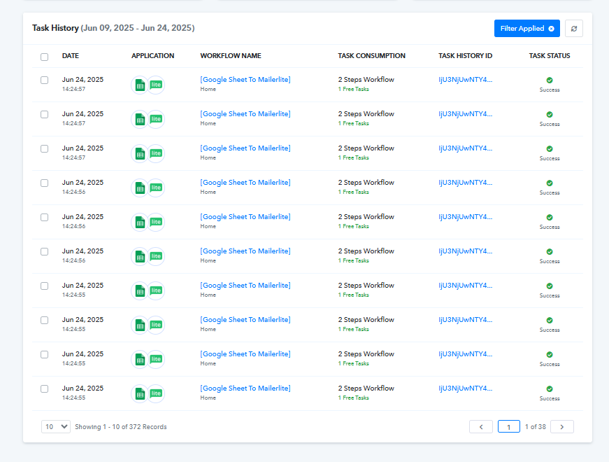

Hello @gfreshmart,
Upon reviewing the workflow history, everything appears to be functioning as expected on our end.
Could you please elaborate on the exact issue you're encountering This will help us better understand the problem and assist you more effectively.

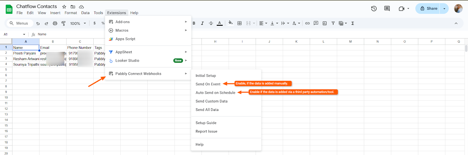

Could you please confirm how the data is being added to your Google Sheet for the MailerLite workflow
To ensure your automation works correctly:
  • If you're manually entering data, please enable ‘Send On Event’.
  • If the data is being added via an API or a third-party application, you’ll need to enable ‘Auto Send on Schedule’.
[IMG width="811px" height="268.603px"]https://lh7-rt.googleusercontent.com/docsz/AD_4nXfHahJLlpnJfSlFIcS8H1O74T0D5H9PSwP7HUz5neYuGXqhywLrA1XO5ce0dH_t-2ZtwpebUdfipf3q0MN4it_x9cfq4WWtiGUShTPkLLOeTIkIa3vRyyyUS0V-jfg7wR_VapIEyQ key=iZr2LZFruDHHYH3j6XeHVA[/IMG]
Note: When using external sources or APIs, the workflow may take up to 1 hour to trigger due to scheduled polling.
