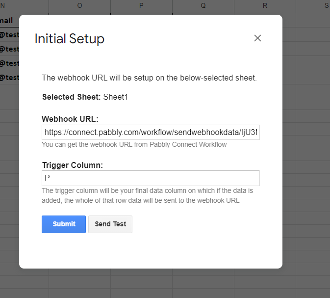

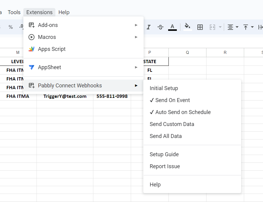

brianlardner — Reply ·
here is my google setup:
I have tried using only "send on event" or "Scheduled" or both.

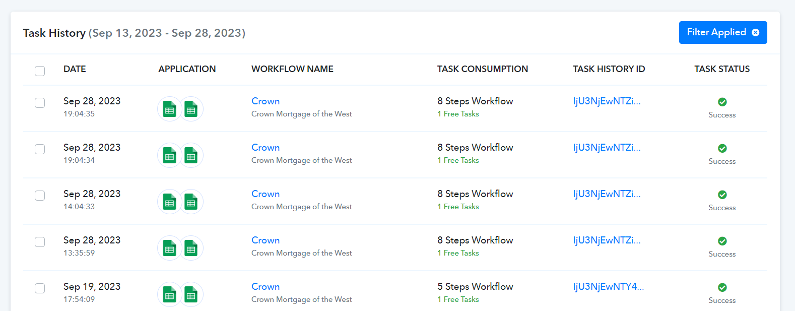

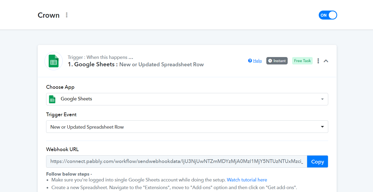

here is my workflow trigger:
Based on your Task History, your workflow appears to be triggering now.

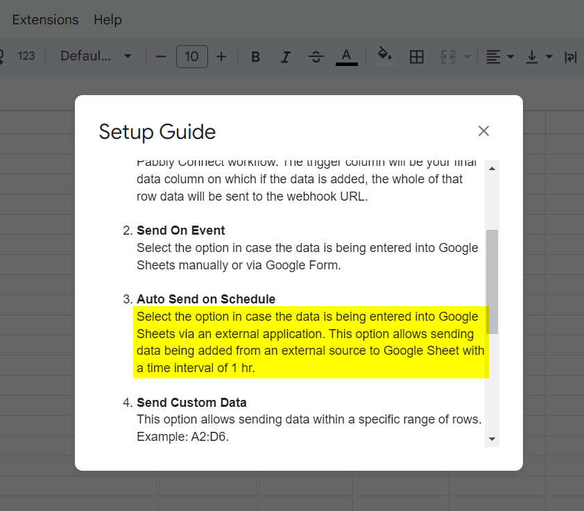

Oh yes, I want to share this thing. Because here you see that the task is triggering one hour later. it was triggering before and as I told you in the middle, it stopped triggering then I again I initiate that set up in Google sheet after that is triggering again. And it is one hour later. So I want to know what is the propagation time or what is the delay of triggering? Thank you.
It depends on how you enter data into your Google Sheets spreadsheet.
  • If the data is entered manually, your workflow will be triggered instantly.
  • If the data is entered through an external application or API, your workflow could take up to 1 hour to be triggered.
