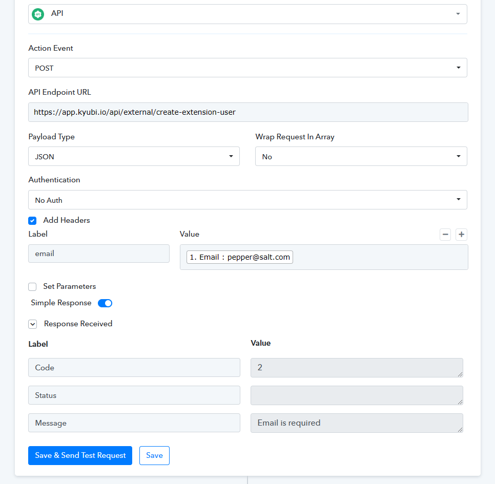

I figured it out by using a different browser, it attaches now, however now the issue is the same with the original document, the information passed from JSON Post isn't giving my other API the correct information

Can you please share the workflow's name and the REST API of the application you have tried in the API by the Pabbly action step?

I have attached a screenshot of the interface

Hey @daffy
Seems like you haven't configured the API by Pabbly action step according to the API, as some of the fields are not mentioned which is required and because of that the action step is not performing.

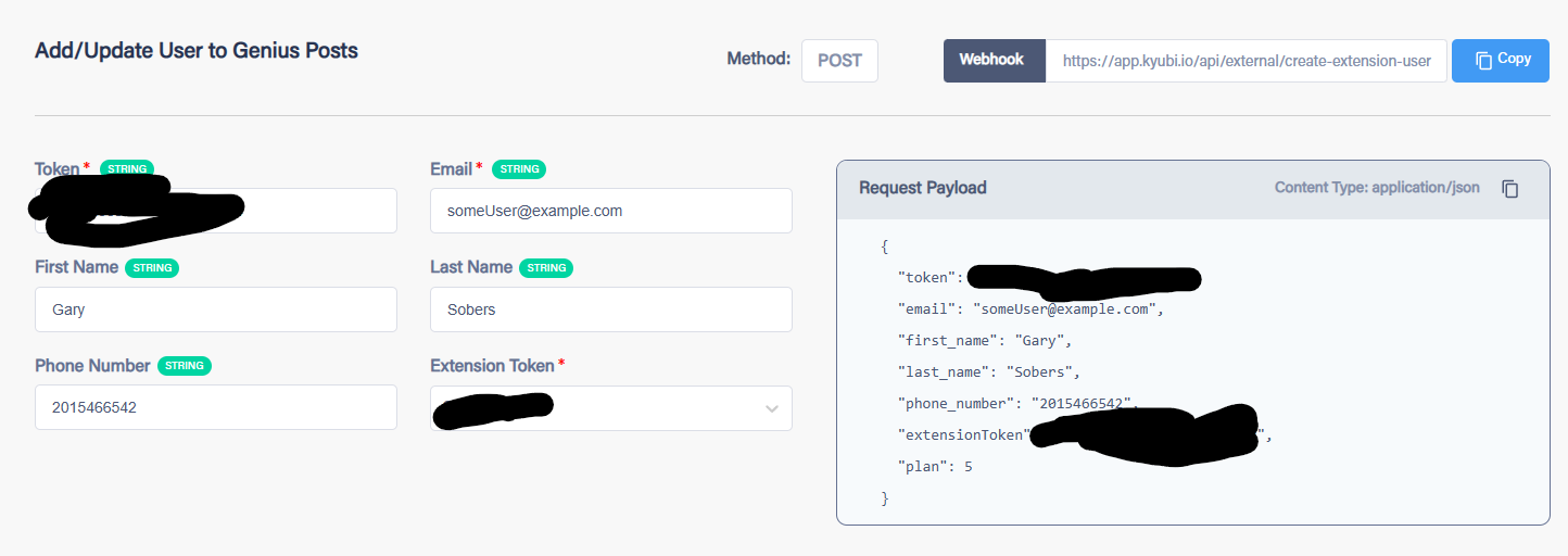

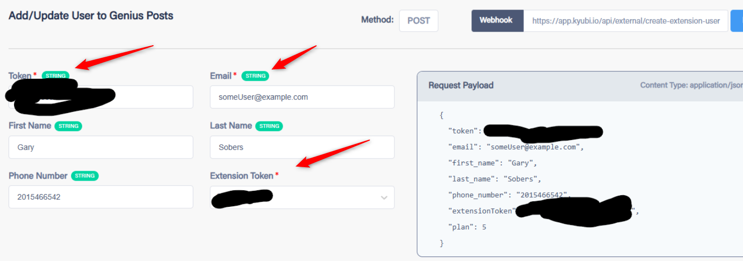

This is a new workflow to test, the only required element is email, the others are not required, the old workflow with a different sheet has been working for months and then just stopped working, which made me make a new workflow to test.
Please check the API request and try again.

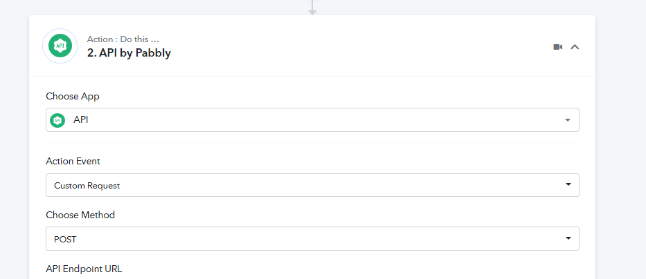

You can use the " Custom Request " in the API by the Pabbly action step.

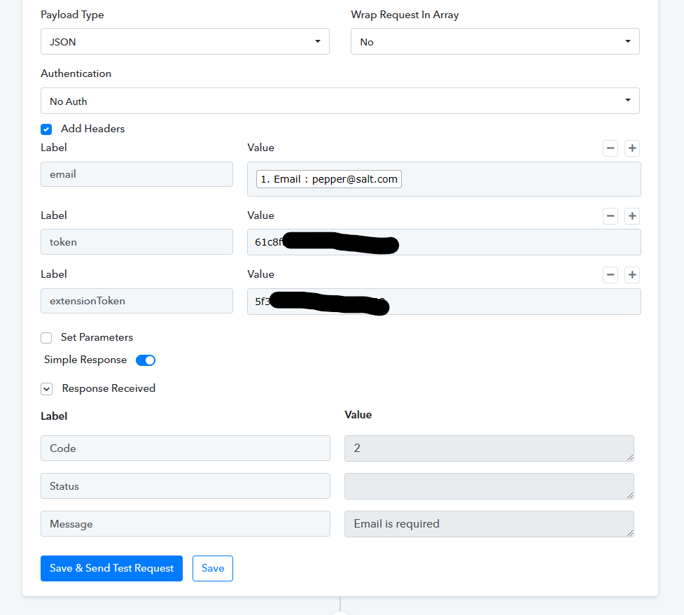

I spoke with the developer and it needs to be sent as parameters, not headers, it was working before, but they are at a loss to why. The method specified in their documentation is JSON POST, what does the "custom request" do or change? Just want to know for future purposes.

Did you watched the video which we have shared in terms to use the API by Pabbly?
Also, share your JSON payload along with the CURL request with us.
