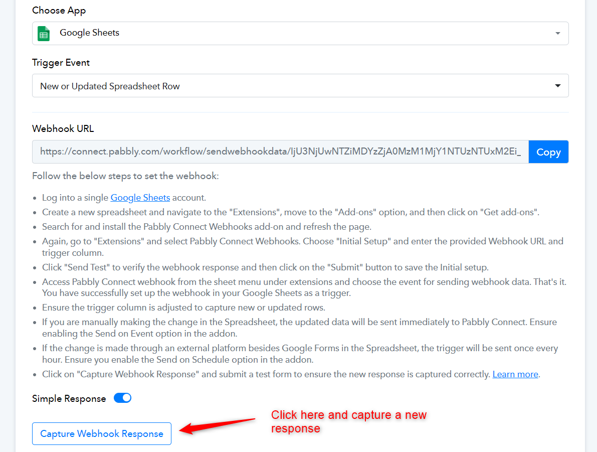

Please click on the 'Capture Webhook Response' button and add the data to your Google Sheets spreadsheet to capture the response in your trigger step. Once you have captured the response in your workflow setup, add data to your spreadsheet once more and see if that triggers your automation.
2024-04-25_10h15_40-png.41369
When entering the data into your Google Sheets, make sure to add the data to your trigger column as well in order to trigger the workflow.
To make automation work, you need to enable 'Send On Event' if you're manually entering data into your Google Sheets. If the data added to your Google Sheets comes from another API or third-party application, you also need to enable 'Auto Send on Schedule'.
Note: If your data is being added from an external source/API, your workflow will take up to 1 hour to get triggered.
