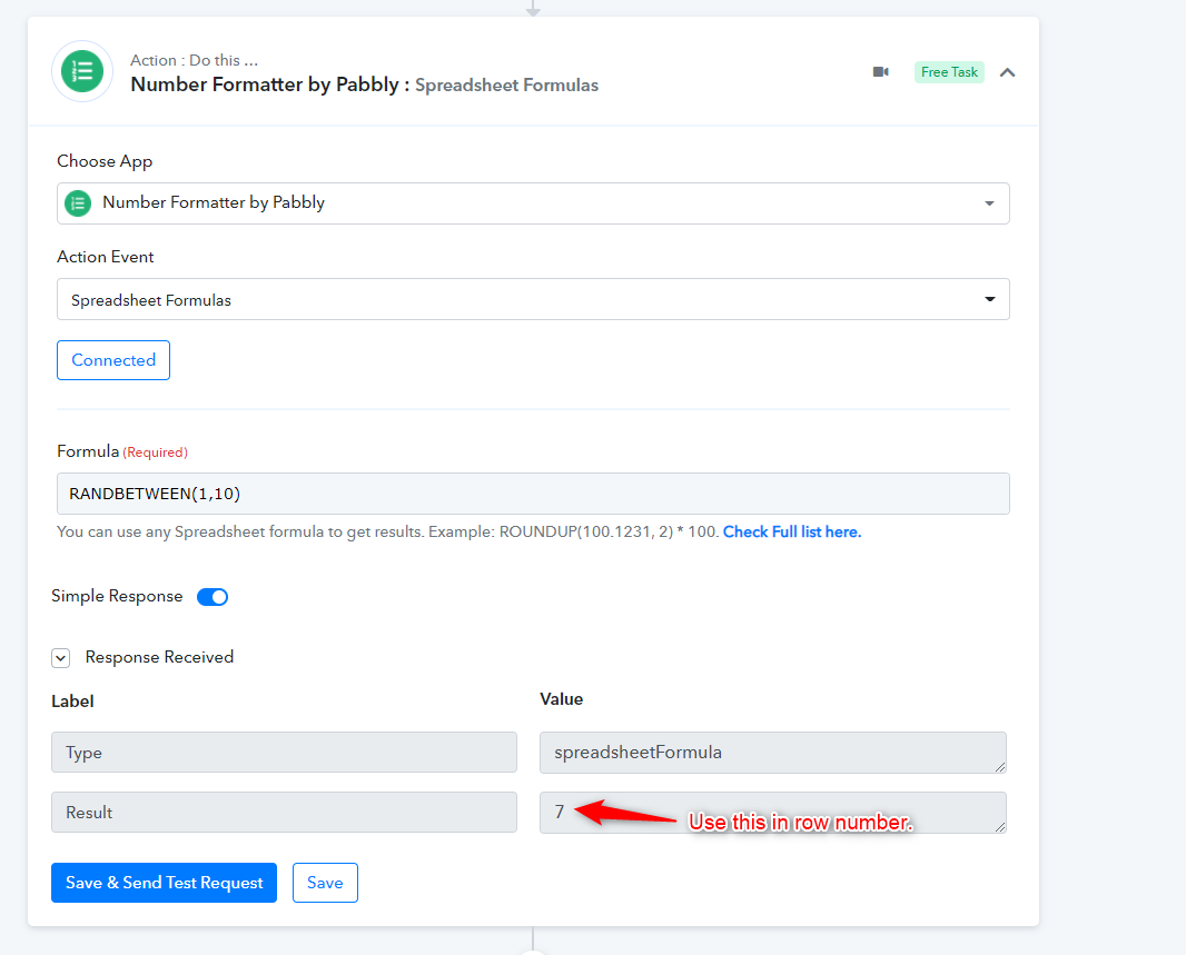

Neeraj Agarwal — Reply ·
If you are using a Get Rows in the Google Sheets to pick the row, you can specify the Row number.
This row can be randomized by using the Spreadsheet function Random module.
