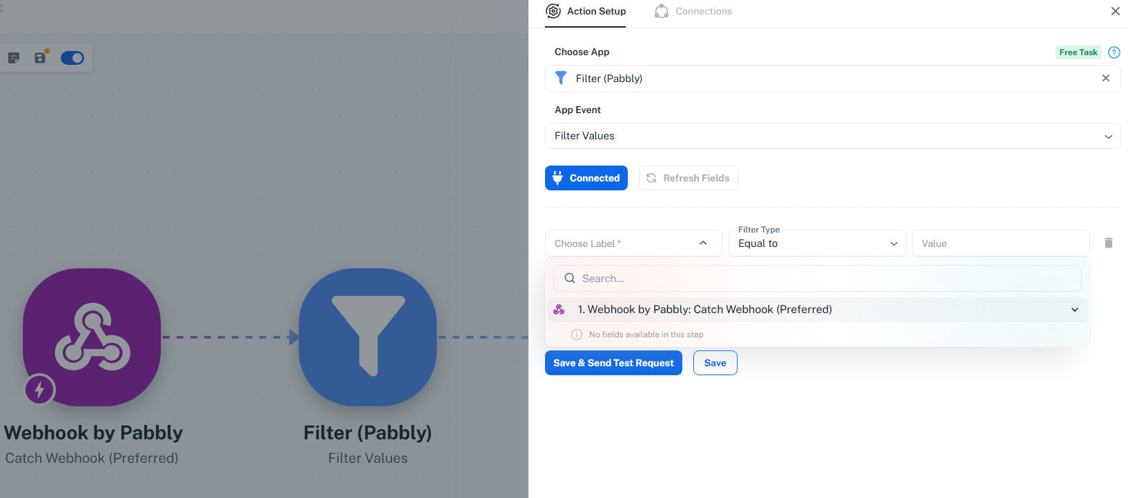

I have a workflow that starts with a Webhook trigger (Catch Webhook), followed by a Filter step to filter out empty or invalid webhook requests before they get processed further.
The problem I'm running into is that when I try to configure the Filter step, the "Choose Label" dropdown shows "No fields available in this step".
My question: Is there a recommended way to prevent empty webhooks from being processed in the workflow? Specifically, how can I set up the filter when no fields are available to select?
Any guidance or workarounds would be greatly appreciated. Thanks in advance!
Hi @sven-bo,
You need to capture a response in your trigger step first. Then, use the Exist filter condition to ensure that the next steps execute only when the data exists in the webhook response.
