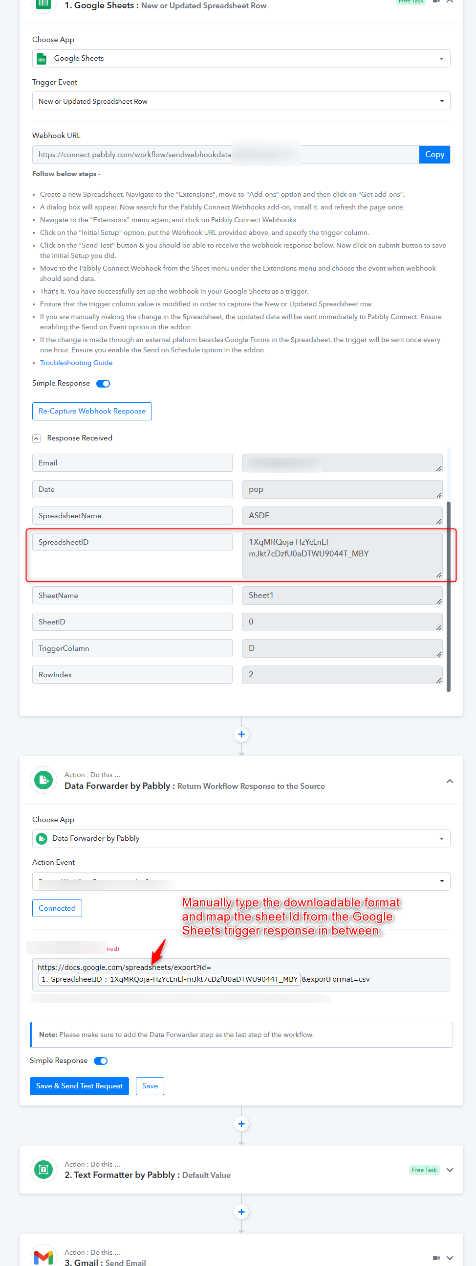

I used a trigger (Webhook) to send the data to create the spreadsheets, then to send the spreadsheet link to the source, I used Data forwarder.
Now I'd like the link to automatically download when you click it, without using the google drive. Anyone can help?
Hey @Glayndy
Please check out the following screenshot for your above concern. Kindly try this at your end and let us know if that helps you out.
You can also pass the Sheet Id from the Google Sheets action steps' response as well.
