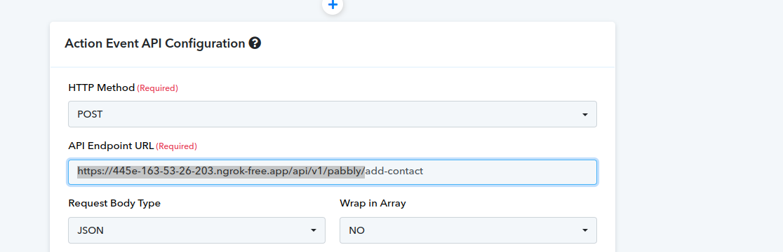

here in the below picture the highlighted url is used in every action route. Only /add-contact part will be changed . Then how to keep common url in one place and access using dynamic variable . so that if i change route in one place then it will be reflected everywhere.

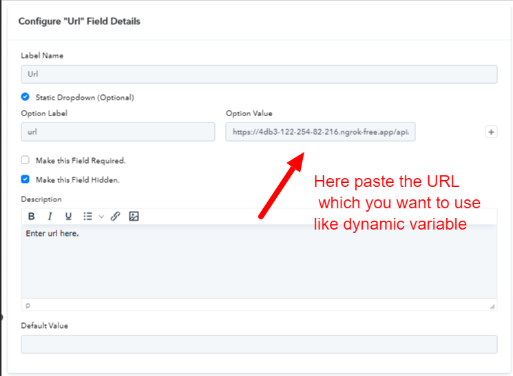

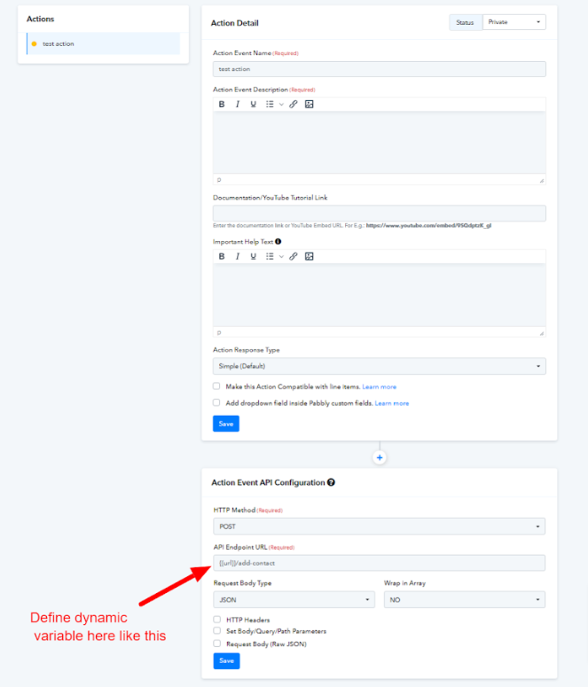

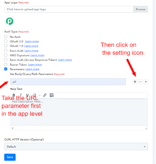

As discussed during the meeting with Ashish and Nivesh, you can set up this by following the below procedure:
Go to Action section and configure it like this
