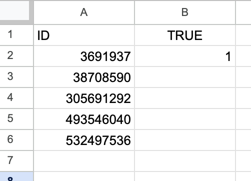

I figured a way to get the data into google sheets and then select the correct cell with the data I need. Now, the problem is that Iterator sends the data for each loop it runs. I reviewed the following post however I'm still not clear on the final explanation and how to only have the data sent one time in the next steps of the flow instead of n of times.
greco26
FYI, I have hit dead ends all day trying to figure out how to get this working. I moved away from Python and Java because I dont know them and I know I should be able to get this to work without any coding.
The name of the flow is Simple-STRAT Workflow and the Route is IBKR New. I run test data to the flow from Test Order flow. The main record the flow uses is the Symbol (stock market ticker). I have 2 iterators running back to back because I have a nested array which I also need to iterate. I am able to iterate through the arrays and push the data from all the arrays to sheets.
Then the next step the process is im doing a sheets lookup from Pabbly, finding the row that is 'True' and returning the ID in that row (3691937 in the example below) then inserting that into the next step which is to send a Post request. This is where things break for me. 1) 5 Post requests are being sent instead of just 1. Im sure it's because of my iterator setups so im hoping a filter or something can help me with that. 2) the row value record im pulling from sheets is blank when it comes back to Papply just like the Python script was returning.
The odd thing is that when I send a test record for the Post request from the Pabby flow, it works. When I send live data, the record coming from sheets is blank. Im working if it has something to do with the iterator still running while its pulling the record.
Any help would be super!!
