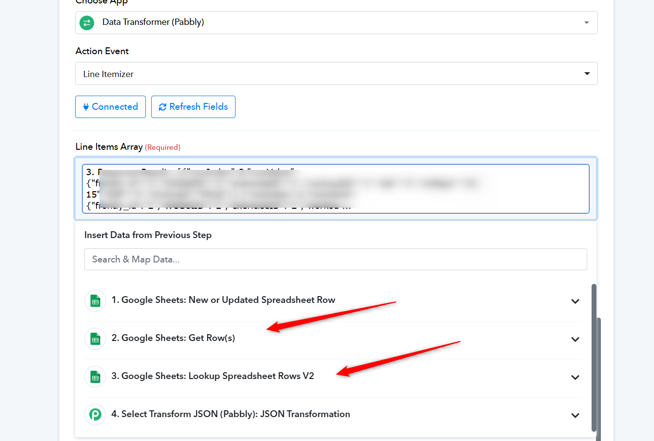

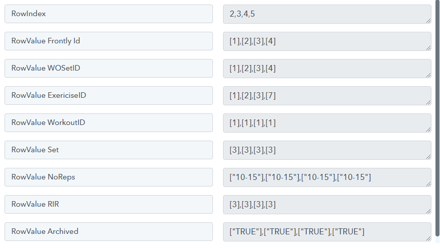

Then, Im using Data Transformer (Line Itemizing) to and return this result.

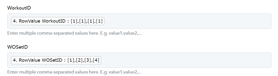

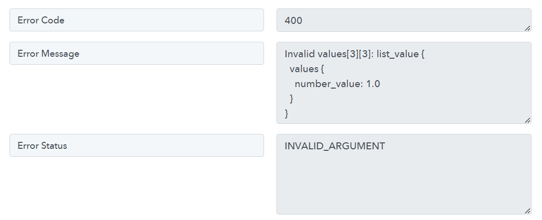

Lastly when I want to update another sheet using "Google Sheets - Add Multiple Rows". It return this error.

Is it because of the result return in list format, and couldn't be updated in Google Sheet? Any solution on this?

To input multiple comma-separated values into Google Sheets in a single action, you can directly pass the data from your Lookup Spreadsheet response or from the Get Rows action, wherever you wish to transfer the data, rather than using a JSON Transformation action step.
For the reference on the same, please check the following video lesson -

Hi Supreme,

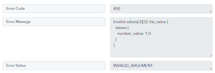

Thanks for the video provided, but the result return in list form. This is the error code that shown when using "Google Sheets -> Add Multiple Rows".
Sample Data:
Error:

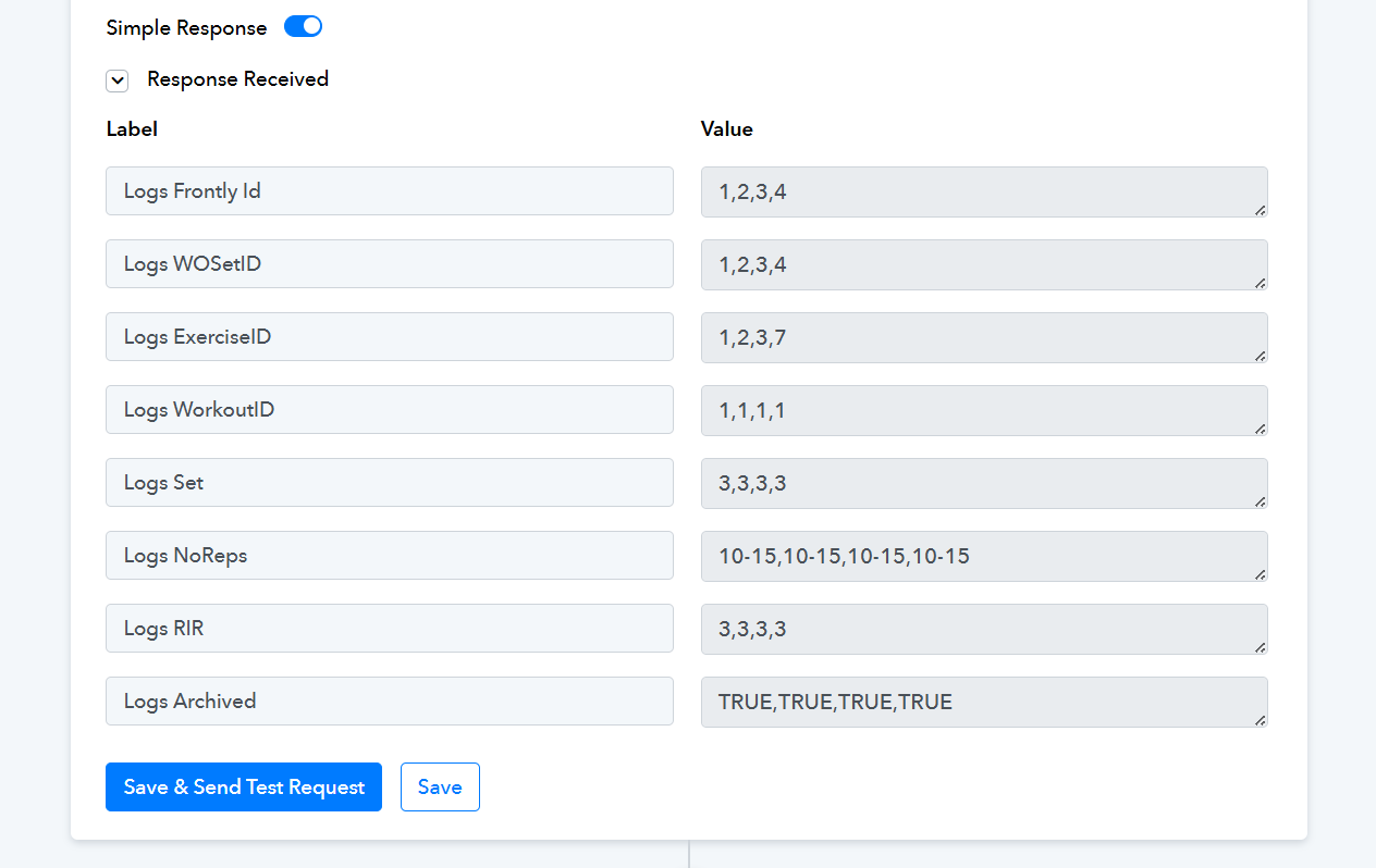

Please check the fourth step of the Python guide to obtain the line itemizer items' values in a comma-separated manner.
I hope this will work now please map the values accordingly.
